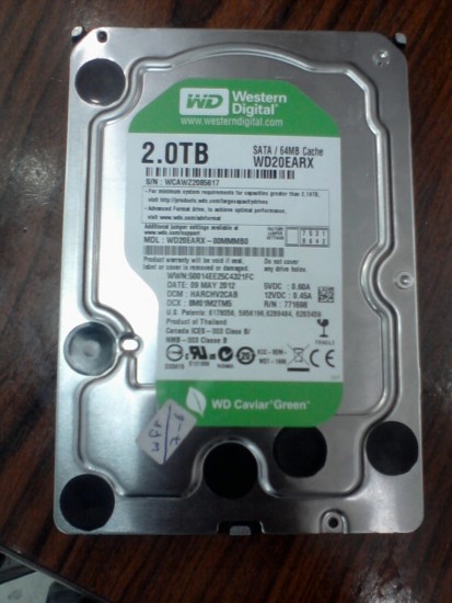

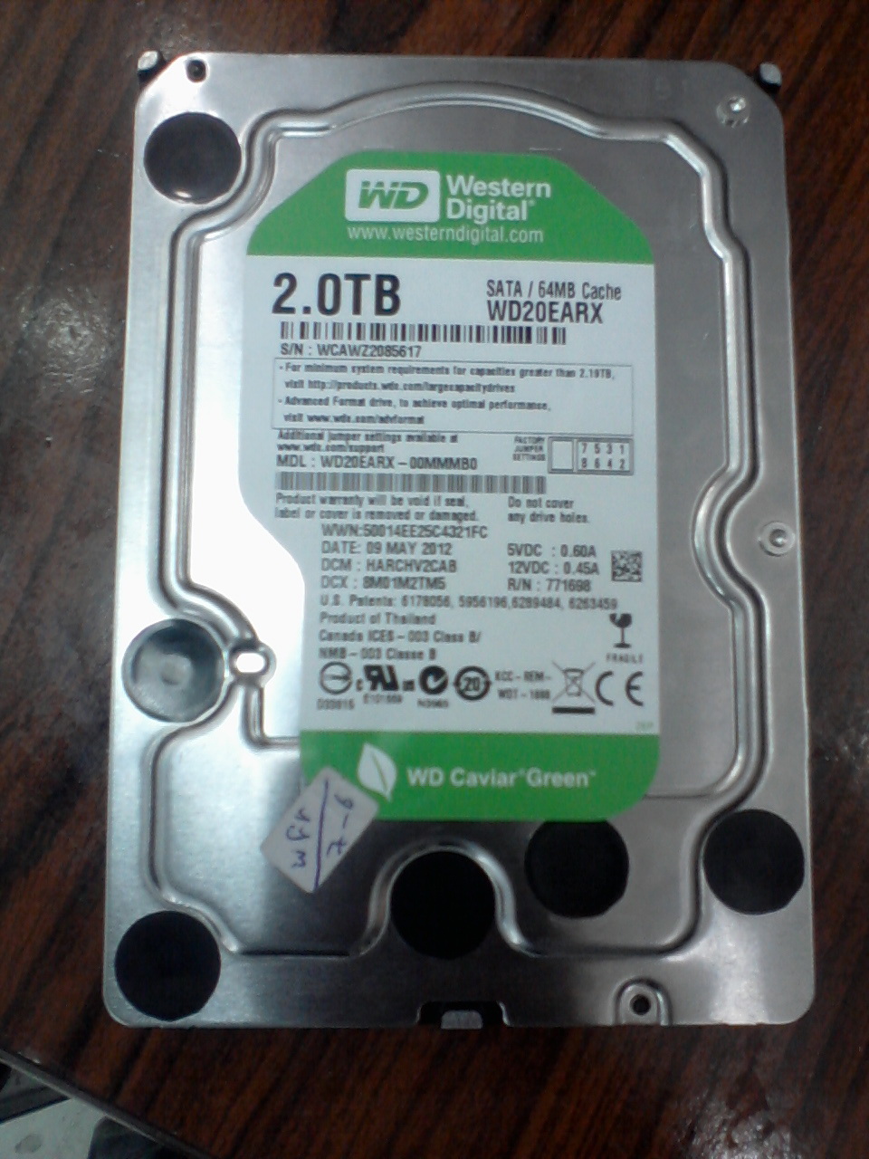

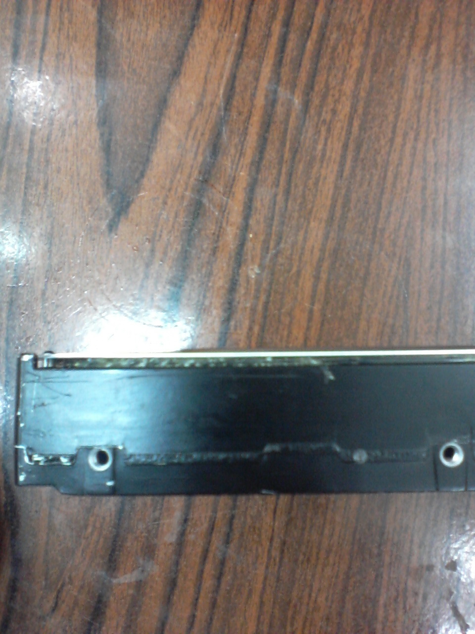

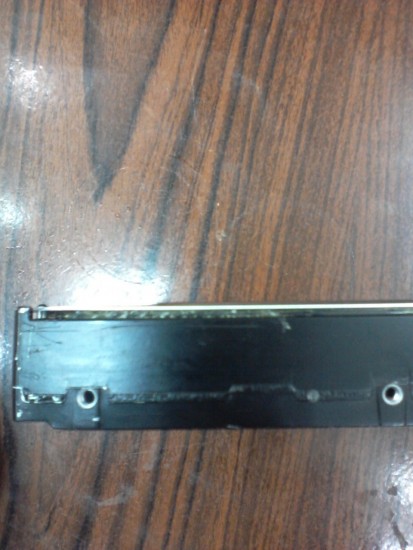

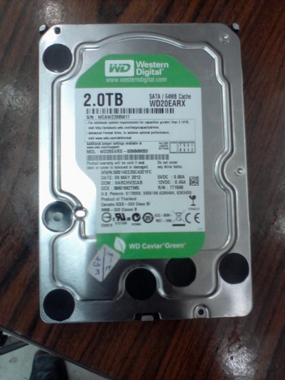

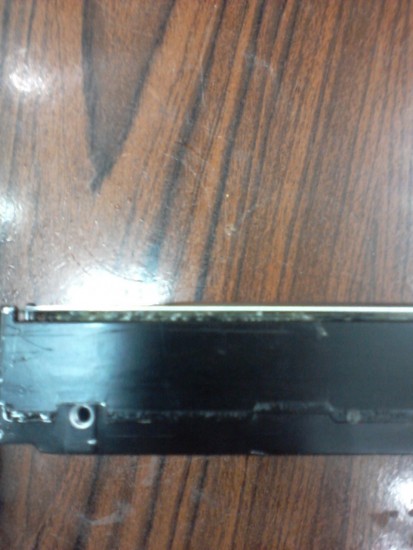

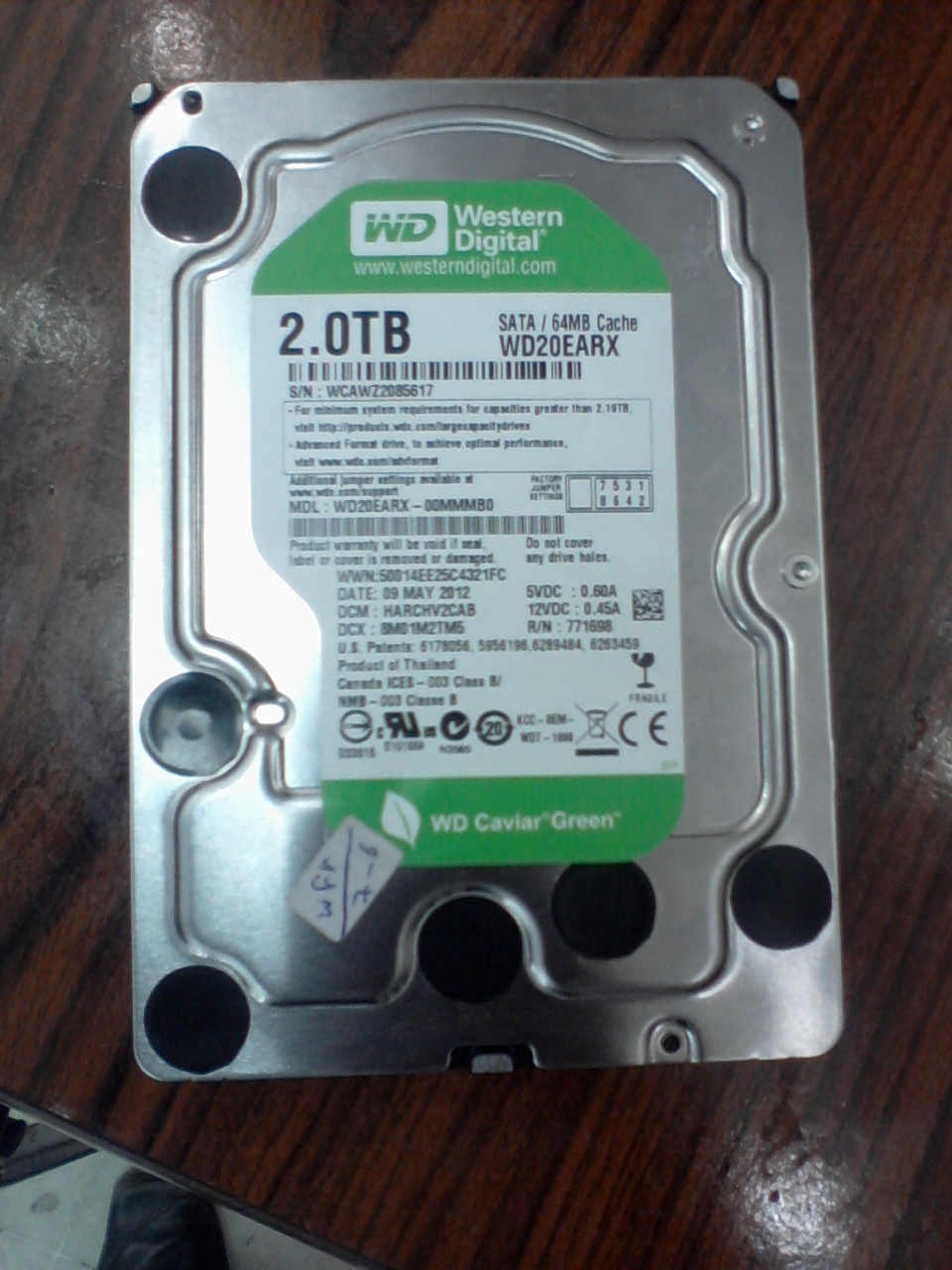

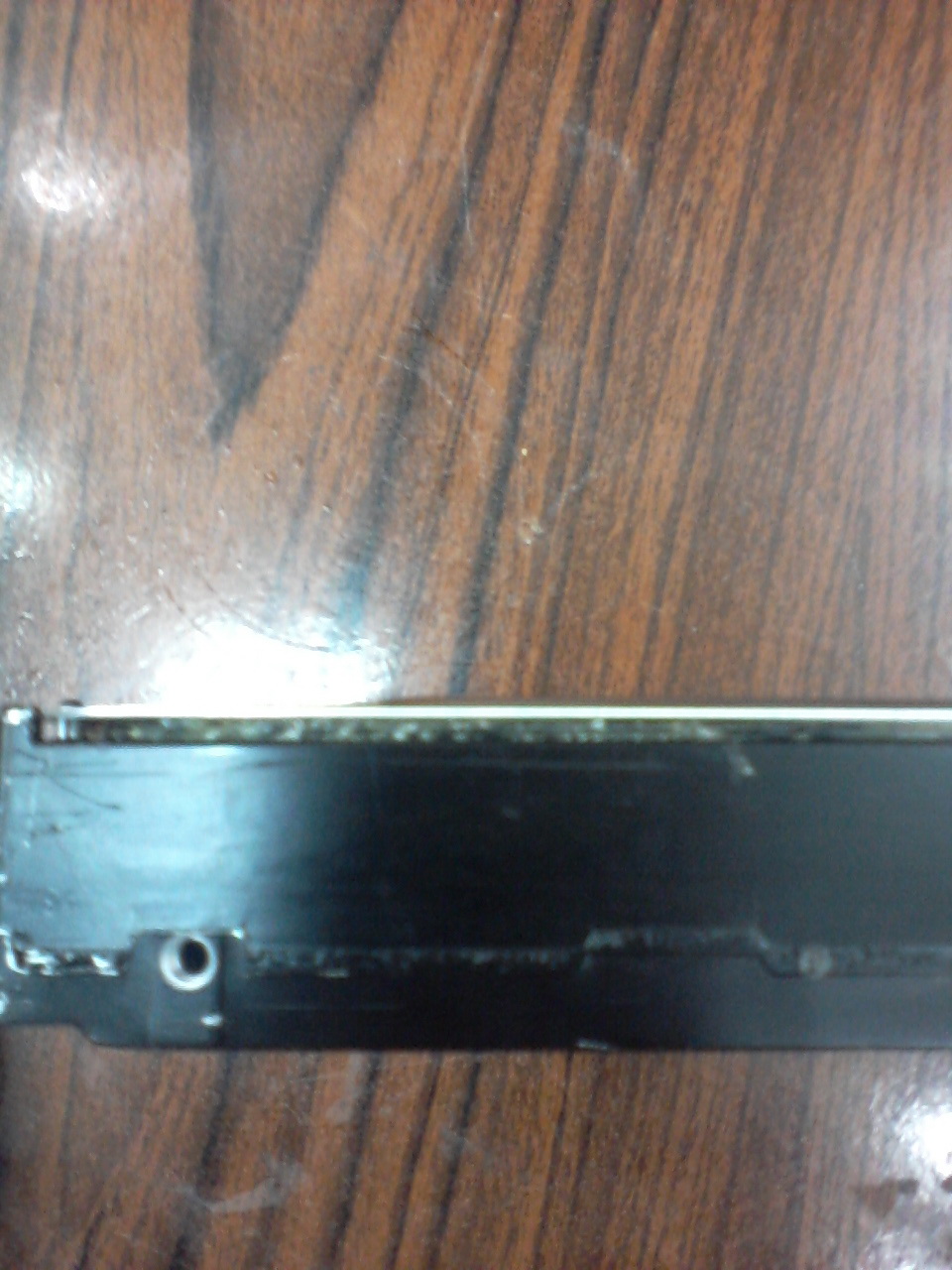

A customer came to me to retrieve his data from this drive. He said that he just bought it just a week ago and it's now not recognized.
The problem related to a very bad material led to a lot of dust on the heads and the surface.
File comment: Date : 09 May 2012

Does the drive work as of now?
 Post subject: Re: Very bad material WD.
PostPosted: June 20th, 2012, 14:55
Posts: 1729
After replacing 8 heads from donor to patient, it's imaging now. :)

I remember many years ago (15 years ago?), some WD drives of that era had a similar problem, with flakes from the black coating material falling onto the platters. :( Therefore this is not a new type of problem for WD...
PostPosted: June 20th, 2012, 15:31
Posts: 1729
Vulcan wrote:
I remember many years ago (15 years ago?), some WD drives of that era had a similar problem, with flakes from the black coating material falling onto the platters. Therefore this is not a new type of problem for WD...
Totally agree with you sir. But those days WDs are failing quickly than usual.
- Date of manufacture : 09 May 2012 and the drive has used for only ONE week then failed, it's weird. :)
