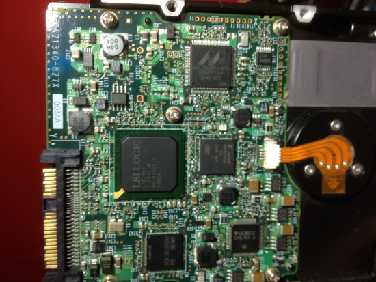

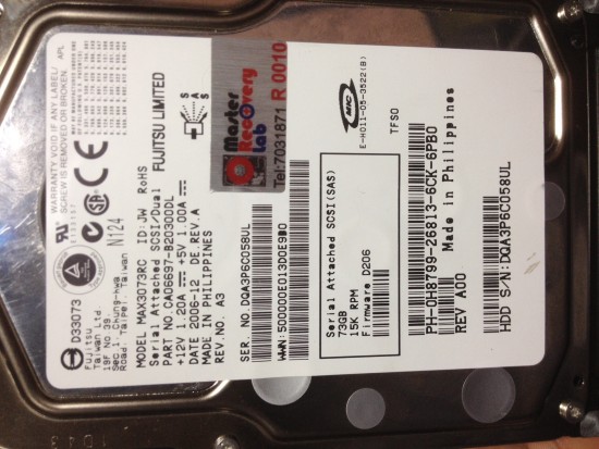

 Post subject: Not drive detected Fujitsu 73 GB SAS
PostPosted: June 21st, 2012, 10:05
Joined: February 17th, 2009, 13:01
Posts: 111
Location: Bogotá, D.C.
hard drive will not start, not sound, nothing
please see the pics.

 Post subject: Re: Not drive detected Fujitsu 73 GB SAS
PostPosted: June 21st, 2012, 10:32
Posts: 1060
Check pcb
PostPosted: June 21st, 2012, 12:15
Posts: 111
PCB not visible problem...
PostPosted: June 22nd, 2012, 5:42
Posts: 3551
The pcb can malfunction without visible problem.
If the drive does not spin up, start with the pcb.
PostPosted: June 22nd, 2012, 8:53
Posts: 3598
Location: Chicago
Have you connected it to SAS controller?
SAS drive will only spin up if connected to SAS controller
