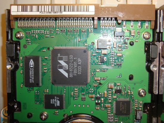

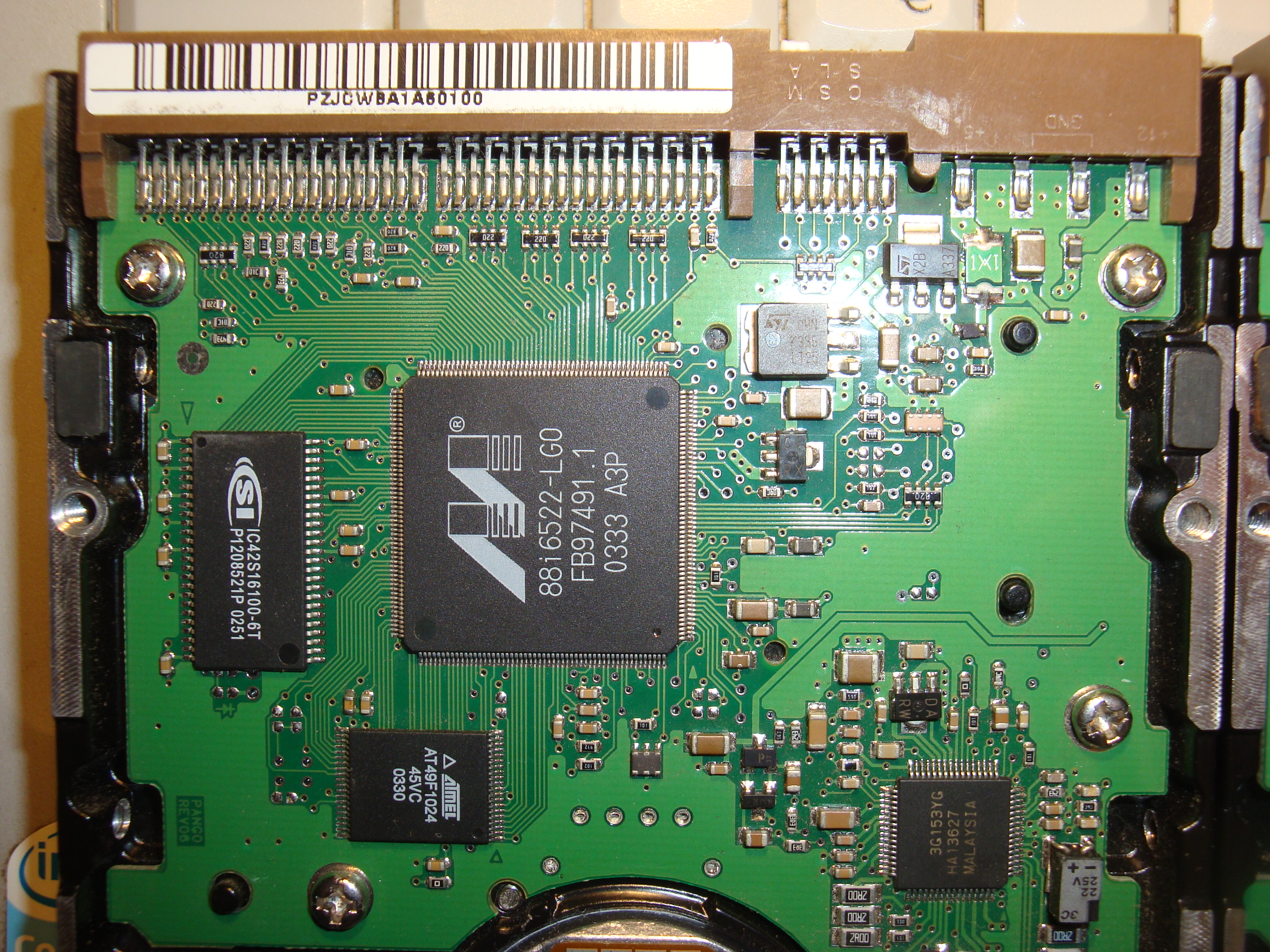

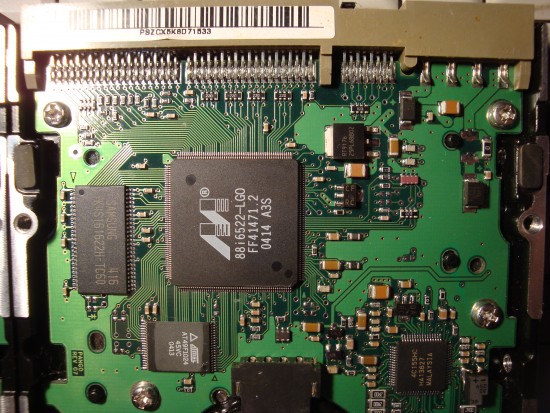

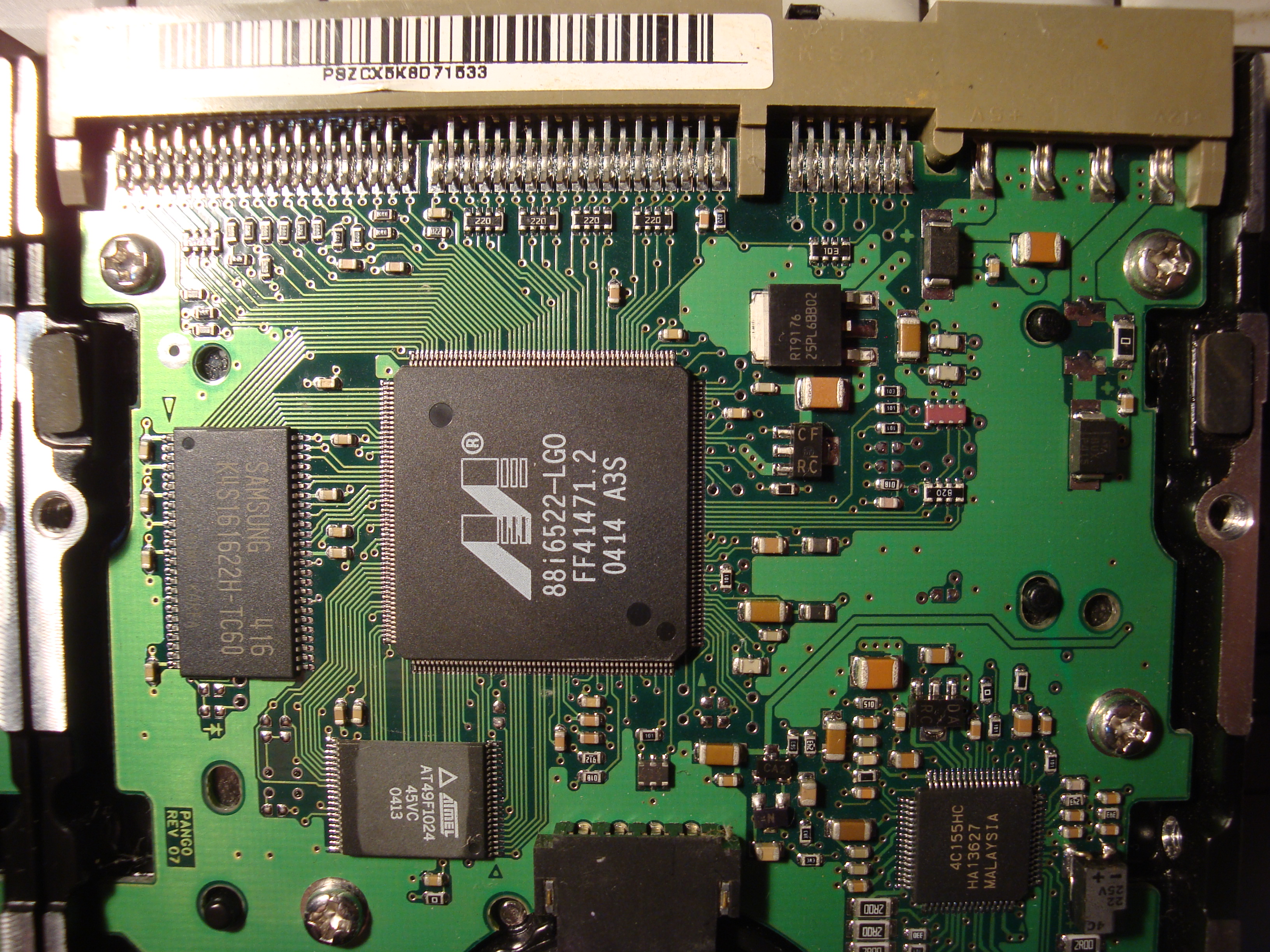

I have two similar samsung hd,they don“t work.I need Help identifying vts diodes.Sorry for my English.Thank you

just follow the power in with a tester and see where it stops
 Post subject: Re: Help identifying vts diode
PostPosted: June 22nd, 2012, 2:51
On the bottom pic, looks like someone has already removed one.
The other is in top right corner. Black component with a "+" next to it.

Disc in bottop pic is working again.Now I need help with the other.
