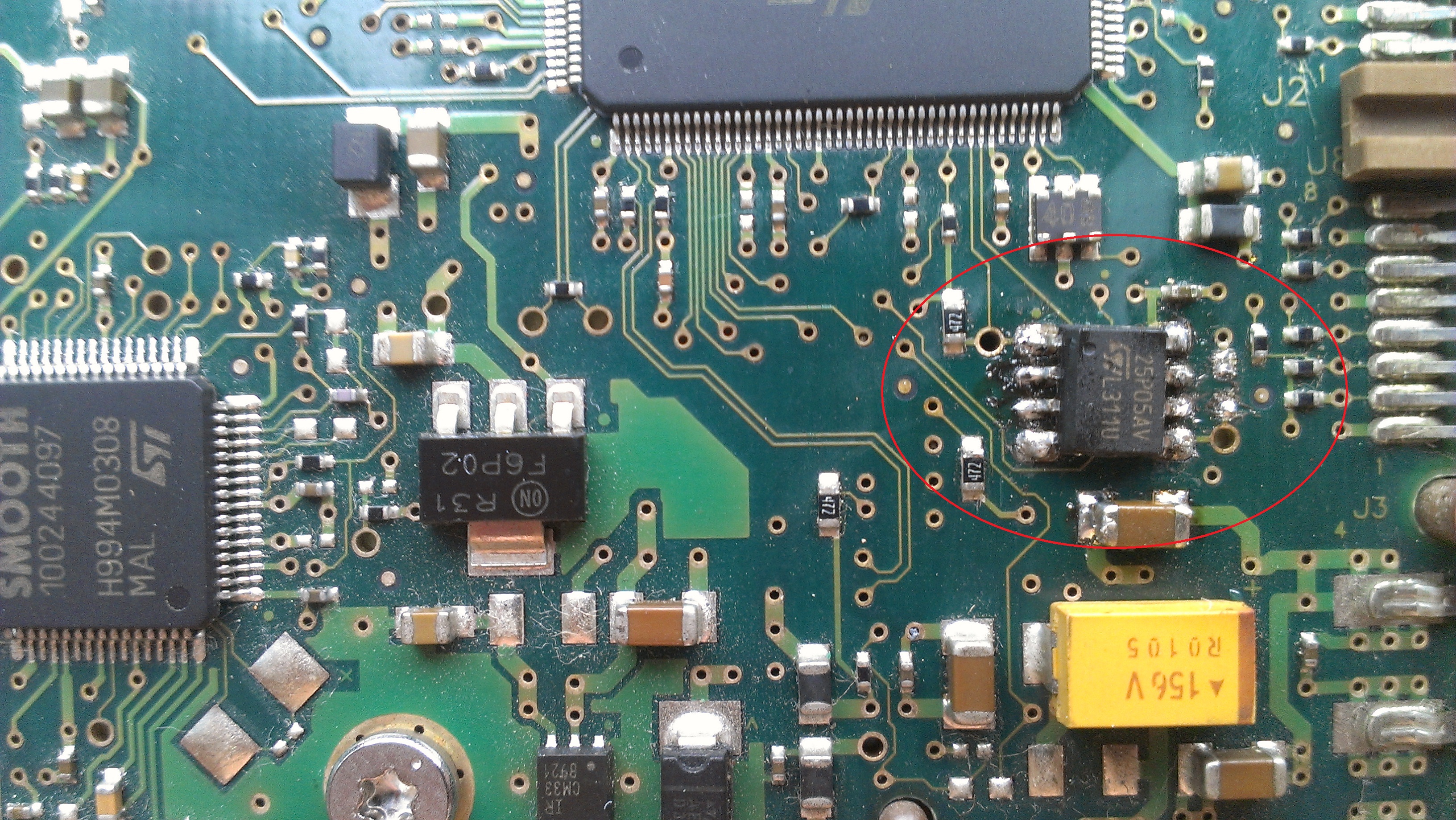

the seller where I bought the board said he tested it and it was working before sent to me... Maybe I can try to remove the BIOS chip and re solder it...
attached I sent a photo of the soldered BIOS

That's a poor/messy solder job. How sure are you that the ROM swap didn't damage something?
The seller said it was working before he sent it to you. Was that before the ROM was swapped? I would put my money on the soldering process as the culprit here.
Just connected the HDD directly into the motherboard, as before I was connecting it to my external adapter... Now it worked with the swapped "new board". so its the external enclosure that its faulty then.
