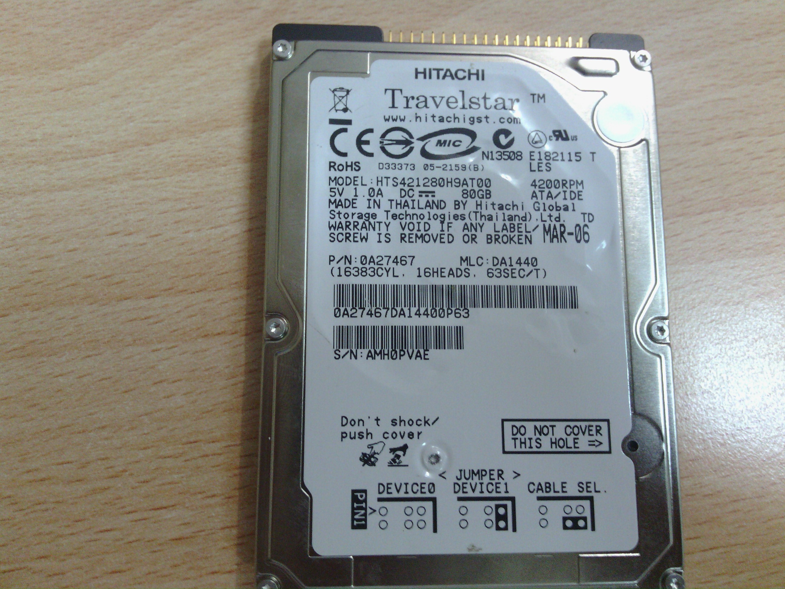

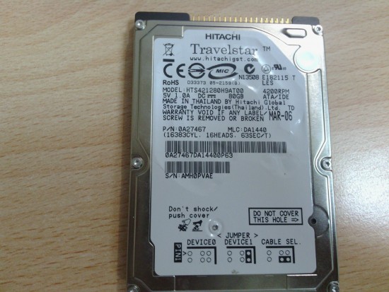

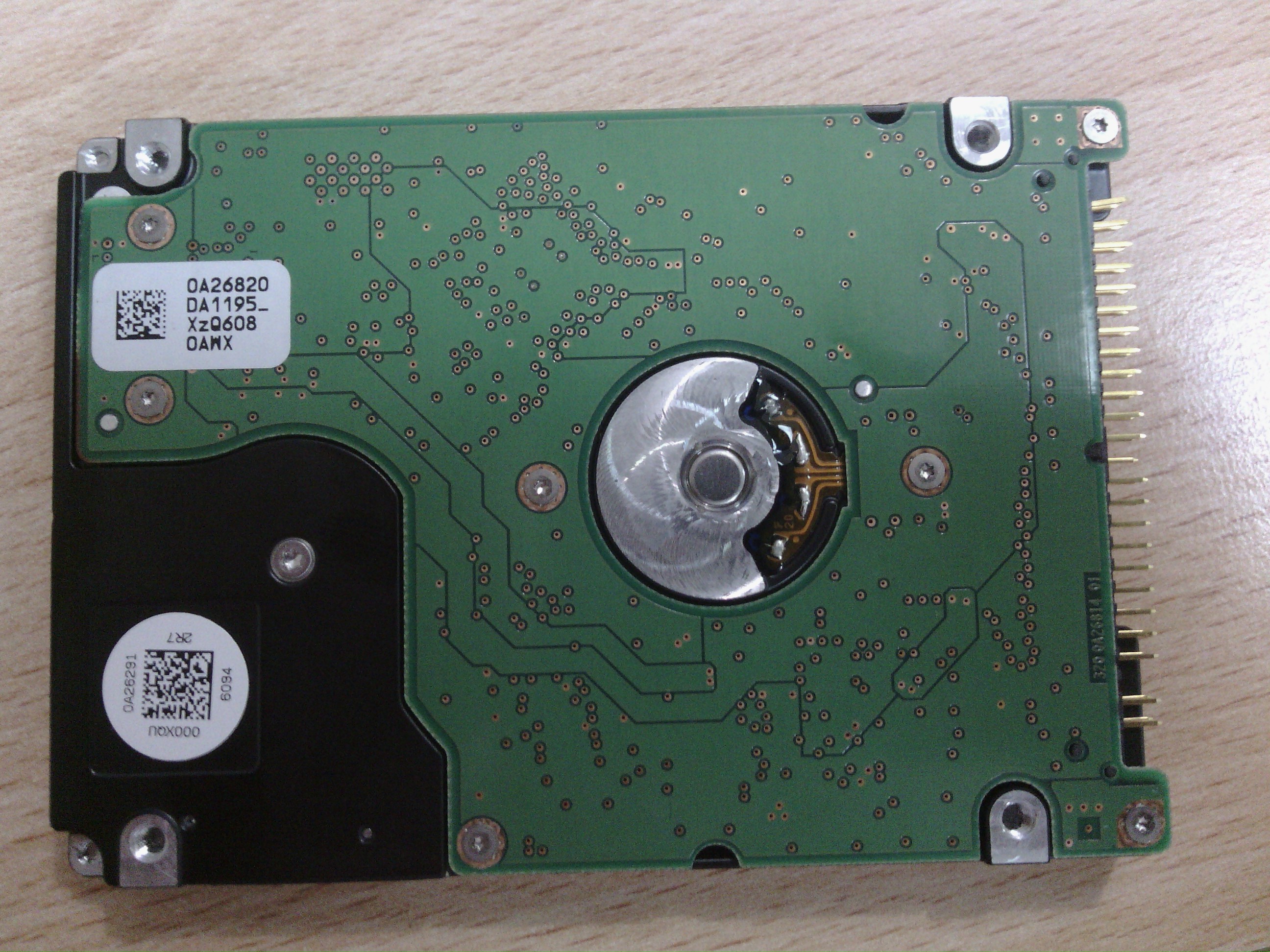

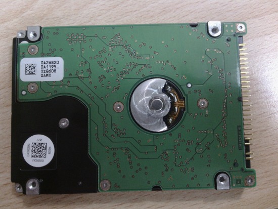

blackpac wrote:
What can be done?
Write the EXACT model of your drive or put a picture of it as a first step. :D
 Post subject: Re: Hitachi PCB swap - Damaged NVRAM
PostPosted: June 29th, 2012, 7:28
Joined: January 11th, 2012, 18:24
Posts: 6
Location: London
Good Point :-)
HTS421280H9AT00
P/N - 0A27467
MLC - DA1140
MAR-06
PostPosted: June 29th, 2012, 7:57
Who opened it, any why? :shock:
Data recovery "specialist" that did't know what to do with it :-(
