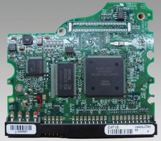

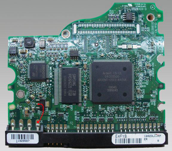

Giys, the HDD is revived from it's IT hell. "Extra measures" and overnight zen revealed that there was no +5V on the main power transistor Q500, where it has to be by any mean. +5V is coming to PCB, coming to SMOOTH (for -3.3 + -5v generators) AND to main current "switch" Q500 (being driven by SMOOTH). But +5v was not present on Q500, while SMOOTH tries to open the transistor to power on the rest of the PCB. It just opens for nothing, as there was no VCC on the other leg of Q500.
A 5mm-long airwire from the MOLEX +5v to the middle leg of Q500 was fixed the problem (see attached). +3.3v\-5v popped up immediately, PCB boots successfully, and the whole HDD is back to me as before. Now I can see the data, and startedthe backup process. Voila! :roll:
I bet that the copper wire is degraded somewhere in the layers of the PCB due to its age (once again, the HDD is over 11years old and used 24/7). Who knows...and who cares, once the data is accessible and being copied to the safer location now.
