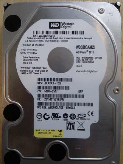

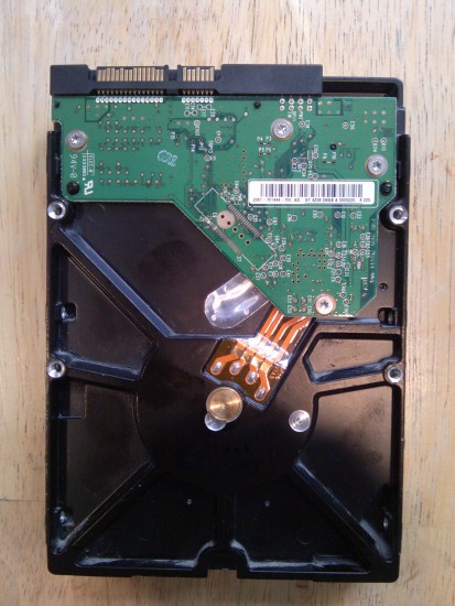

I know this is a common post, but I have read through most of them and still would greatly appreciate any assistance from an experienced person out there:)
I am trying to help out my father who's hard drive went bad and of course he did not have a back up. It contains everything from pictures of my late grandparents (my dad's parents), my late aunt (my dad's sister), and most of my childhood, not to mention all of his tax/financial data.
I know I will probably need to swap out the PWB with one that has identical firmware, but I have not found one yet. I am not sure if that will do it as the heads might be broken (i hear a little clicking)
PROBLEM:
- Drive does not register in bios
- Drive will not boot
- I can here the drive spinning, but I do here a little bit of clicking
DRIVE INFO:
Western Digital (of course)
MDL: WD5000AAKS - 65YGA0
DATE: 06 DEC 2007
DCM: HARNHT2MAB
WWN: 50014EE200CFF302
GPN: XXXXXX - PX2
P/N: 5188 - 2517
CT: 2815001VZVFEMV
WD P/N: WD5000AAKS-65YGA0
PWB INFO:
Label: 2061-701444-700 AD XT4Z08CNGS A 0005220 8 225
Board: PWB 2060-701444-004 REV A

Dorsia, your drive may be affected by a common "head mimic" fault. This is caused by a bad Marvell 88i6745-TFJ1 chip on the PCB.
The easiest thing you could try is to gently clean any oxidisation from the preamp contacts (J1 on component side) using a soft white pencil eraser. If this doesn't work, then contact the following PCB supplier (member15871.html):
http://www.donordrives.com/
porthas is a valued member of this forum. He offers a free "PCB adaptation" service. This is required because each PCB contains unique, drive specific information. This information must be transferred to your donor PCB.
 Post subject: Re: Western Digital HD (WD5000AAKS - 65YGA0) - Data Recovery
PostPosted: May 26th, 2012, 2:23
Dorsia, your drive may be affected by a common "head mimic" fault. This is caused by a bad Marvell .
Dorsia, it most likely be not true in this case. The problem is elsewhere. DON'T WASTE MONEY on a PCB swap that won't solve the problem UNLESS YOU ARE 10000000% SURE and DON'T EXPOSE THE DRIVE to other risks i.e. sending it back and forth as the risk is total loss of your data.
Get the drive analyzed by a pro with pro tools, it takes little time and it is perfectly safe AT THE MOMENT. If you really want 100000% professional referrals in your area just ask.
