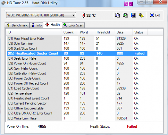

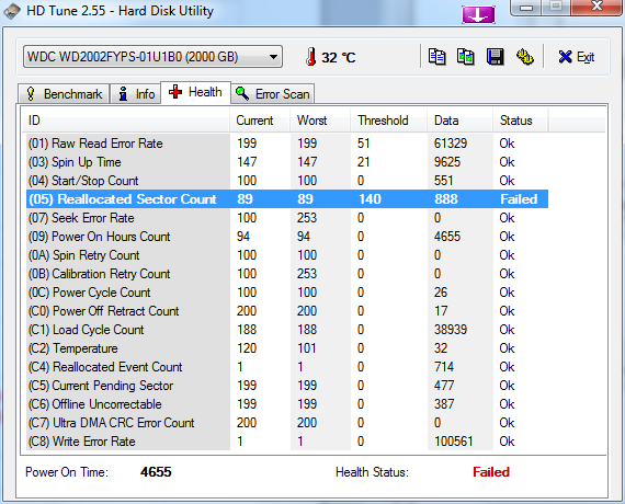

In the middle of a rebuilding process, one of the drives in my RAID 6 array decided to break down and take the entire array with it. The drive is encountering multiple SMART errors. Please see pictures. Any ideas on how to remedy it? The drive is a Western Digital RE4-GP 2GB 2002FYPS drive with firmware 04.05G05
results.rtf [4.21 KiB]
Downloaded 575 times

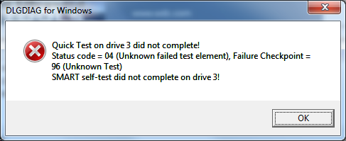

Sorry guys, I should have been more clear in my original post. I did not have all the information back then. Actually, I still don't have all the information, but I have a much better picture.
Here's my setup:
OS: Windows Server 2008 R2
HDD: Western Digital 2002FYPS
Raid Controller: 3ware 9650SE 24ML
Array: RAID 6 (14 HDDs)
Here are the error logs from my RAID controller.
https://dl.dropbox.com/u/10737837/lsi.Win2k8R2.HOMESERVER.072412.10704.zip
https://dl.dropbox.com/u/10737837/errorlog_0.dat
A few nights ago, the array reported that there was a problem with two of the drives (drives 0 and 5). I'm not sure what the exact error was. I was in the middle of a relatively large transfer (~50GB). All of a sudden, my system froze for about 2 hours, and after that, I managed to do a normal restart. The controller does this sometimes - kicks out two drives randomly and then proceeds to rebuild them.
When the system started, I checked 3DM2 (the raid controller software). It said that the array was degraded and proceeded to automatically rebuild the array. Everything was fine until the rebuild process hit 14%. Then I received several errors concerning drive 3 (which is strange, because the two drives that were dropped are 0 and 5). While the rebuilding process is still listed as "active" under 3DM2, it hasn't progressed at all overnight.
I took drive 3 out of the array and ran the WD diagnostics software on it:
I also tried reading the SMART data via HD Tune:
 Post subject: Re: data recovery for RAID
PostPosted: August 1st, 2012, 4:01
Posts: 3549
So you have 3 failed drives (rare for FYPS i might add, these are pretty good drives).
Since your 3rd drive still detects I say you make a clone of it using some non-windows utility like ddrescue and then go from there.
