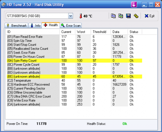

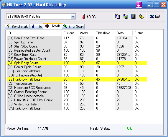

Hallo guru's.

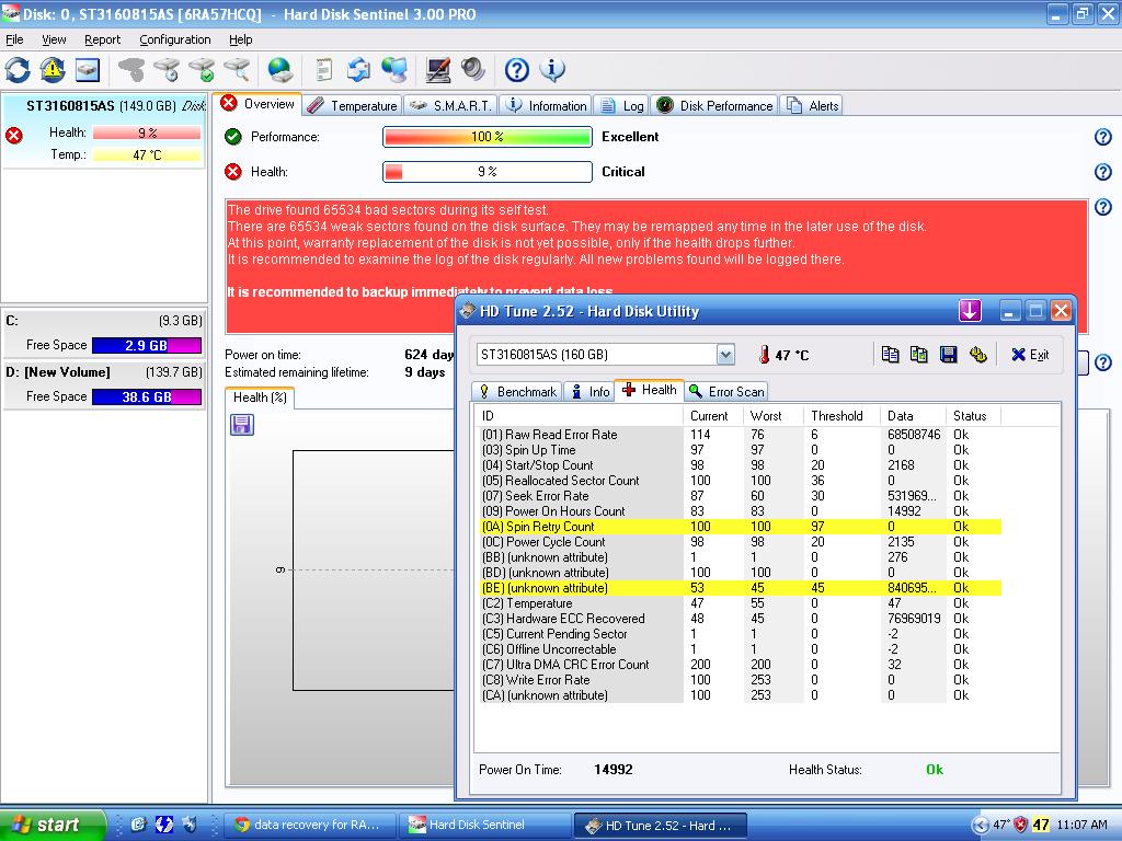

I own this drive, looks ok, surface ok, but I am wondering why the values on current pending sector/offline uncorectable are so high?
imminent failure?
how does it look like?
thank you in advance
 Post subject: Re: ST3160815AS Looks like...?
PostPosted: July 29th, 2012, 17:35
The drive has begun degrading. If the pending sectors are concentrated in bunch of areas and they appear at consistent intervals, then the drive likely has a weak head.
Create a back up while you still can.

It's an internal problem . As these drives are quite of poor quality, no wonder. But a weak/degraded head would have shown a different behaviour. Out of curiosity, is this a recert drive ? (green lined label).

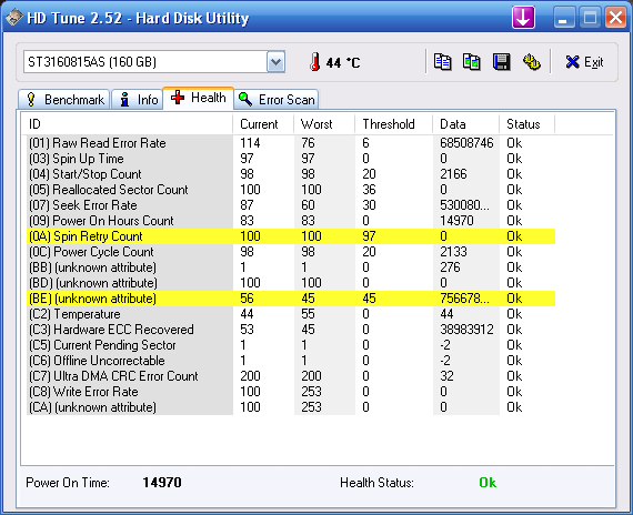

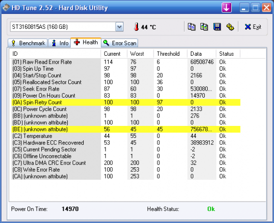

you mean refurbished
no, its not refub
my main question and problem its with current pendig/offline uncorrectable nuber showed in smart
so... if its head(s) problem, then so be it
it is stil working fine as only sistem drive, surface looks clean, no bad or weak sectors
firmware area degrading? something in its internal is wrong, somthing related with current pending/offline... just guessig
witch parameter is showing its degrading? besaids pemding/offline?
thanks in advance
PostPosted: August 5th, 2012, 0:47
Joined: September 19th, 2011, 14:14
Posts: 16
Location: ROMANIA
My opinion is that for this drive, in particular, is giving a bad report in smart attributes.
because the surface is clean and the drive performs as good as in the beginigs, brought as new.
the change in the pending/offline seems to came from DMA CRC errors, my opinion, but anyway, the values are extremly high like double integer, like out of control, WHY? since the drive performs NORMAL?
in attached picture it is like ''before''
thank in advance
PostPosted: August 5th, 2012, 2:07
Absolutely no. To determine what exactly the problem is, the INTERNAL logs should be checked and decoded but it is useless. At end user level , zero fill the drive and forget the SMART if surface works.

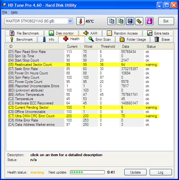

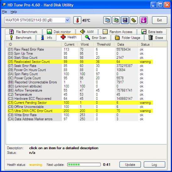

Hi again gugru's!

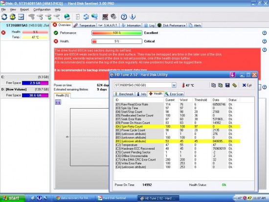

wonder if somone could give me a clue: scanned this drive with hdd scan, victoria, hddreg, low level format, and I stiil just can't find those pending sectors, if some one can give me a clue were to search and with witch tool please.
Thanks in advance!
PostPosted: October 9th, 2012, 12:21
Posts: 927
Location: uk
05 shows 64 reallocated sectors
C5 shows 6 pending sectors
As you can see smart has tripped and is showing a warning status.
It is time to change the drive as it is obviously failing. There might be a limited number of hours use left but again it might fail tomorrow so to ignore the warnings would be rather foolish.

this drive it is a toy for me, I'm playng around with it. I will not say that I'm new in DR and I will try to swap heads or platters, I'm not in that position, still. I trade a 4 gb usb stik for this drive see? it is a game, a simple one.
it is not a problem like changing the drive for me, it is just how I can find those pending sectors, becouse I used a lot of tools, and also spinrite, I just want to use the proper tool to fix those 6 pending/offline uncorectable. those were 7, find one, 6 more to go, wanted!
