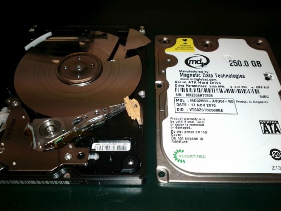

A few days ago I knocked my HDD off my desk while I was trying to copy some work files from it. When I plugged it back in it was making a ticking noise and not showing up in bios. I'm quite good with technology so I opened it up and saw the discs were stuck to the arm and couldn't move. I turned the disk by hand a few times to loosen it up and when I pulled the arm away from the disks I knocked the top one slightly and a little bit came off. (See attached picture)
I was just wondering if there was a specialist type of glue to piece these back together or if I'm just supposed to use super glue or something? I would normally let it be but I'm paranoid that the files I need are going to be on that missing chunk!
Many thanks in advance!

Not recoverable
 Post subject: Re: Magnetic Data technologies MD02500-AVDW-R0
PostPosted: August 9th, 2012, 9:00
Uhm... Not recoverable.

No files are recoverable. Can't read data from that disk anymore. It's done.
Highly suggest you do not power that drive on. It will shutter into pieces. You do NOT want to hurt your eyes or anything.

A pro should be able to recover from the bottom disc as long as it is not too damaged.
you do realize that data is not written from platter surface to platter surface on wd's. like a JBOD raid
The data writes jump form surface to surface almost like a striped array. So unless his entire drive is filled with tiny files, he is not getting anything from that drive.
do not give him any hope. Chalk it up to a DIY failure and move on. The data is gone.

There are two platters
if bottom platter is not damaged it is possible to recover data from it, convenient part here that the bottom platters is also an SA platter
However majority of DR companies do not offer such recoveries
Judging from the pictures it is a WD Venus/Denali/Cougar drive (WD WXE serial number)

einstein9 wrote:
Based on your experience Doomer, what is the cause of this? i mean platter in 2000 pieces?
you its not easy to break it in such way?
thnx
If you drop this drive on a concrete floor the result might be very much alike
I've seen shuttered platters before on Fujitsu and Toshiba drives
