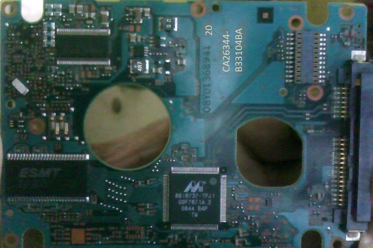

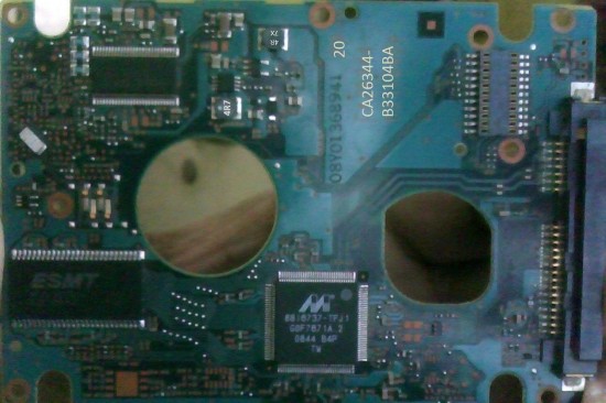

Sorry about the late response. I was trying to contact a friend to give back my camera so that I could post the pic but I just couldn't get a hold of him.
I'm sorry. The quality of the pic is poor but I hope it helps.
I checked the fuse on the PCB. It's closed.
labtech wrote:
Or like I said you can source another PCB by following compatibility criteria found for Fujitsu in this location: http://www.donordrives.com/hard-drive-p ... swap-match
I contacted them but they said my PCB is out of stock and it's impossile to tell when it'll be restocked.
File comment: pcb
 Post subject: Re: Fujitsu hdd with MHDD results. Fixable?
PostPosted: August 21st, 2012, 19:58
Given the picture resolution, I do not see any apparent damage.
Either start troubleshooting more on the PCB (can use the search function for this) or easier just source a compatible PCB.
