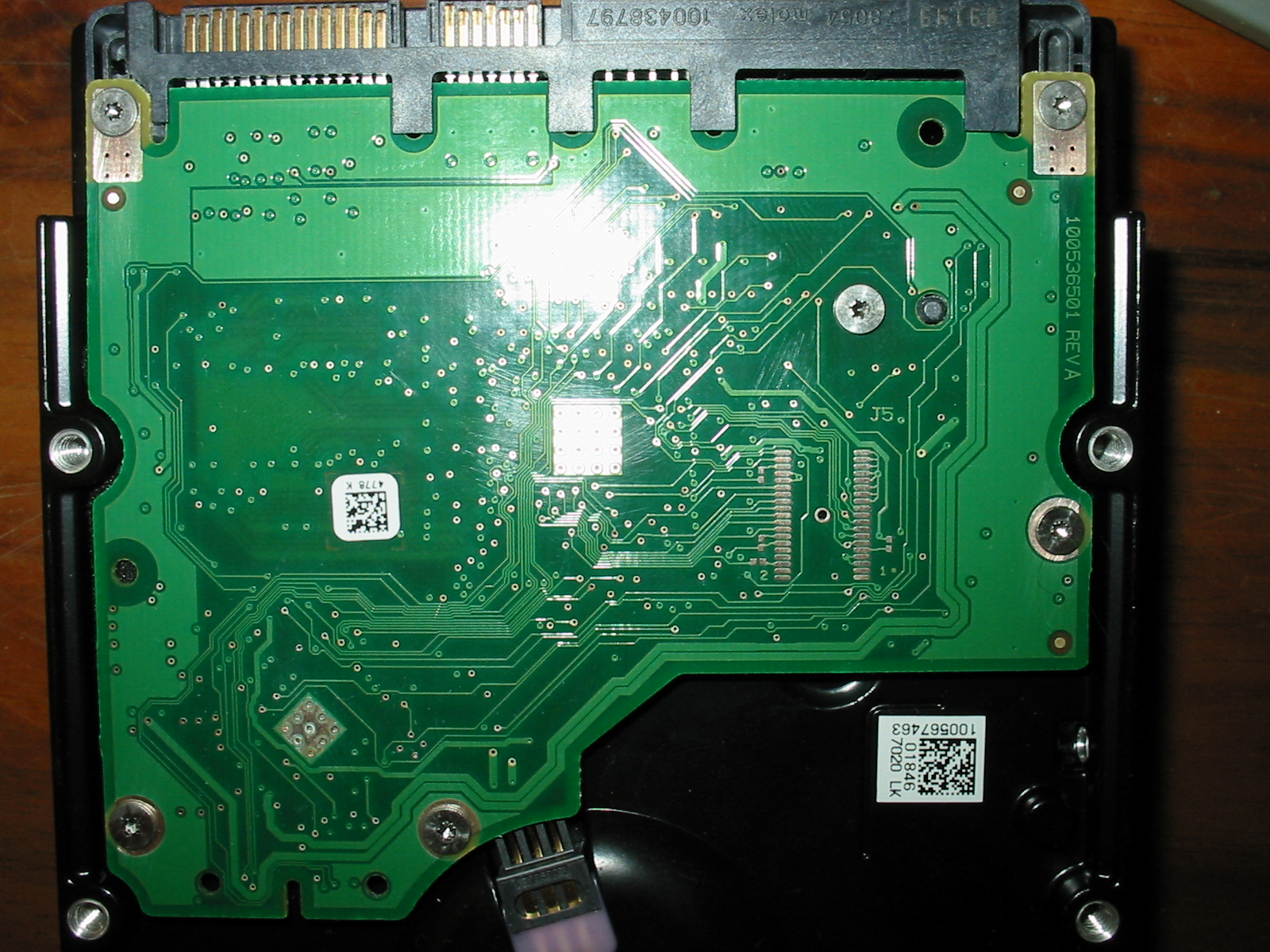

Hello i have a barracuda LP ST31000520AS fw CC32 in busy, bios does not detect it.
The pcb is 100536501 (same as for many barracudas 7200.12), heads are not clicking.
When i give smart reset in terminal i get "Init SMART Fail" error, take a look to terminal log:
ASCII Diag mode
F3 T>/2
F3 2>Z
Spin Down Complete
Elapsed Time 525.708 msecs
F3 2>U
HighPowerMode
ExecuteSpinRequest
Spin Up Complete
Elapsed Time 10.139 secs
F3 2>/1
F3 1>N1
Init SMART Fail
LED:000000CC FAddr:0024EE21
What's the problem with this drive?

What should i do with tweezers? :o

What is meant is: find the two shorting points on the PCB & use tweezers to short them.

ok the pcb is 100536501.
Where are the point to short?

Post photo of PCB from other side and I will tell you short points if you think this will help

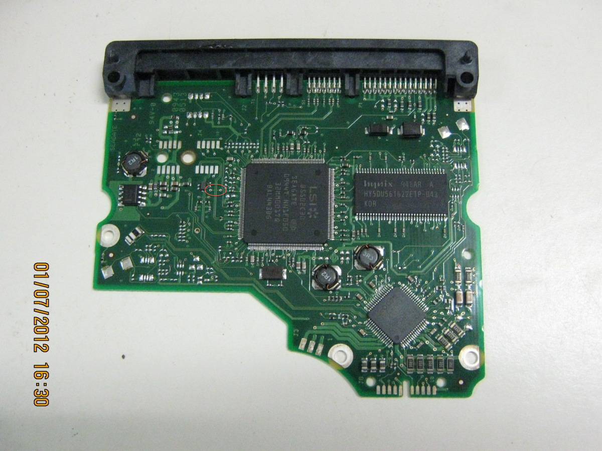

A quick use of search on this forums shows this has been asked before by a member called scottly
download/file.php?id=5259&mode=view
seagate-100536501-rev-led-short-pin-location-t23363.html
Loki

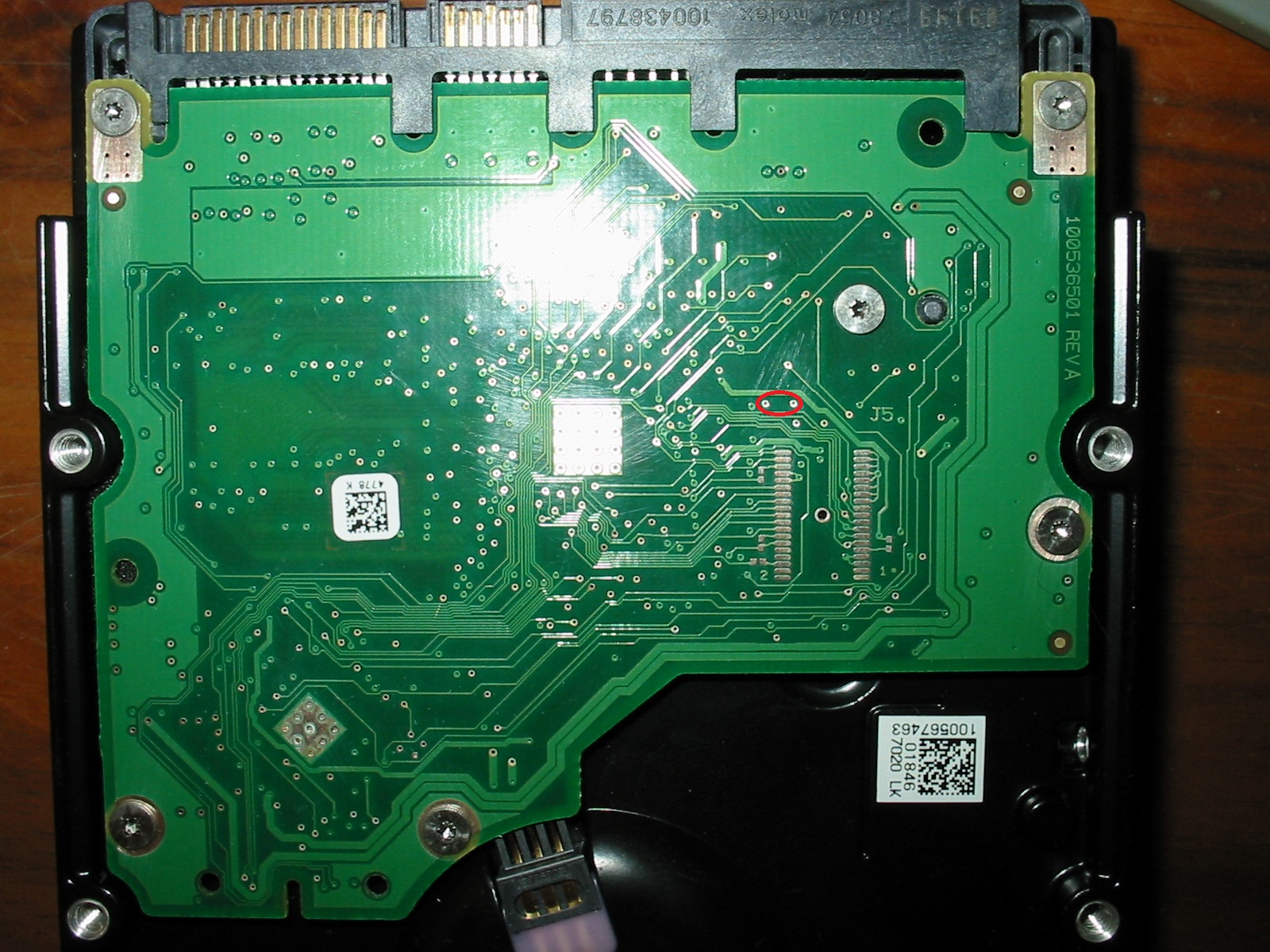

By matching up the location from the other pic it looks like it's these here
But I would recommend confirming it using a pin in each hole to check

ok, when i should short those points?
Only when i give the N1 command or since i power on the drive?
UPDATE
I just tried with shorted points since power on, but i still have the SMART init error when i do N1 :?

Shorting of read channels will not help to clear SMART. Primarily it will help to maintain terminal access in cases where it is blocked. I do not think terminal is blocked in your case so probably is no need for short circuit anyway.
It is very difficult helping in this case remotely, without seeing the media. Also, issuing specific terminal commands to the drive could have complications. For example you could successfully build translation system, but secondary defects list not accounted for and access beyond a few million LBA is not possible.
At this stage I would highly recommend you consult a professional. If not, then you can continue attempts yourself and run the risk of complicating this case even more than it already is.
