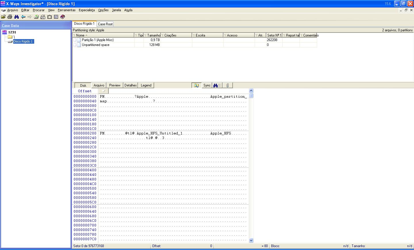

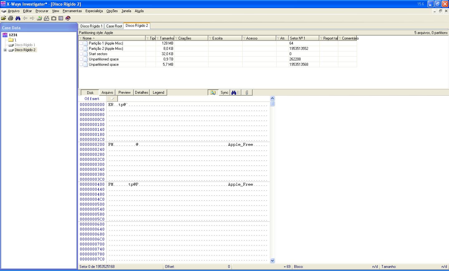

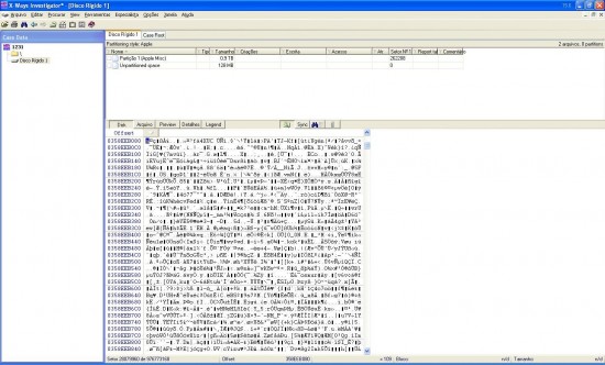

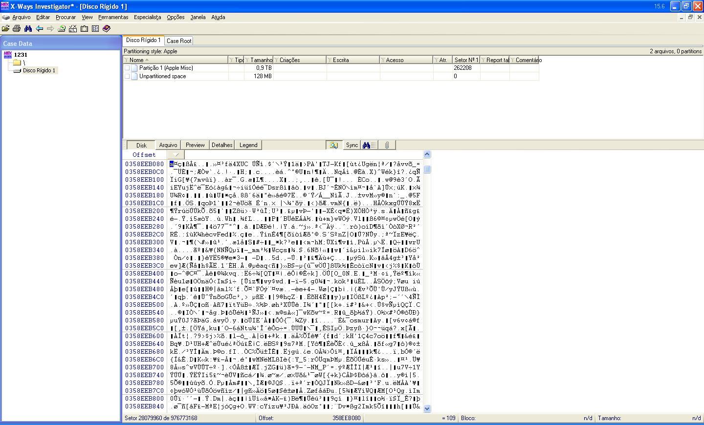

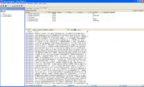

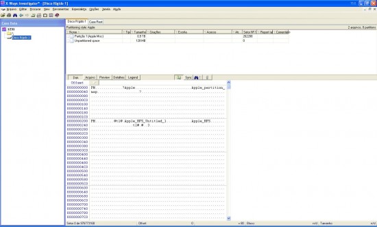

Hi Guys
I'm back from my holidays :mrgreen:
So, working again on this case.
Here are some images of the drives done with Winehex.
So, if they were encrypted, I couldn't see the sectors data, right?

 Post subject: Re: WD5000AAVS from WD enclosure
PostPosted: September 3rd, 2012, 8:37
Posts: 339
Two samples are clearly not encrypted. Other two not sure, if encrypted it would be random characters, can't say without analysing pattern.
PostPosted: September 3rd, 2012, 10:15
Joined: May 21st, 2007, 16:10
Posts: 1592
Location: Gothenburg/ Sweden
:good:
harddrivespecialist wrote:
You will see portion of the readable data thru Winhex in a beginning of the drive and rest of the drive will be scrambled.
Learn how encryption works and you will understand where you've made a mistake.
:shock:
The two readable samples are both from Sector 0...
http://www.rescue-it.se
