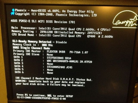

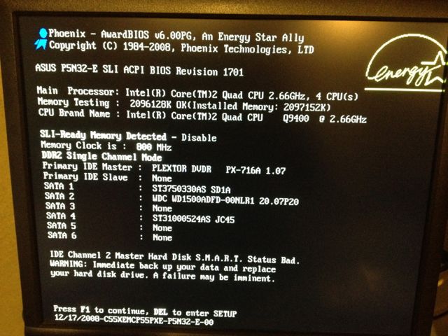

Your description of what is shown in your BIOS, is unusual for moden PCs. I'm wondering if you have a relatively old PC, with a BIOS that pre-dates the modern convention to show the make & model of the attached disk drive(s). If you supplied a photo of your BIOS "disk setup" screen showing the 1GB capacity figure, with the not-quite-dead drive attached, that would help us to better understand what you are seeing.
If I'm correct that you have an old BIOS in that PC, I'm wondering if the BIOS displayed capacity of 1GB is also due to a BIOS limitation / miscalculation, and that your drive itself might be reporting the correct information. In that case, this 1GB reporting by the BIOS would be misleading the diagnosis.

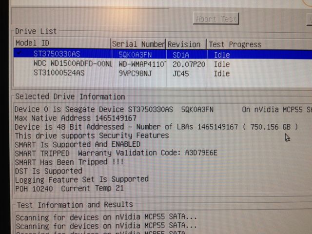

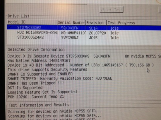

You said that you have already run SeaTools for DOS. I'm not asking you to perform any kind of test or repair (please don't!) but does that tool report the make / model / capacity of the drive? It's been a while since I ran that tool, but I thought it did display a list of the drives that it recognises - it must have recognised your drive in the past, for you to attempt to run a test on it, as you mentioned in your first posting.
Therefore, after attaching the not-quite-dead drive to the PC, can you supply a (readable, but not 20MP :) ) photo of the screen of SeaTools for DOS showing the list of recognised drives (and any other data that it gives e.g. capacity, serial number etc.), as well as a photo of the BIOS setup screen that I mentioned above?
Of course it's up to you whether you decide to supply the photos I've requested above or not, and doing that does carry risks (e.g. the drive could fail more catastrophically while you're gathering the info that I mentioned). As I said at the beginning, I'm just trying to find out of mis-reporting by an old BIOS is misleading that diagnosis, as the first step. Over to you. :)

 Post subject: Re: Seagate 7200.11 ST3750330AS "I'm not quite dead yet!"
PostPosted: September 2nd, 2012, 13:02
Joined: August 31st, 2012, 0:39
Posts: 24
File comment: BIOS from 2008! SATA1 is the bad drive.
File comment: SeaTools DOS. Proper size shown at 750GB.
Ok, here's bios photo and the SeaTools DOS info. Good news is that ST sees it at the proper size 750GB.
