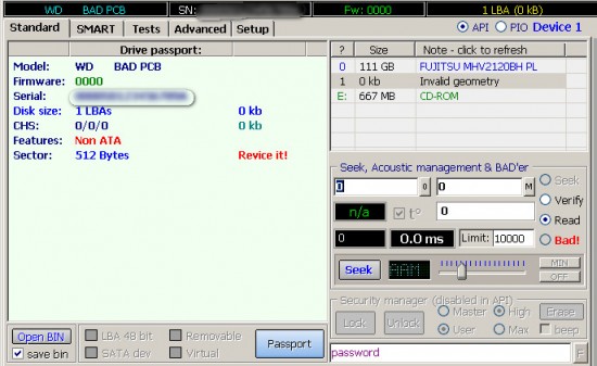

Victoria shows the information that attachment. Do you say that this issue doesn't has fix?
I do not know why, but today is listed as unknown by 'Windows Storage Disk Management' in Windows 7, but not in XP Windows.
any other ideas to recover the data?
Thanks for the respond.

I did not say anything yet
but here u go with options:
1- if dropped, then heads issue
2- ur case here FW issue if not dropped and needs Pro. help DIY will not fix it
good luck

There is MHDD script for translator regeneration. Not sure it will work on newer drives. I had similiar drive with someone else important data on it, so I didn't try to fix it.
In addition, Passport series have encrypting USB converter, so all data on the drive is scrambled. When you connect driive directly to PC SATA interface, even the drive is recognised you can't see your data, it will show random pattern except secor 0.
I suggest to connect it to PC SATA and see if drive is recognised correctly by BIOS (but don't allow to boot Windows). If so, try clone this disk using DOS utilities like DMDE or Linux life CD. If successful, put a clone to WD enclosure and see if a clone works in the enclosure.
If clone is also not recognised, then you need replacement for USB converter. Myself I would check voltages on the converter PCB first, but I don't know how to advise, not having PCB on my hands.
