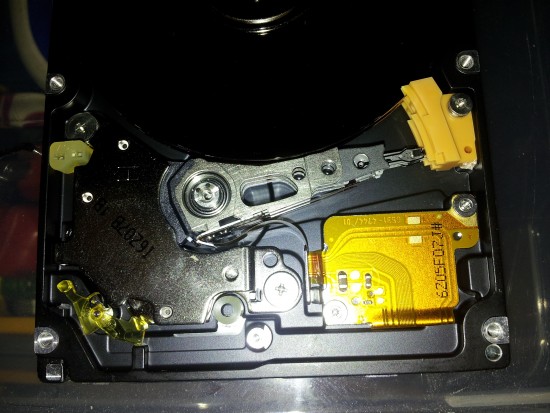

Hello everyone,

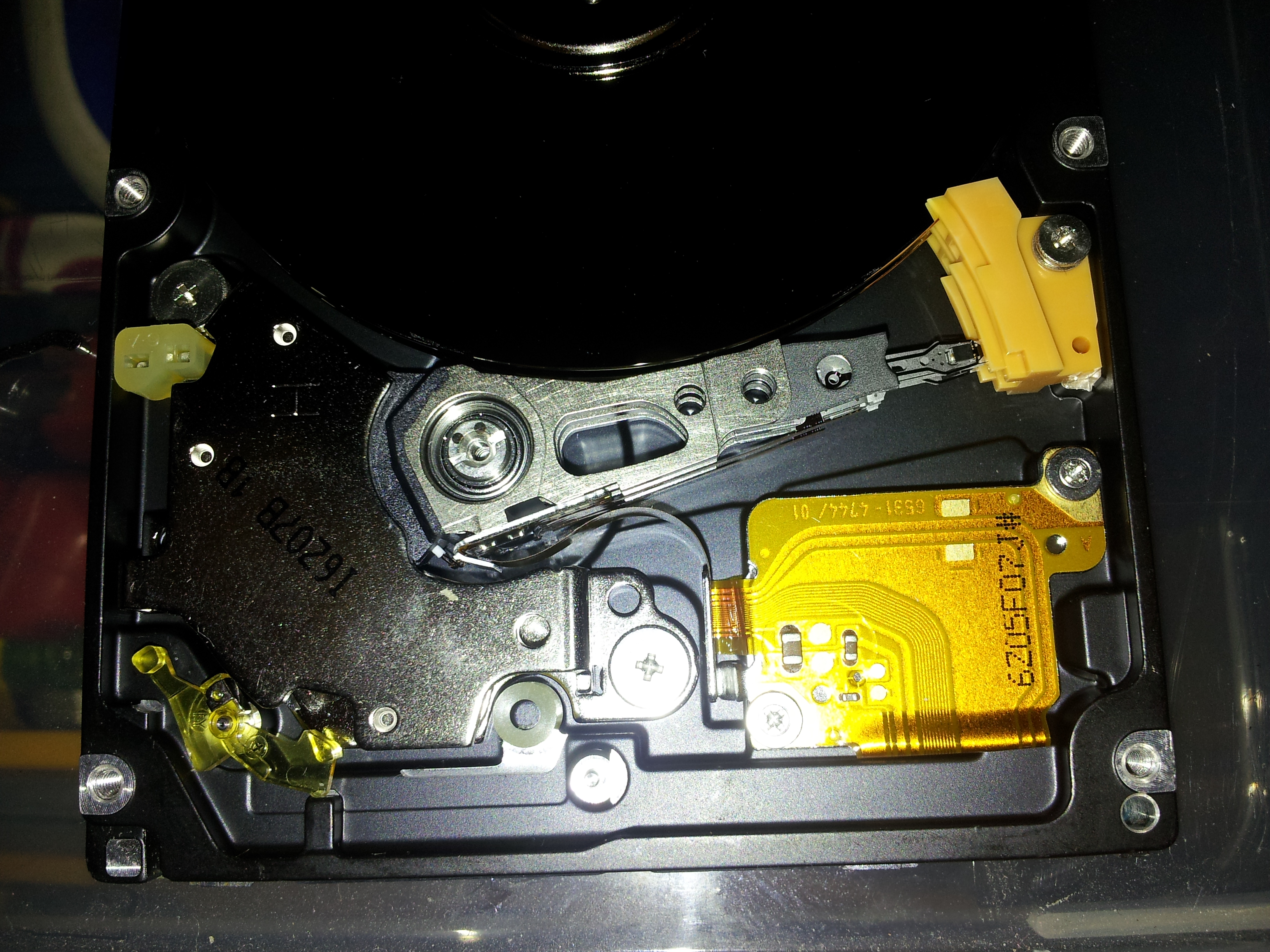

I have a Fujitsu 80GB 2.5" HDD.

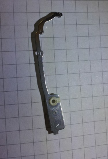

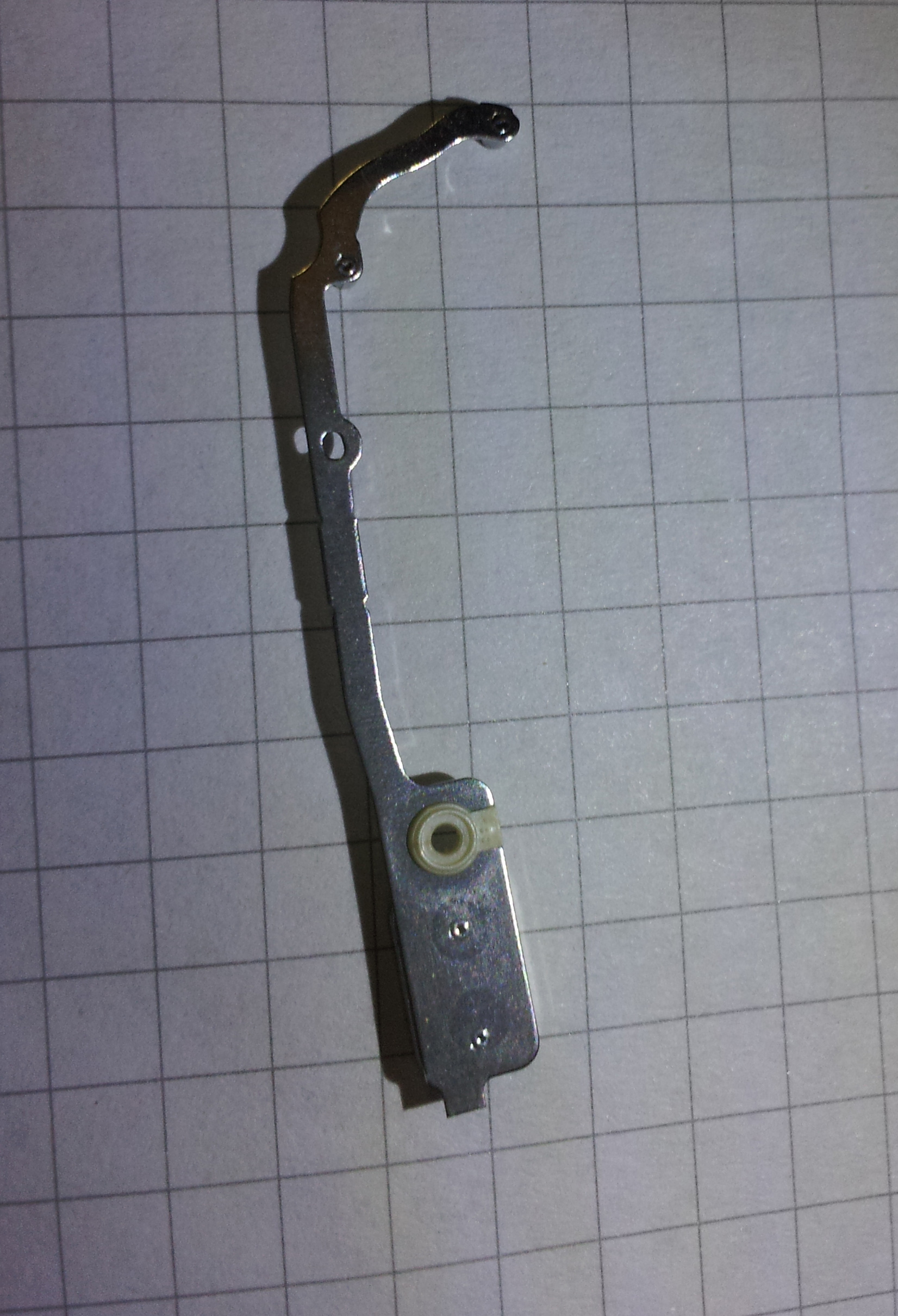

It was damaged in a laptop, so when i shake there was a "click".
Ive opened HDD in a clean enviroment, there was a broken part.
So HDD has physical damage, but not platters. It has 2 platters.
My question is;
- It's impossible to replace platters with a new (exact) HDD, right? Because of "servo info" or "sync"
- Should i replace EVERYTHING except platters? If yes, how can i do it? Is it a hard process?
I've attached HDD photos, including the "broken" part which i found in HDD case.
Again, platters are pretty clean, ive opened it in a clean enviroment.
Any help would be great.

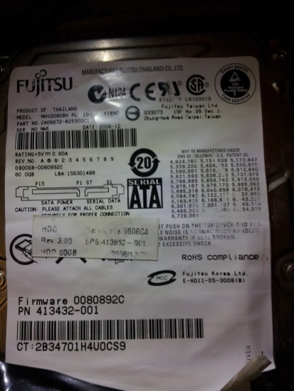

HDD info is below:
MODEL MHV2080BH PL
PART NO CA06672-B25300C1
DATE 2006-12
0BDC6B-0080892C
LBA 156301488
FIRMWARE 0080892C
PN 413432-001
PCB CA21338-B74X

Hi, first that part should be there and it should only rest on a needle...second is, were in a harddrive do you think your information is stored?!? ...no, no think again, yes right, on the platters! So if you replace the platters...
I belive in this stage there is no hope for DIY...sorry to say.
You'll need Pro help on that one.

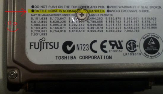

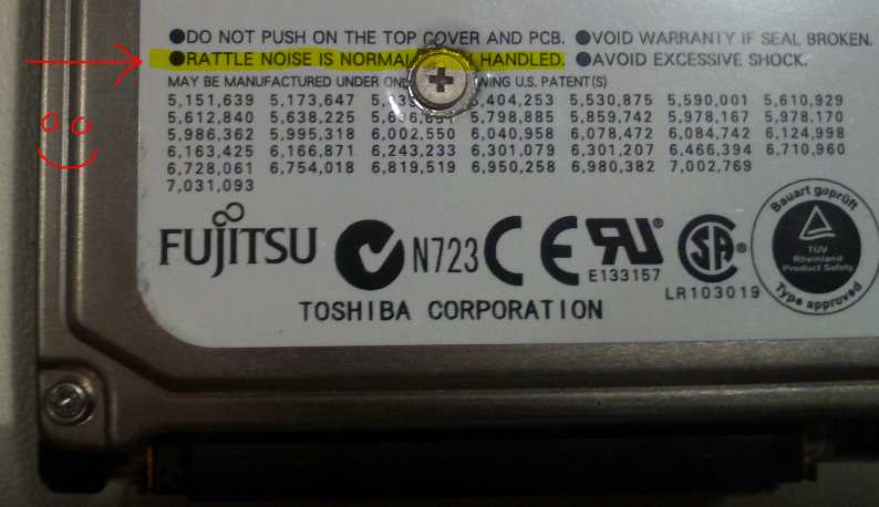

Bosse is correct, that piece is meant to be like that, doesn't look broken to me. It must sits on that pin you see.
These drives DO rattle when shaken.
DO NOT swap the platters, unless it's seized, which is unlikely.
If the drive makes clicking noises when powered, then the heads are bad.
Repeat.... you DO NOT need to mess about with the platters.

Rattle rattle rattle.

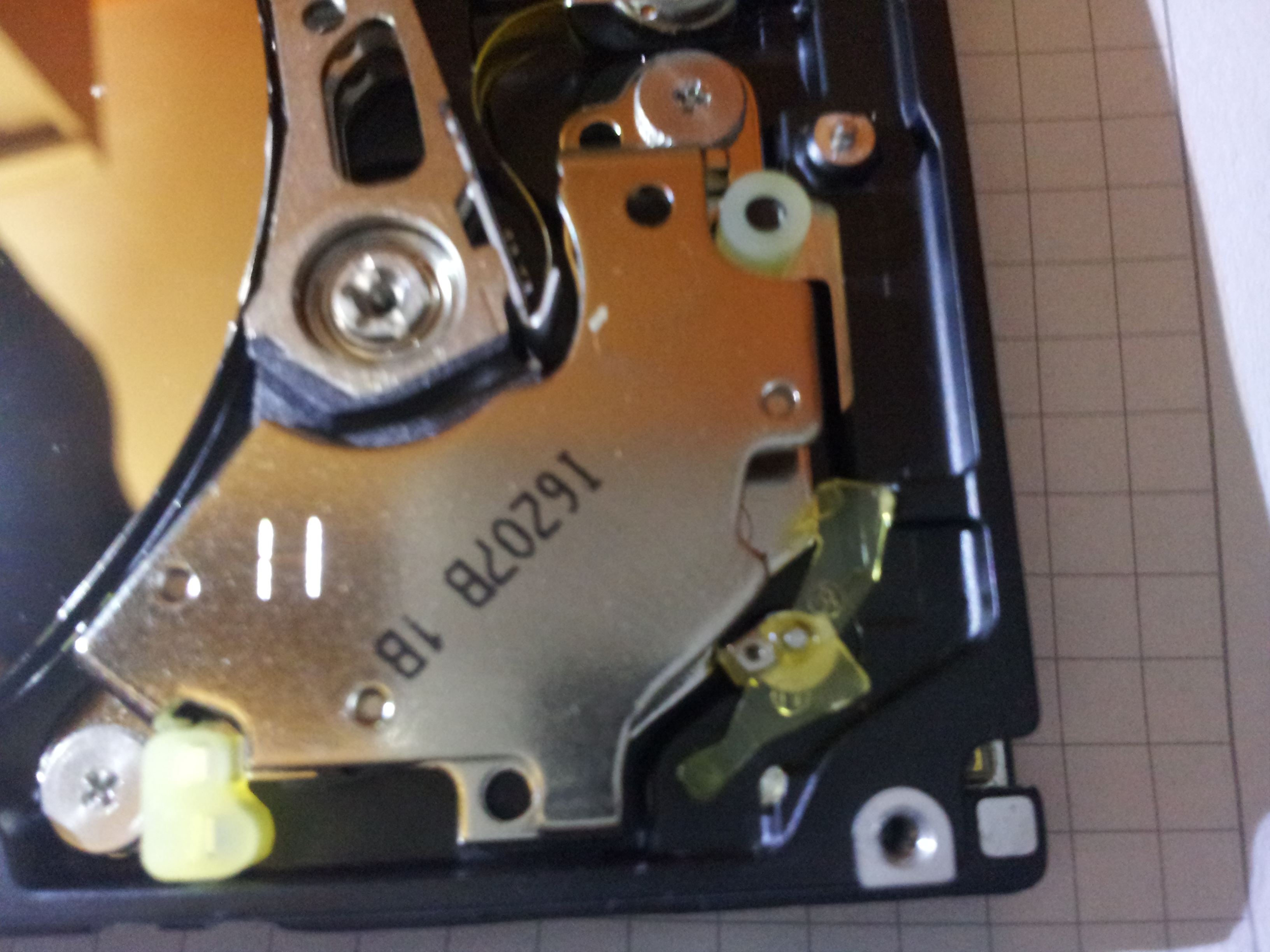

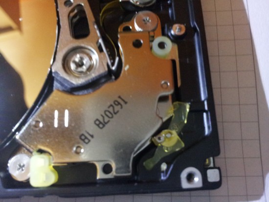

Here is the picture of piece i am talking about.
File comment: hdd

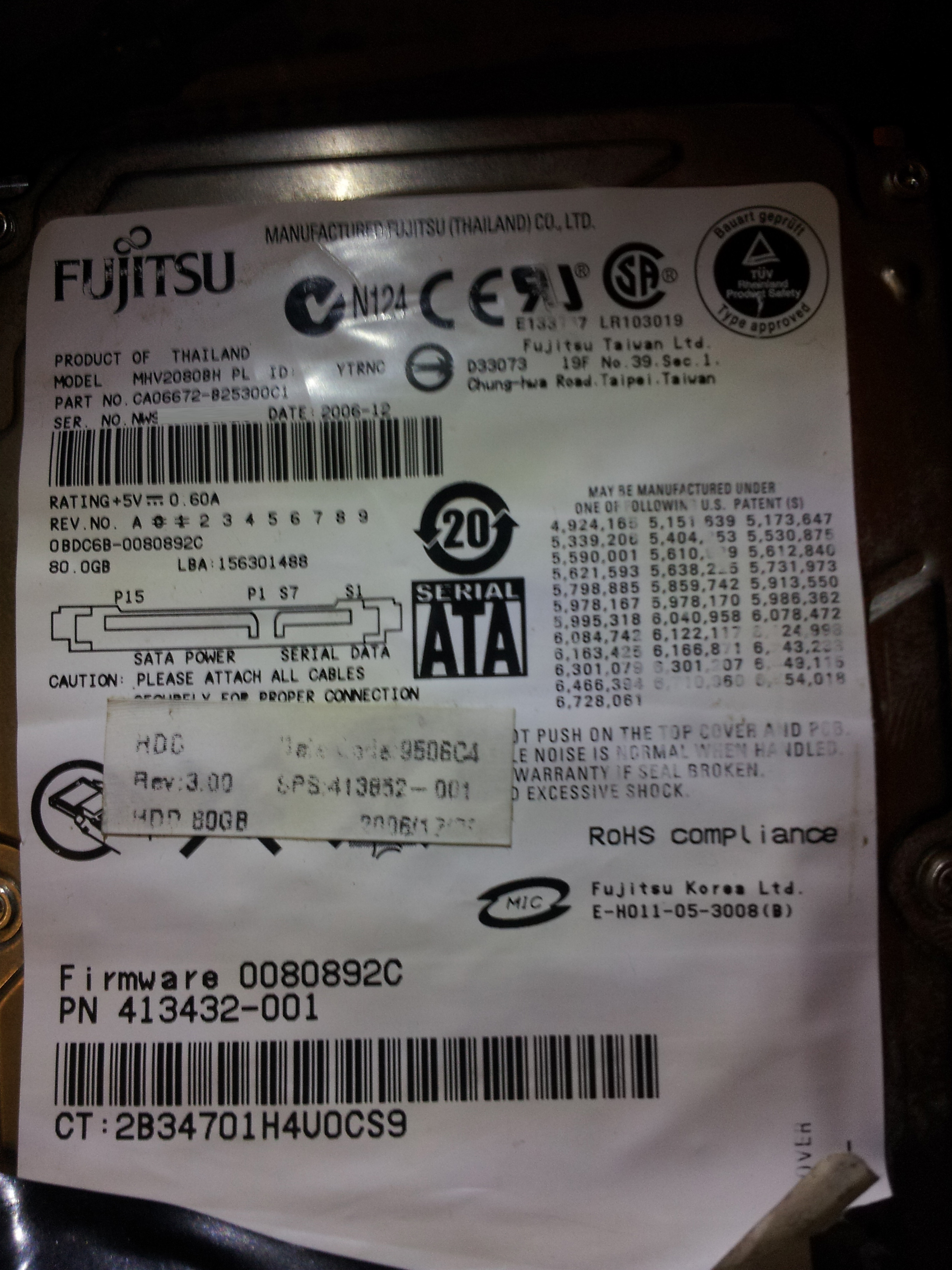

Also, whats the important point when ordering donor disc?
I've found same model with same part number, also same firmware.
Is that enough for a repair?
Here is the picture of HDD front cover:
File comment: hdd info

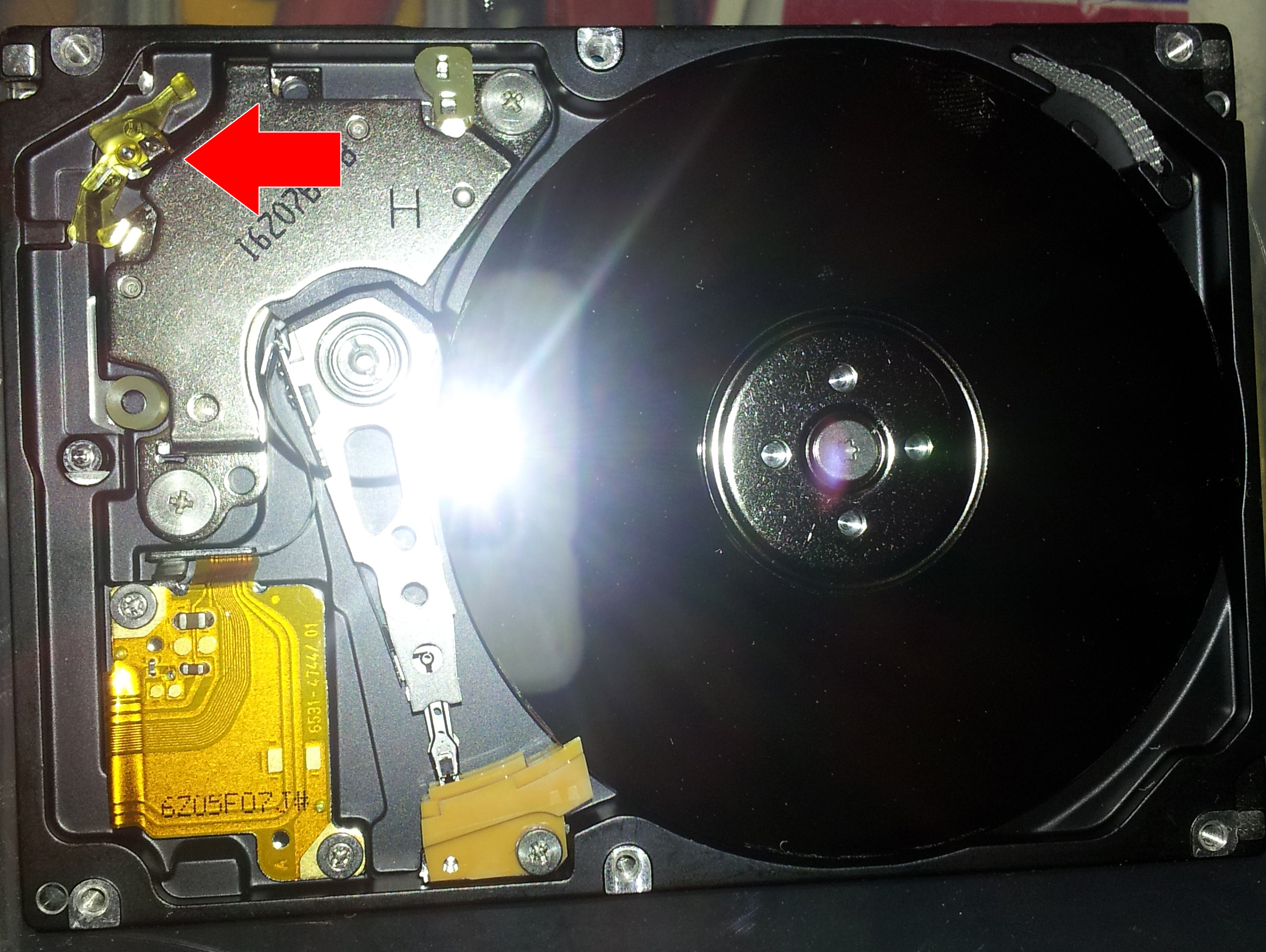

Oh dear, this is a disaster waiting to unfold :-(
You are clearly not going to listen to anyones advice so I will politely step away from this thread.
As you have been told it is a heads related issue, nothing to do with those pieces you mention, they are normal.
What's more concerning are the scrape marks under the heads, scrapes to the edge of the platter and dust all over the platter. (yes, I know H3 is not present so this top surface is unused, but it is indicative of what's lurking within!)
If you need your data then you need pro assistance, but if data is not important then by all means have a stab at replacing the heads.
I wish you all the best of luck, but this is not gonna have a happy ending :-(

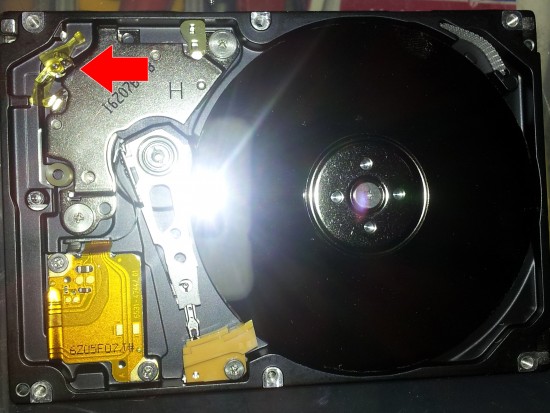

taking a close look at photo hdd20120831_001727.jpg one sees a fingerprint and tons of dust. There is confusion between "a clean room" and a "clean room"- see http://en.wikipedia.org/wiki/Cleanroom for what we are refering to as a cleanroom. The drive has its origional problem of heads? or? as diagnosis is not complete, PLUS newly contaminated platters. Going south here.

From the drives heads point of view, a dust partical is like driving on the freeway in 110km/h and hit a tree...can go well but can also be a disaster.
And from the photo I can also see damage on the outer tracks on top side...and it looks like head 0 is standing right up...could well be a nasty scratch on 0 level.
