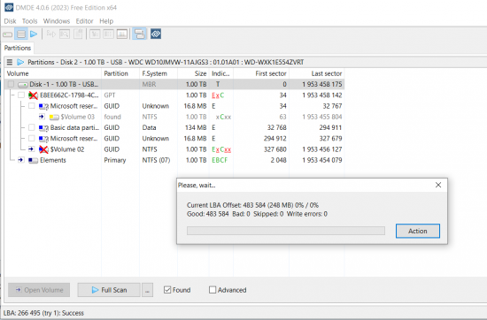

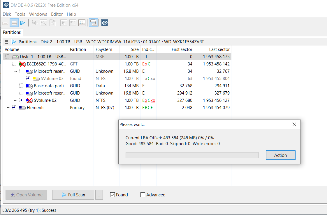

Thanks for your response.
I launched the clone operation with DMDE as you suggested to another SSD.
Apparently it looks like it's working there are no errors, but its' extremely slow, it took around 1 hour to make 250MB.
I can leave it on for days of course if this allows me to recover the data, but I'm unsure.
Shall I continue?

Just a follow up. I aborted the clone operation, in case I can start another one.
But there is good news, from the 500MB I cloned I was able to recover some files, so this means that the head is working.
Don't really know if to continue the clone slowly or try the RELO clearing suggested by melvin...
