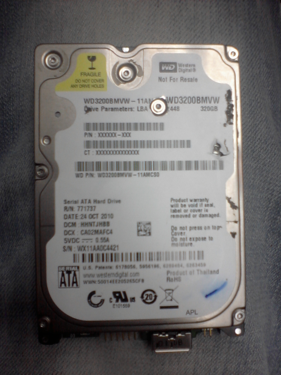

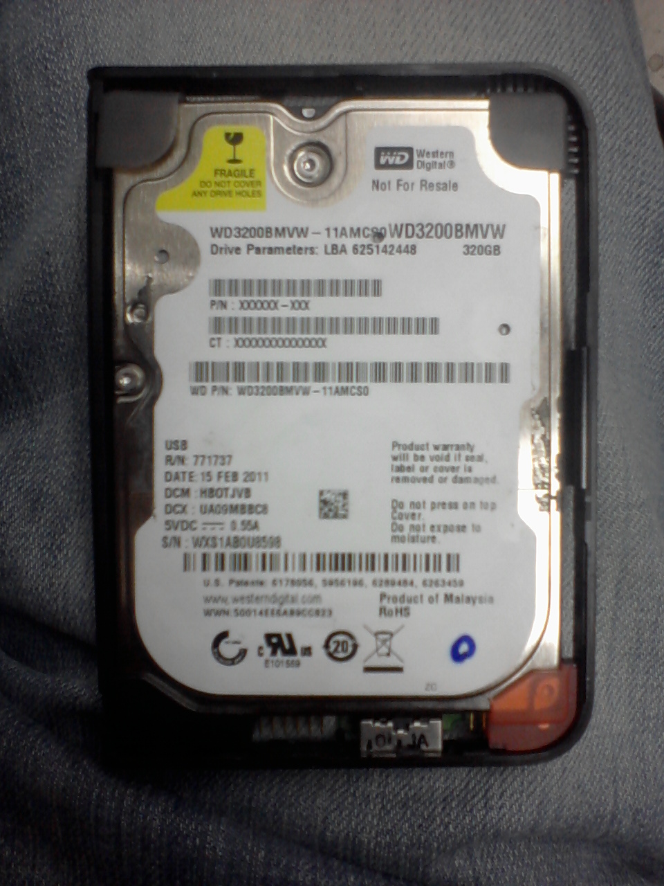

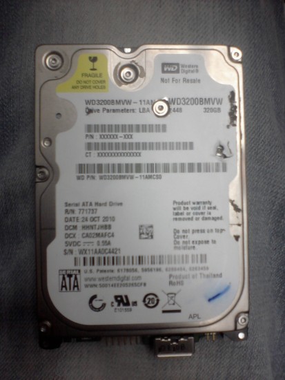

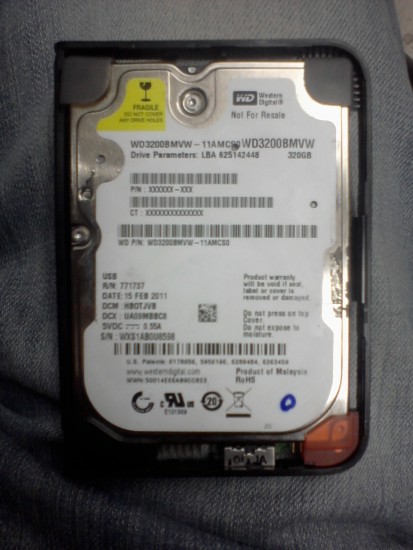

Humm, can you post images of BOTH hdd`s that you changed HEADS Patient & Donor?
just wanted to clear something in my HEAD about your case :!: :!: :wink:
thank you
 Post subject: Re: WD3200BMVW-11AMCS0 USB3.0
PostPosted: September 10th, 2012, 10:39
Posts: 1748
WD3200BMVW-11AMCS0 USB3.0 : Patient
WD3200BMVW-11AMCS0 USB3.0 : Donor
Do you want the images of both drives?
PostPosted: September 10th, 2012, 10:47
Posts: 1748
Patient and donor :

NP, thnx this helps

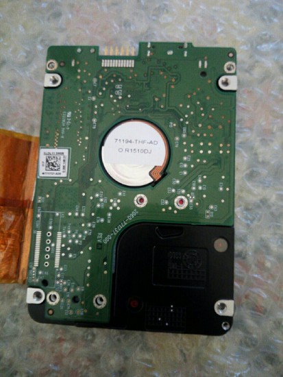

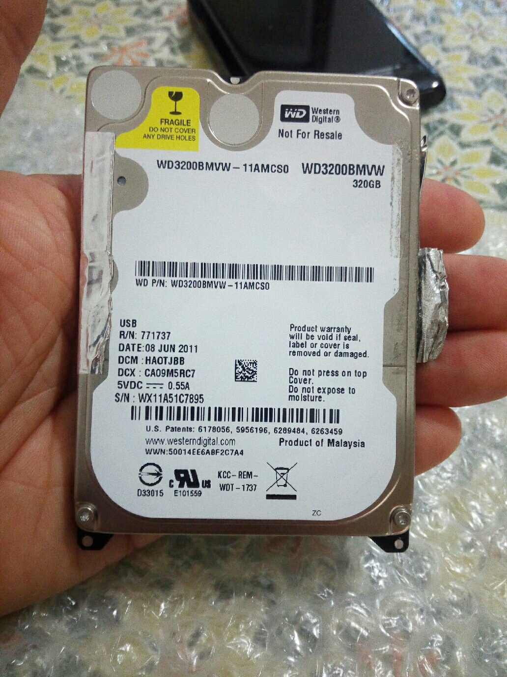

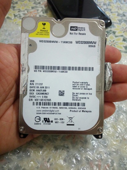

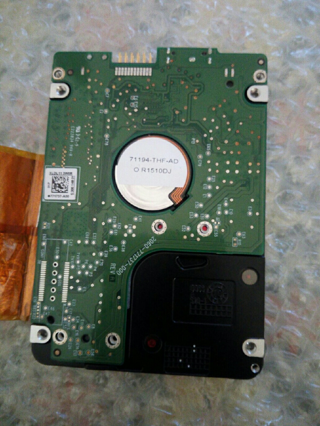

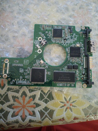

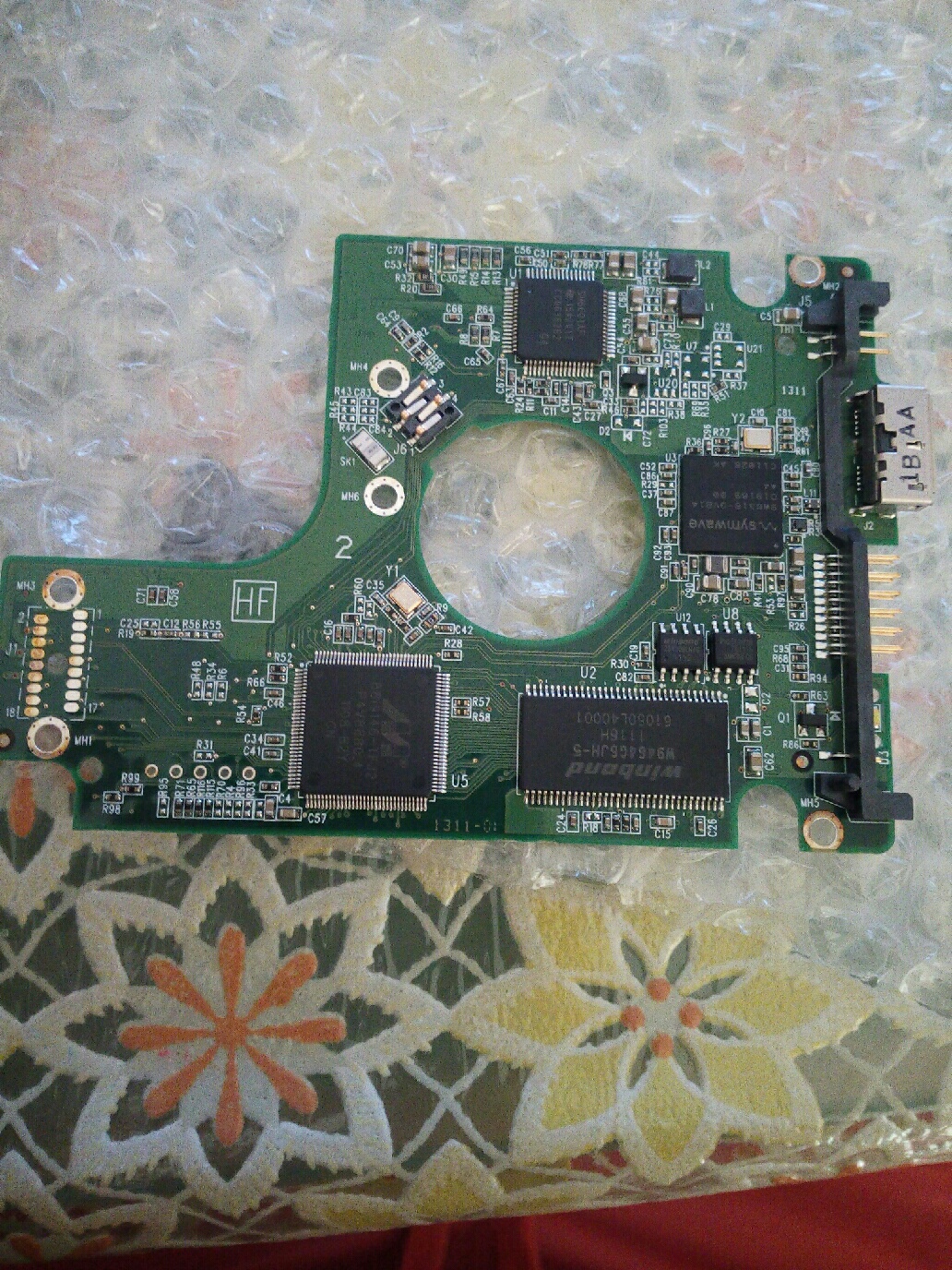

hello, I have a hard drive western digital my passport 320 gb with the features in the picture.
Unfortunately, hard disk is no longer recognized by the PC and start feel two small hum. The LED lights.
if I change the circuit board can I fix it?
you can advise me what to buy and where?
thank you in advance
PostPosted: August 27th, 2015, 11:03
The PCB is more than likely not the problem.
Educated guess: drive was likely dropped or sustained some sort of physical shock and as result the internal components have gotten damaged or stuck in some king of way.
PostPosted: August 27th, 2015, 11:11
Posts: 1388
Location: isreal
if the problem is just the PCB, you need 2060-771737, there is a lot of places to buy it, example 1, example 2 and there is more, but you will probably need to transfer the u12 chip.
the question is if it's the PCB, is there any noise from the HDD ?
