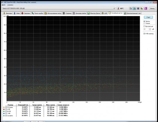

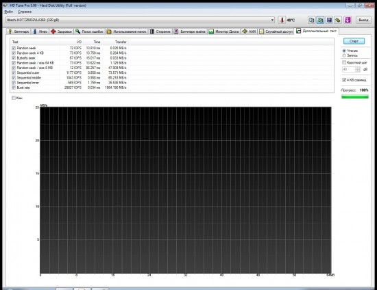

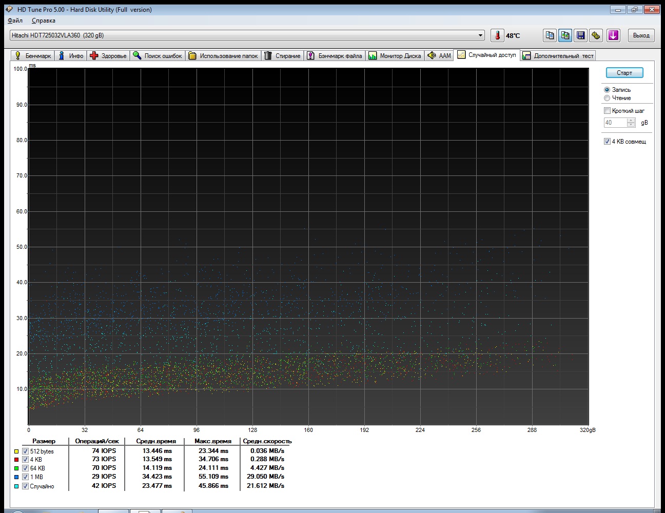

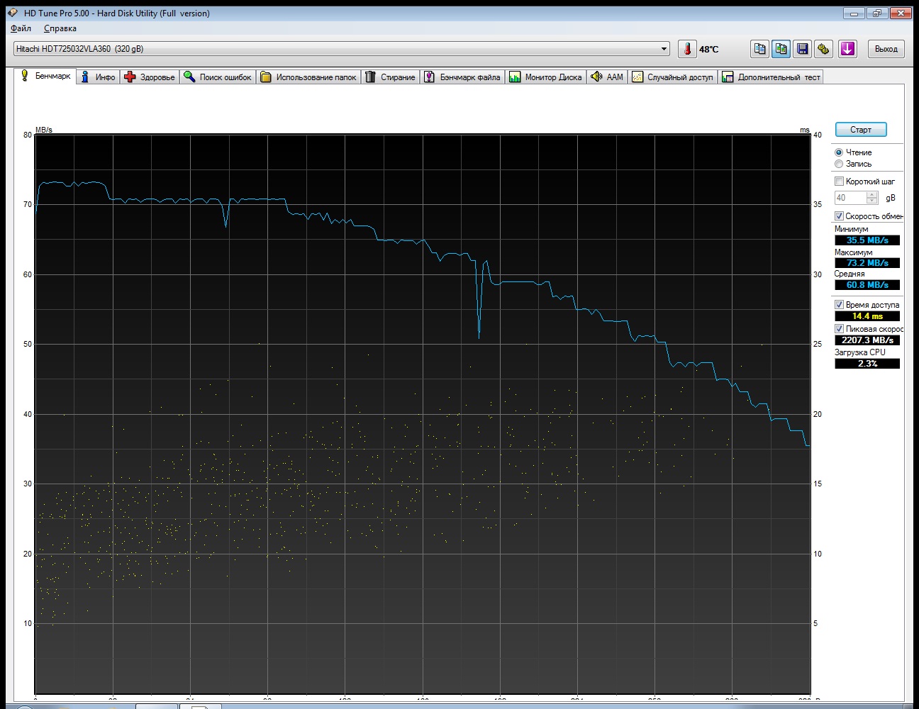

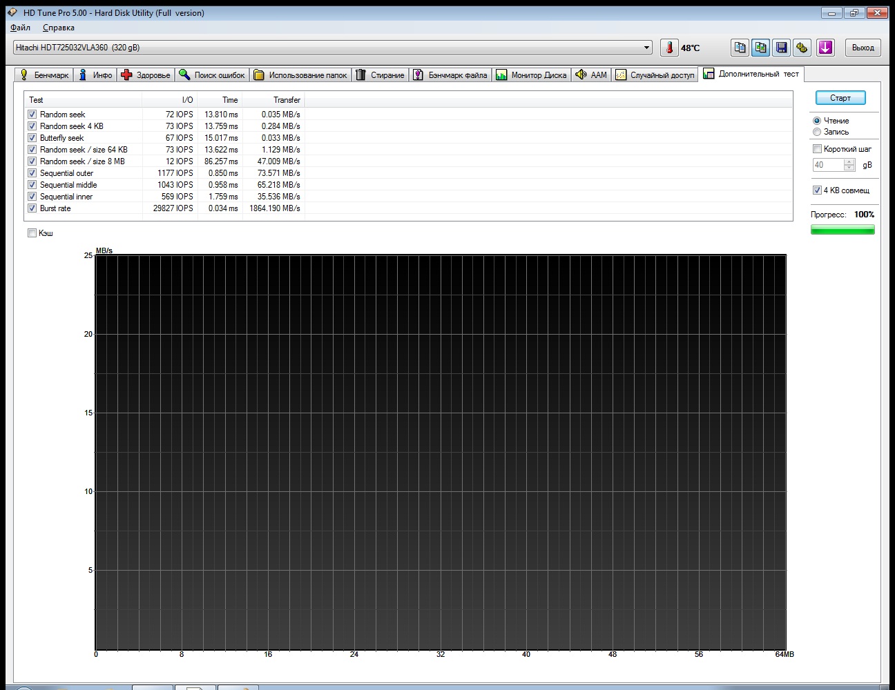

 Post subject: Re: Hitachi HDT725032VLA360 clicking
PostPosted: September 15th, 2012, 6:18
Joined: September 8th, 2012, 7:49
Posts: 12
Location: Россия

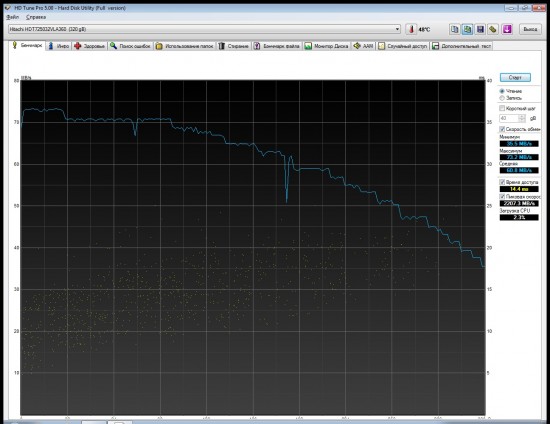

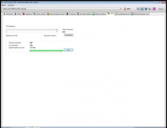

I've done tests by HD Tune Pro in my same computer. See results
PostPosted: September 15th, 2012, 9:20
Though I do not understand Russian, based on the graphs and numbers, I do not see anything concerning with the drive.
I do suggest, as mentioned before, that you run the same test on a different machine as well, and potentially with another benchmark testing tool just to confirm consistency.
If you will follow the suggestion and everything indicates consistency with the drive's operation, then I would conclude that the random problem is with something else. Not sure what, because if anything such as the power supply unit would have become problematic, then the problem would have been apparent consistently and likely gotten worse. Pretty much the same with the capacitors I would expect.
Hope this helped.
