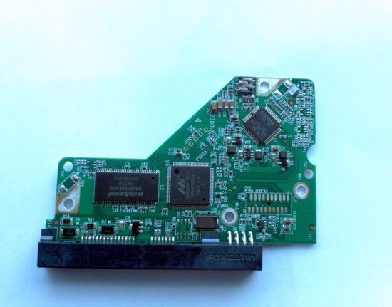

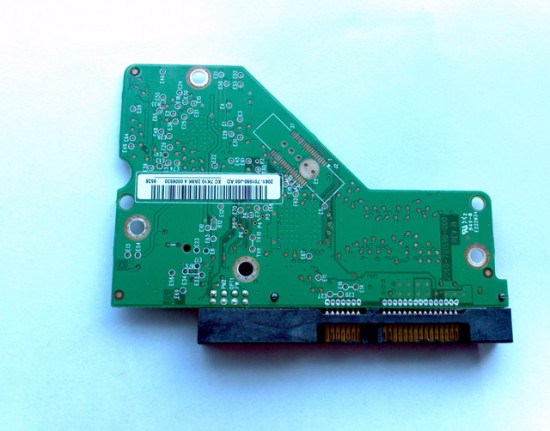

Have been trying to locate the following board and get everything sorted out so i can install it back onto my drive and recover all my ahem, backup data. Seems a little harder than I thought trying to track it all down. Any help would be appreciated.
Have attached images for anyone that thinks they may be able to help
model: 1.0TB WD10EADS
Board: 2060-701590-000 Rev A
Sticker: 2061-701590-j00 AD

Hi, as this board don't have an external Rom Chip...and all the adaptives are masked in the Cpu chip. It's necessary for you to seek a pro.
Contact Sean: member5866.html He's in Peterborugh.
