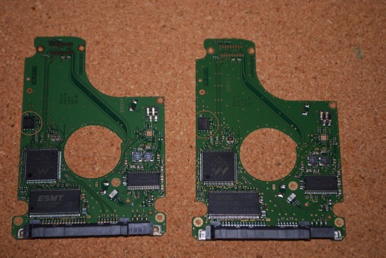

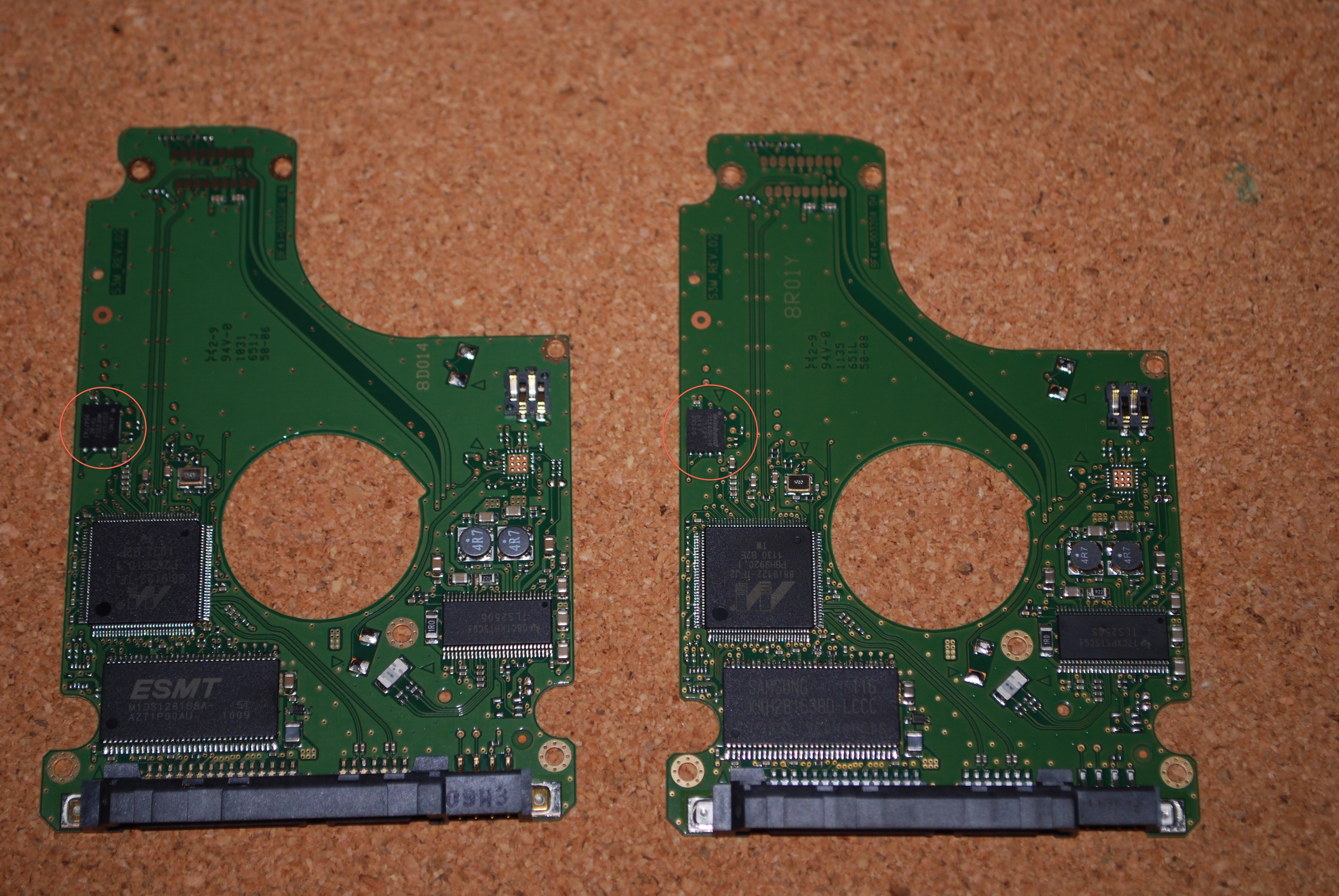

 Post subject: Re: HELP : Dead Harddrive Looking new board.
PostPosted: September 13th, 2012, 22:35
Joined: September 7th, 2012, 9:44
Posts: 9
Location: Canada
Side by Side Photo
http://imageshack.us/a/img18/379/dsc4756w.jpg
http://imageshack.us/a/img193/2565/dsc4752x.jpg
PostPosted: September 14th, 2012, 1:24
Joined: May 21st, 2007, 16:10
Posts: 1592
Location: Gothenburg/ Sweden
Hi, those looks good...but you need to swap Rom...marked in red.
But be careful those tiny chip's can easy break.
Cheers/ Bosse
