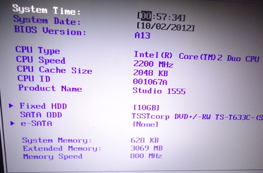

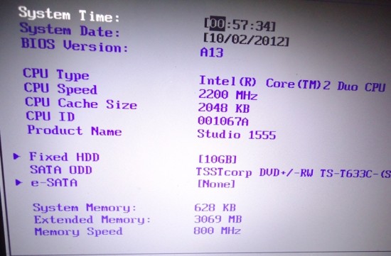

Joined: September 26th, 2012, 10:16
Posts: 7
Location: MICHIGAN
thx guys for all the help and guidance till now
@Vulcan right I might not be able to convey it properly.
As SAjunky suggested I tried my drive again and here is the screenshot of the BIOS it only shows 10GB in place of the HDD name and identifier.
This might convey it all properly.
Thanks in Advance for all your valuable suggestions guys ...Need it and muchly appriciated.
thanks
Dagget.

 Post subject: Re: Western Digital Caviar drive died
PostPosted: October 1st, 2012, 17:46
Joined: May 6th, 2008, 22:53
Posts: 2138
Thanks for this info.
So this seems different to part of your previous update, where you said that "the Disk failed to get recognized in the BIOS all together" (my emphasis). Your screen photo appears to show that the disk is recognised, but with the wrong capacity.
IMHO this situation still looks hopeless for any DIY options as I said earlier, due to the incorrect drive recognition. I could suggest more info gathering (I started to write some here a few minutes ago), but based on the info you're showing, and assuming that the device reporting 10GB capacity really is this WD disk, then further info gathering won't change the end result. :(
I'll leave SAjunky to help you. I'm sorry to say that I think you're out of sensible DIY options, based on what you have reported.
PostPosted: October 2nd, 2012, 9:08
Posts: 339
Why is this sarcastic comment? I don't understand.
I agree with Vulcan that with your computer skills it would be very tough to guide you, unless you find a friend who would assist you in recovering drive and then to clone it.. I feel there is a DIY solution, as Vulcan was about to write something.
My advice would be not conclusive, as my experience is very little. What I did with similiar drive not recognised in BIOS or partially recognised, is called translator regeneration. It works, but you must remember that it doesn't cure drive original problem, just temporary brings it to life and allows to clone it (with great possibility it would die again during cloning).
So if you want to research further, I can supply links to Russian Web sites, but for now - I think - put the drive on the shelf, don't allow more stress and be prepaired it would take some time to learn and understand what to do.
In general you would have to learn how to use MHDD 4.5 and translator regeneration scripts. Then learn about cloning process with ailing drive.
