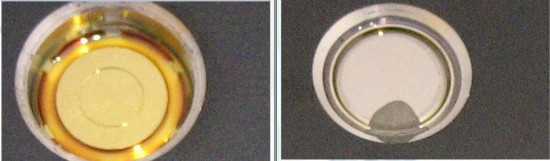

It could be part of the motor. The 1st pic is my hdd with the small piece missing. The 2nd pic is a good hdd. Is it still usable or do I have to send a RMA? Thanks for anyone giving a reply.
File comment: bad hdd
File comment: Good hdd

These both appear to be NORMAL.... :D

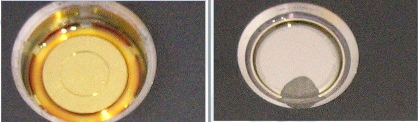

You may be right. I bought it a long time ago and I just find the difference. But the hole in the above pic is deeper than below and something seems should have been there. I can not take a clear photo due to the poor camera. Here is another shot and the out circle colored dark yellow in left is not metal but something soft. Instead the silver area in the right is metal. I guess some metal cap or sealer used to be there but now is missing.
File comment: comparison

No
There are different kinds of bearings and both bearings on the picture are fine and do not miss any parts

No
Thanks for your comment. These pics are taken from two hdds of the same model and I bought them together from some retailer some time ago. So there is quite a small chance that they use different bearings for products of same date of manufacture. I have never seen the bearing used in the left pic while all my other hdds use the right one, so I am a little confused.
Your conclusion is not correct
Different drives of the same model can use different bearings, in fact it is more than two kinds of the bearings. The drives on your picture look like Seagate drives. I've seen these models with 4 different bearings
