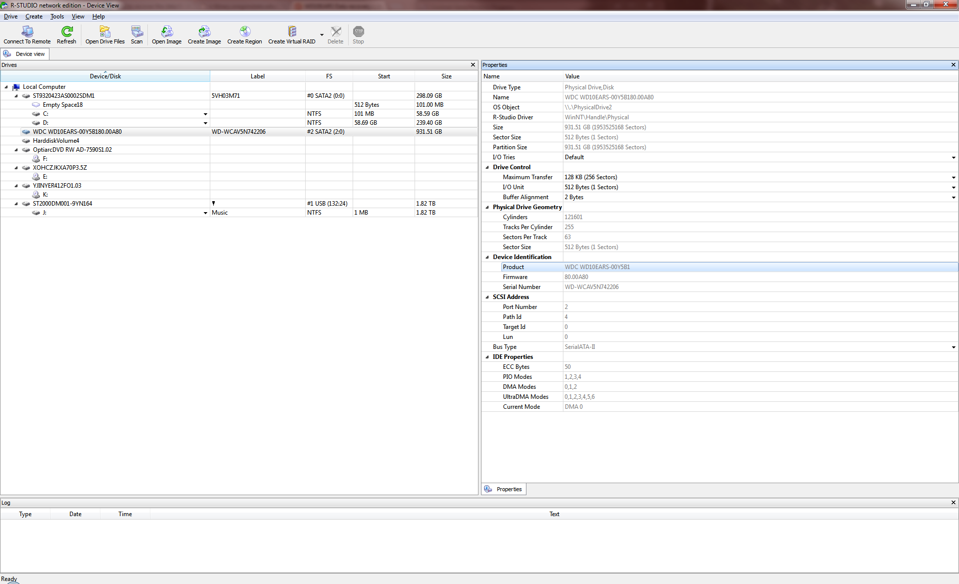

i've tried things like GetDataBack for NTFS/FAT32, stellar phoenix. these programs seem to not find any file system. I let the scans all run for the complete amount of time and all say there are no file systems.
I've done a raw file scan too, to see if there is anything on the disk. the first 23202406 sectors show a good amount of data with (only?) 481 file starters. the strange thing is that using GDB for FAT32 or NTFS, both find 481 file starters. i stopped these scans early and try to read the resuls for for instance image recovery. i get a very large single file containing apparantly the images, but cant open it.
Try MHDD to properly check if the drive has been correctly identified.
Also check in the bios if it is properly detected(model , manufacturer, size)
IF the drive is showing up in windows management as uninitialised,but showing proper parameters, then it can be a logical data recovery job.
Try partition find and mount,
or R-Studio
File comment: R-Studio_shot

There are several possibilities:
1 Disk is encrypted
2 When failing some critical filesystem data has been overwritten
3 Filesystem is not NTFS or FAT
Probably 1 or 3.
What casing was your drive in ? Many wd casings have build-in encryption.
