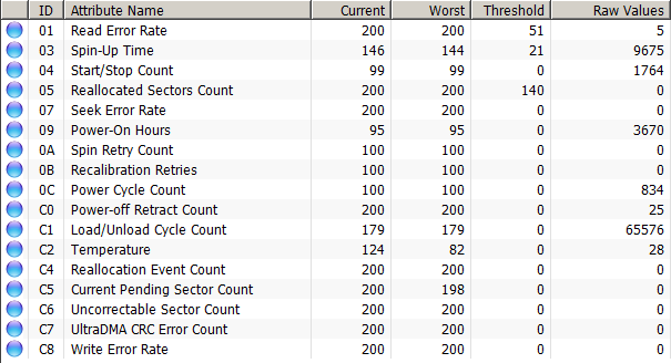

USB power save disabling didn't help. The SMART readings are in attach.
There were about 800 "soft-bad" sectors, which have disappeared after erasing the drive through WD Data Lifeguard, and didn't show up during full scan with Victoria for DOS. But some data was lost, and there were sudden slow-downs during copying files from the drive. I think that frequent spin-downs is the reason of this, but maybe i'm wrong.

Thanks. That shows an average of nearly 18 head unloads per hour (i.e. average of 3-4 mins between unloads/spindowns, which is obviously unusual), and based on the figures, I agree that WD have based the "cooked" (normalised) load/unload cycle count, on an expected lifetime of 300,000 cycles.
If I was in your place, I would attach that drive to a non-Win7 system. If you don't see the same spindowns after just 3-4 mins, that tells you there is something about Win7 causing this. If you do see the same behaviour, that points to the USB-SATA bridge (based on your earlier results). Unfortunately, as I don't have one of these drives, and don't use Win7, there's no investigation I can do.
Seeing the SMART data before running WD DLG would have been useful. However this is interesting (and slightly worrying) new information. Perhaps there is more than one problem here...

There is no way to disable this feature. WD released an utility for WD Elements SE called "WDIdleDisable", and it's not compatible with Elements Desktop, i've tried (AFAIK Elements SE contain drives with on-board USB-SATA bridge, and Elements Desktop use dedicated USB-SATA converter boards). The problem may be hidden in SPI Flash chip attached to bridge IC, but desoldering it will make the board unusable (according to topic found on this forum), and the size is about 128 kbytes (i doubt one could fix it, the datasheet for the bridge IC is not available). So the only way is to use another enclosure.
Saying about load/unload cycle count. I've noticed that this value stopped rising since i've used wdidle3 utility on internal HDD. So it looks like drive stops (Start/Stop count value) by the command from USB-SATA bridge, but it parks heads itself. It's the common problem of WD Green Series drives.
