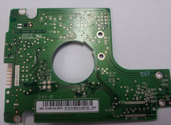

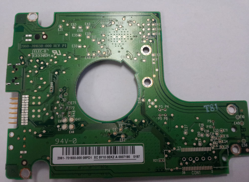

I need help with recovering data from a WD3200BMVV USB.
I know there are methods to convert USB to SATA for these ones, but haven't found information applicable for this drive.
Drive will not be sent and recovery will be made using tools in my facility. Have access to IR Solder, Hot Air Solder, PC3K, Atola Insight, Flowhood.
Advice that leads to sucessful revovery will be rewarded with €.
This is a study project for my own education, no important customer data on drive.
If you don't want to help your competitor i can inform you that i only do business in Denmark.

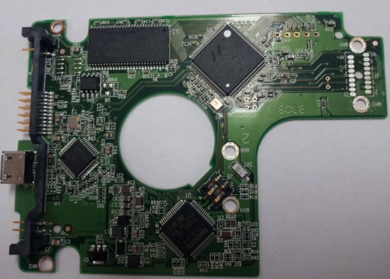

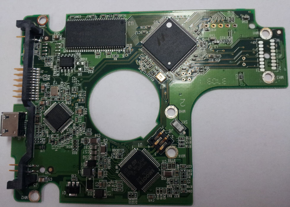

Plus uploading some high quality pictures of both sides of the PCB
The more info you give the better responses you will get.

Pictures

I'm assuming you know how to connect this drive up via COM port to your PC3K?
Have you done any other tests yet? ie backed up the SA modules & ROM, SA module tests etc
Just for info as you asked about the SATA hack connections.
Remove Capacitors: C13, C18, C31 & C33
Soldering points are E71, E72, E73, E74
Using the Search on this forum will help you find what to solder & where :wink: You'll learn more this way
