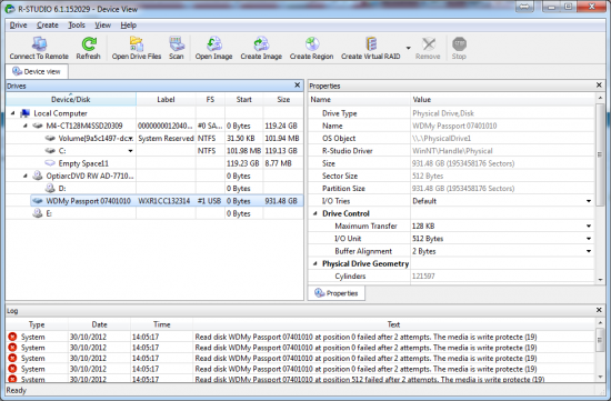

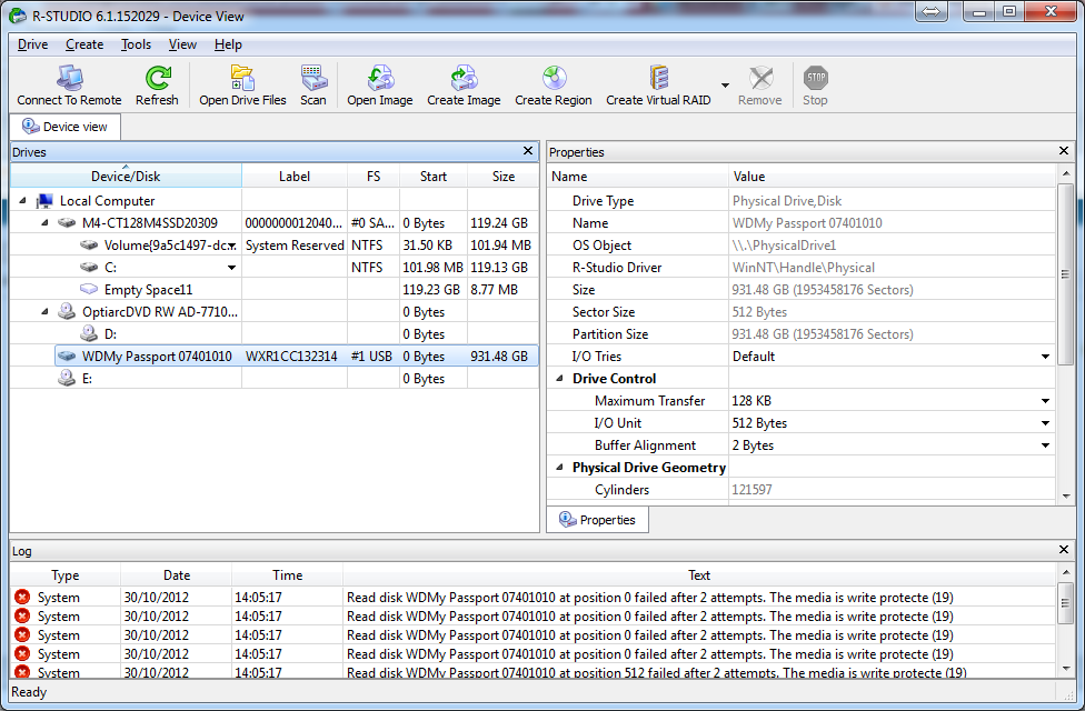

Good Day Data Recovery Professionals,
I have a WD 500gb 070A Passport which is write protected.
HDD is detected in device manager but not visible in explorer.
not visible in other freeware HDD tools

@datarecoverycenterPH, I'm curious as to how you arrived at the "write protected" diagnosis, since it begs the question, why would you want to write to a drive from which you wish to recover data?
You say that the "HDD is detected in Device Manager but not visible in Explorer". This suggests that the USB-SATA bridge IC is functional, but that there may be something wrong with the HDD behind the bridge, or maybe that its file system is corrupt.
You also say that the HDD is "not visible in other freeware HDD tools", so this would suggest a physical problem with the HDD. I'm assuming that you tried to examine the drive with a disc editor.

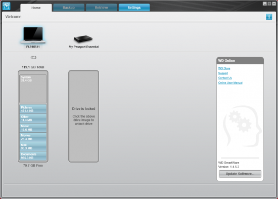

Just to clarify you can get the media is write protected if the WD Smartware password is enabled.

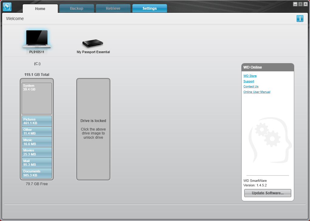

Dont be sorry.
As you say you have the PC3000 UDMA, did you buy it from acelabs or deepspar within the last year? if so then you can contact Acelab for assistance as you will have technical support. If you dont have support or its expired then you will need to renew it.
Also when pcimage said Password he wasnt meaning the hard drive password set via BIOS which you seemed to think
"Using PC 3000 UDMA, There is no user or master password for the drive"
Just for info:
These drives have a WD software called Smartware which users can set a password through.
If you download & install the WD Smartware software. when you run the Smartware software with the drive connected it will tell you if it is locked or unlocked
WD SmartWare.zip [15.42 MiB]
Downloaded 2383 times

Well, Loki FYI no need to install the whole damn thing to know since it slows your PC
i suggest, use the WD FW Uploader tool from WD, once you run it, it scans, and:
if locked will ask you to unlock it first
if not detected also will let u know
good luck

yep its locked! (via smartware and WD FW updater tool...)
Doesn't even let me format the drive (error after clicking drive erase in smartware.)
