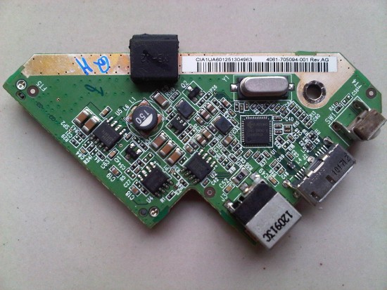

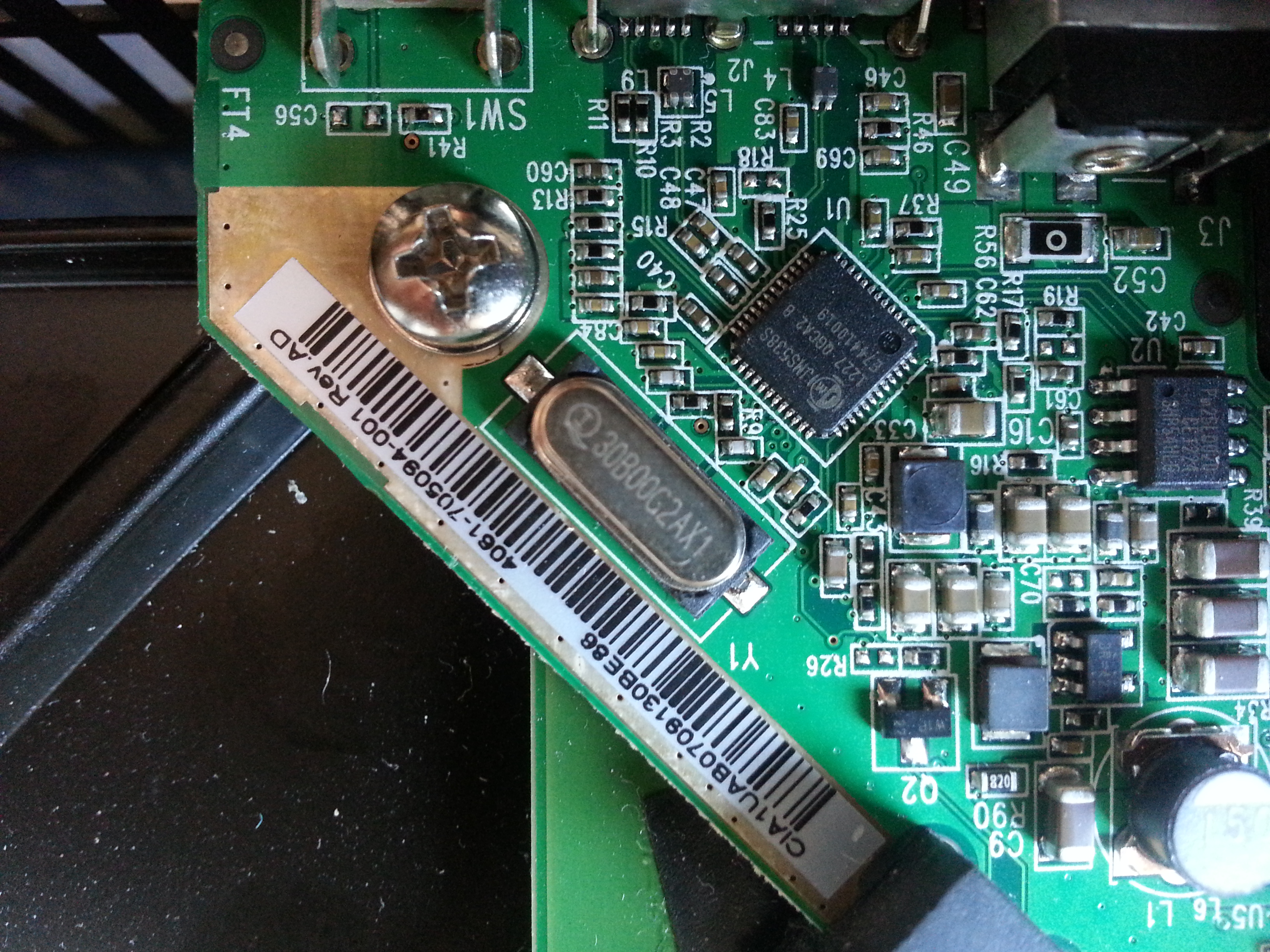

 Post subject: Re: External HDD to SATA fail
PostPosted: July 1st, 2013, 8:39
Joined: June 18th, 2013, 5:02
Location: Israel
Here's a picture of the board.
I think the sound it makes is of searching (and I...
You wouldn't believe it!
As I was plugging the disk to the electricity, it started making the annoying search sound, but then... it simply started!
I'm copying the important stuff as we speak, and I'll let you know what's up.
But, hey, Thank you! some times it needs just the power of the mind.
After all, there are no computer experts, just computer Shamans ;-)

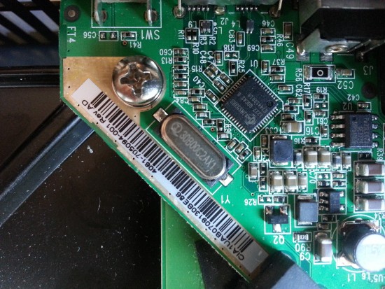

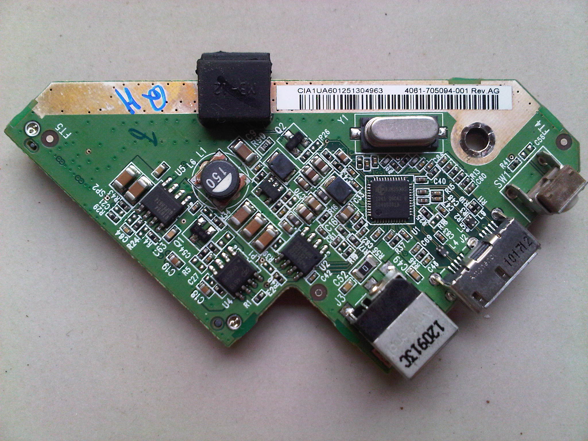

PostPosted: February 19th, 2014, 2:19
Joined: February 19th, 2014, 1:38
Location: Bandung, Indonesia
Hi guys,
I'm new here. I have problem with my Western Digital My Book external hard disk 3.0TB USB 3.0 + 2.0. I think it caused by unstable electricity.
The disk didn't spin & the LED light not blinking, but when I connect the hard disk with internal connection to my PC, it spinning, though I couldn't read the data.
1. Is this show that 4061-705094-001 Rev AG board inside the box was damaged?
2. Could it changed with a similar board like 4061-705094-001 Rev AD, AE, AA? A seller told me that 4061-705149-000 Rev AA have same shape & function. Which one should I choose?
3. I read forums form some website, that the disk encrypted by the board. Could I read the data after change the board or it only can be recovered by a software? If the board only for recover, could someone tell me step by step?
Thank you for your help, all.
Best regards,
Shane
PostPosted: February 19th, 2014, 16:15
Posts: 17137
@shineshane, a compatible replacement board should work.
That said, there may be an easier/cheaper solution. If you connect the board on its own (without the drive), does it show up in Device Manager or USBDeview or UVCView?
http://www.users.on.net/~fzabkar/USB_ID ... ew.x86.exe
http://www.nirsoft.net/utils/usb_devices_view.html

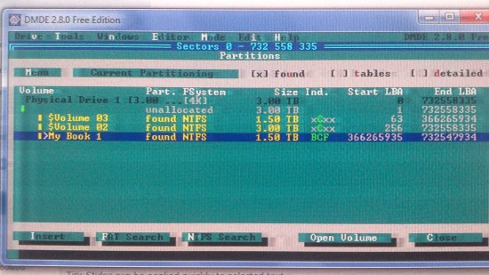

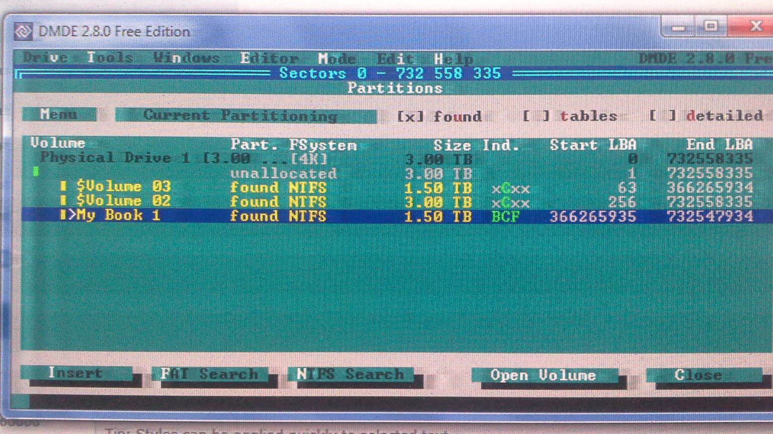

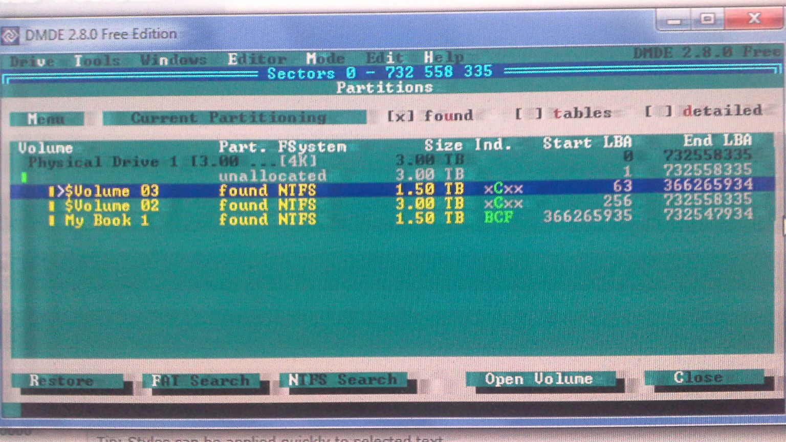

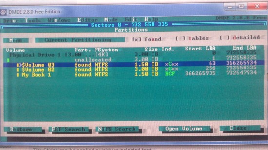

PostPosted: March 15th, 2014, 9:27
Hi fzabkar, thank you for your reply. I've bought the board with exactly same model. There's only one seller I found from USA.
I installed the board. The LED light works & seems the disk was spinning, but it still can't be read from Windows.
I divide the HD become two partitions before, My Book 1 (1.5TB) & My Book 2 (1.5TB).
I use DMDE & it detected that there's a volume My Book 1. It contains some of my file (not all of my files detected). And, there are two others volume didn't recognized, They are $Volume 03 (1.5TB, I think it's My Book 2) & $Volume 02 (3TB, I don't know what's this). Seems the My Book 2 volume was damaged or changed? There's Insert option for My Book 1 & there's Restore option for $Volume 03
I use low end PC. It maybe slow for recovery process or else. Would you tell me what's best software to recover data of my hard disk & how's overall process, step by step.
Thank you very much for your help.
Best regards,
Shane
PostPosted: March 15th, 2014, 16:24
Posts: 17137
@Shane, it appears that your drive was originally partitioned with a single 3TB NTFS partition beginning at sector 256 and ending on sector 732558335.
You subsequently repartitioned the drive with two 1.5TB NTFS partitions, as follows:
partition #1 -- sectors 63 to 366265934
partition #2 -- sectors 366265935 to 732547934
The second partition (My Book 1) appears to be intact. DMDE has found the boot sector (B) at the beginning of the partition and the copy of the boot sector (C) at the end. DMDE has also found the partition's file/folder structure (F).
The first partition, however, appears to be damaged in some way. DMDE has found a copy of the boot sector at the end of the partition, but sector 63 appears to be corrupt. AFAICT DMDE has been unable to find a folder structure. Did you initialise the drive when you had it outside its enclosure, and did you format it?
Can you show us the contents of sectors 0, 63, and 366265934?
