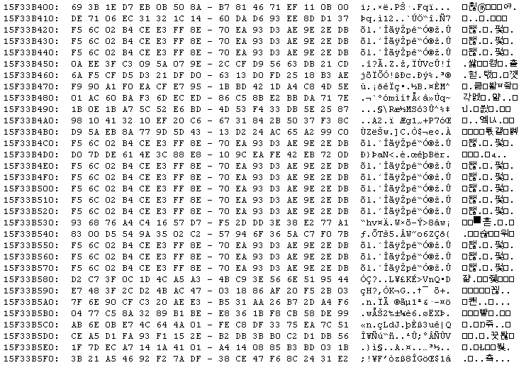

 Post subject: These Buffalo/Samsungs are encrypted
PostPosted: November 7th, 2012, 7:27
Posts: 248
just so you know..

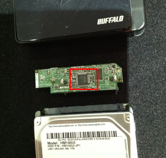

Don't think so, whats the number on that Inito?
Have you checked data straight through the sata?
http://www.rescue-it.se

^^^ this does make sense
initio is 1607E

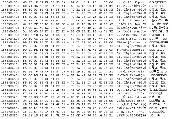

Could you post the sector 63?
 Post subject: Re: These Buffalo/Samsungs are encrypted
PostPosted: November 7th, 2012, 10:18
Posts: 248
I have all the data by the way. thats not an issue
all zeros
PostPosted: November 7th, 2012, 15:36
Posts: 17249
Some bridge firmware is configured with 4KB LBAs so you would need to multiply the sector numbers by 8 when you connect directly via SATA and expose the drive's 512e LBAs.
Also, I believe that the reason you are seeing zeros in sector 63 (via SATA) is that the drive would have been zero filled before being installed inside the enclosure at manufacturing time.
PostPosted: November 8th, 2012, 13:21
Posts: 2984
Or it could be that Boot Sector is at 2048 and not 63
Also
buster80 wrote:
initio is 1607E
This bridge makes hardware encryption, regardless of software installed.

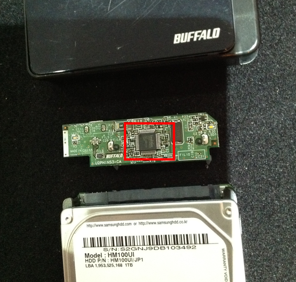

Had a HP Storage device in yesterday.
Little USB thing very much like buster80's
WD 320Gb HDD in with an Initio 1607E bridge board.
WAS encrypted

buster80 wrote:
just so you know..
This Buffallo is ENCRYPTED (with password)
Comes with: Samsung/Seagate/WD i`ve seen all of them
and the way it works is totally Diff. than the WD Smartware.
good luck
