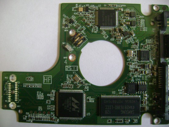

Here isa pic of your board from pcb-hdd.com http://pcb-hdd.com/images/WD10TMVW-11ZS ... c7fd9bbab9
They also have them in stock http://pcb-hdd.com/wd10tmvw-11zsms5-206 ... -1112.html
Remember that DIY has risks & limits & is depended on correct diagnosis

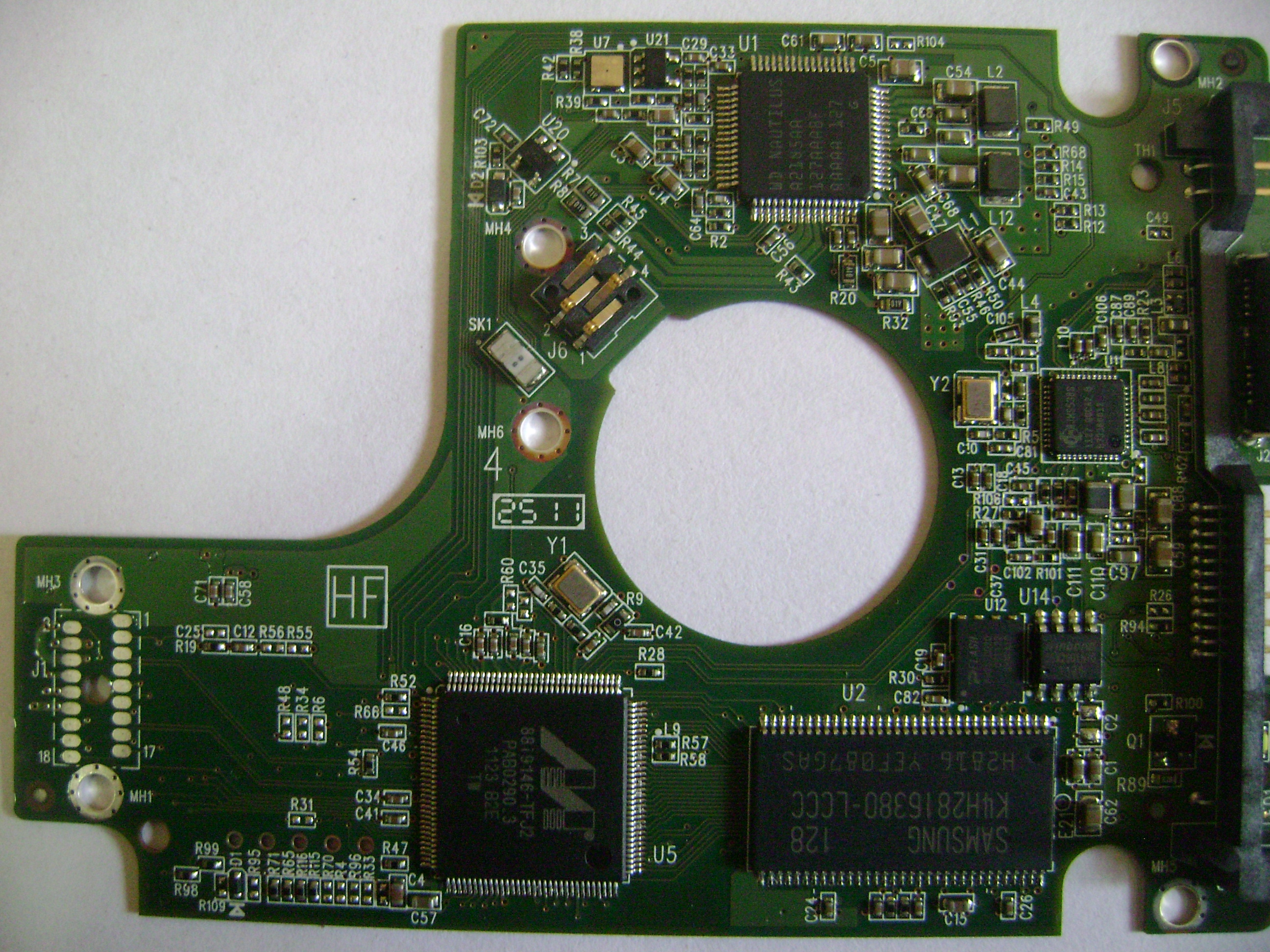

Guys,
Thanks for your replies. I'll scan my PCB today to see any burn marks.
I'll post images of PCB soon.
 Post subject: Re: WD My passport essential SE not detecting after power su
PostPosted: November 11th, 2012, 6:21
Joined: November 9th, 2012, 13:41
Posts: 11
Location: Mumbai, India
Hi Guys,
No burn marks found on the PCB. Attached the snaps.
I guess PCB swap won't help.
Any suggestions????
PostPosted: November 11th, 2012, 7:10
Either you don't understand or don't want to listen.... or maybe what you heard is not what you wanted to hear, who knows....
I give up, anyway.
PostPosted: November 11th, 2012, 7:49
Anzar412 wrote:
Hi Guys,
Any suggestions????
You have already been told it wasn't the PCB.
You have also already been told the likely problem and it's not DIY.
There is nothing YOU can do, you do not have the (expensive) equipment.
