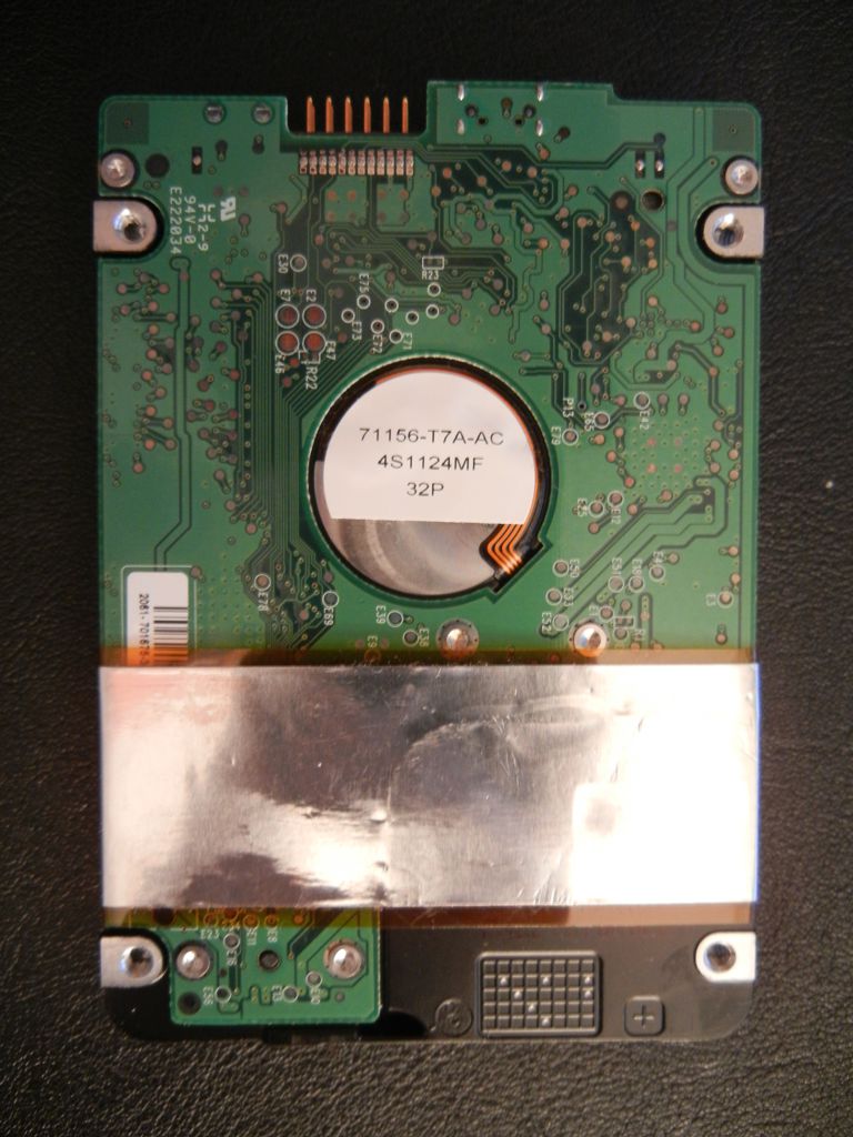

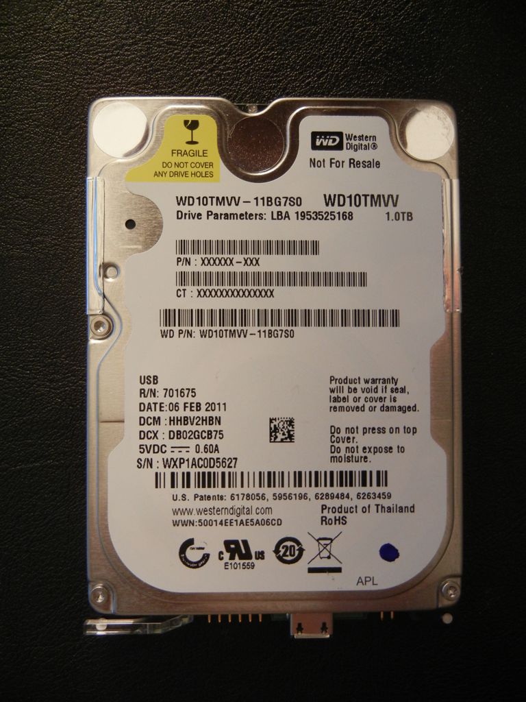

I have a friend of a friend who approached me with a faulty WD10TMVV from an external USB Passport drive. The drive is a backup of a backup, and her only copy of company data.

Now their last backup, this irritating little WD Passport has stopped responding. At first I thought it was the USB connector, but swapping out a different cable seemed to fix those inconsistencies. The hard drive that spins up, but when it settles down, the drive LED just blinks, two seconds on, two seconds off, with a "USB Device Not Recognized" error. The drive is not spinning at this point. If I unplug and reconnect the drive, it does this every single time, consistently the same each time.

If it spins up,and then spins down again, it's not the PCB :-(
Something more serious internally.

Good intentions notwithstanding, this is unfortunately not going to be DIY-able.

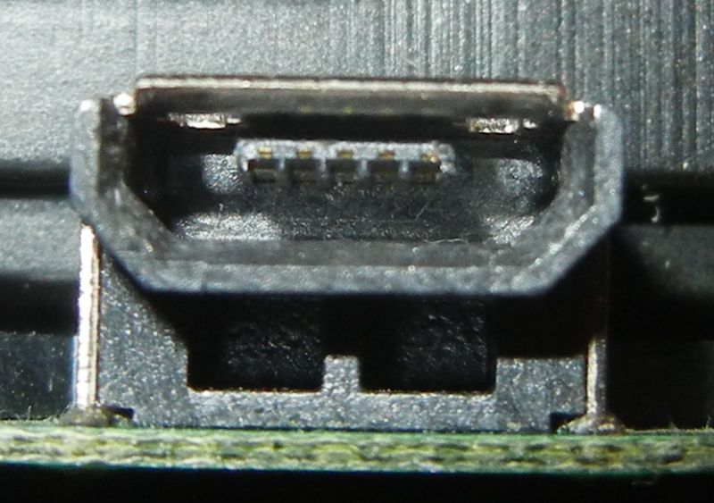

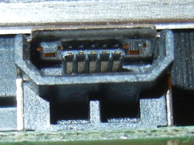

Look closely at the USB pins in the back of the connector that connect to the PCB. Sometimes, the connections are loosened and/or the solder is broken.
This is the easiest thing to check. If that is the problem, then a solder reflow should take care of it. Just make sure you make a copy of the data to a regular drive if you will be able to access it.
Regarding recovery price by an experienced tech, if the problem is internal, it will be over $1000. The price for a donor is over $200. Sometimes, multiple parts are needed, so I think you get the idea.

Our flat rate on this is $749. We can do the warranty exchange if it's still covered.
