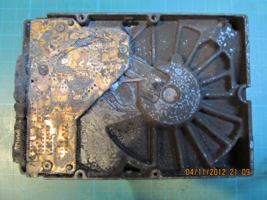

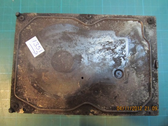

I got this funny case here (2 hdd`s in fact) burned office
based on those 2 images guys, what would be your Min. charge for such a case?
it is a WD, without even opening it, i can guess 2H or max 4H (but doubt it)
Model/Size Unknown
Series comments welcome guys....
thnx

HDD Model : WD1600AAJS- xxPRAx
or PSA
PCB# : 701444

Could also be a 250gb Yosimite series with pcb 1537 .

no ramez 1573 is not that shape , have another look
i agree with Ahmed if he want to say wd160AABS -xxPRAx

Einstein9, if the magnets inside dont have any attraction any more, then its game over. Check it first.
If temperature inside gets over curiepoint, magnetic fields disappear. Data gone.
I had some cases like that.
Minimum price would be 1500$ - 2000$ depending on number of platters etc ...

Thnx Dobre, but as far as i can see from outside and also the condition of the hdd here
i can guess that this task needs Platter moving to another donor set
after Mass Cleaning, i Quoted my client and waiting for his reply (something close to what you offered)

1 platter

@tawfeek_mokhtar,
WDC WD2500AAJS-00VTA0
This hdd uses 1537 pcb and its shape is like 1444 hdd .
Family is Yosemite .
This model is rare maybe thats why you dont know about it .

Hi Rameez, it's not 1537...it's a lot like 701444

To end up all doubts, it must be one of those :
1- 80GB ( PRA, PSA ) 1H. 701444
2- 160GB ( PRA, PSA ) 2H. 701444
3- 250GB (VTA, ....etc ) 2H. 701537.
