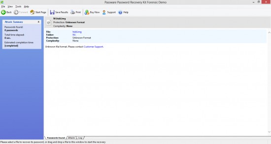

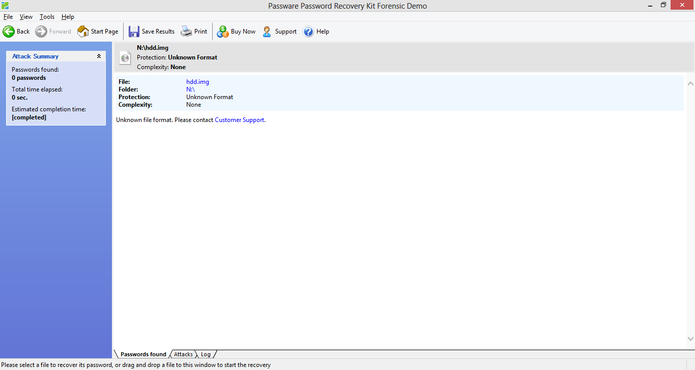

i tried to get the PasswareKit Forensic Demo , i've cloned the drive to file using"Free EASIS Cloning" saved as file (hdd.img)
on the PasswareKit Forensic Demo, when tried "Decrypt a TrueCrypt Volume " i got Unknown Format

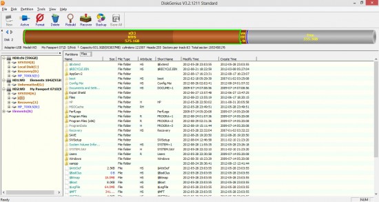

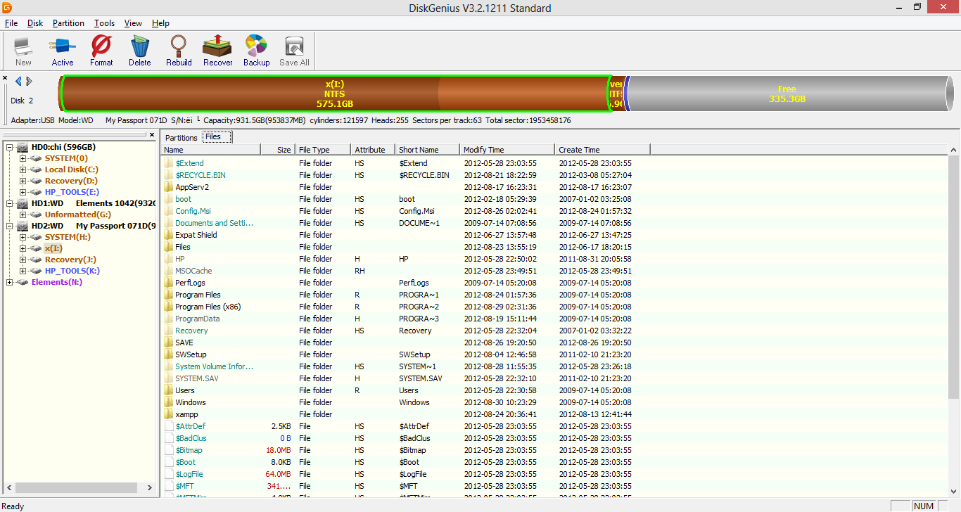

i tried to open the Partition using DiskGenius program ... i was able to see some of the files, but a lot of files are missing ! ...

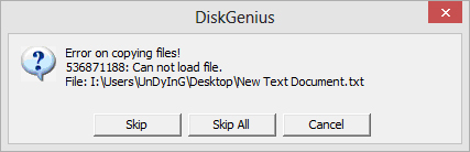

I tried to save some files ... in most times it did not success.

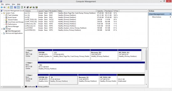

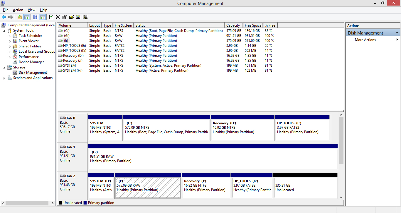

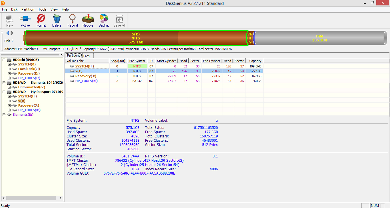

in the attachments you can find some more screen shots
Thanks a lot

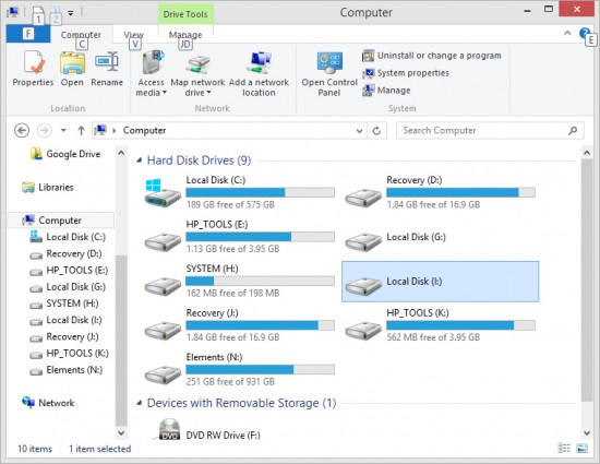

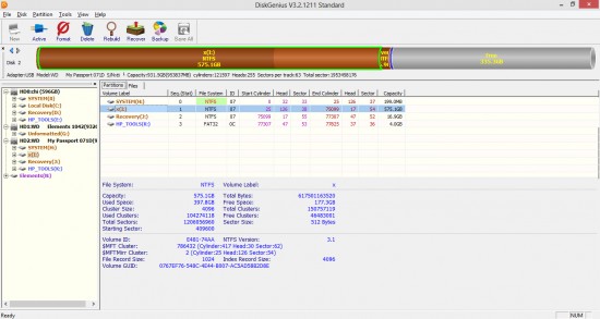

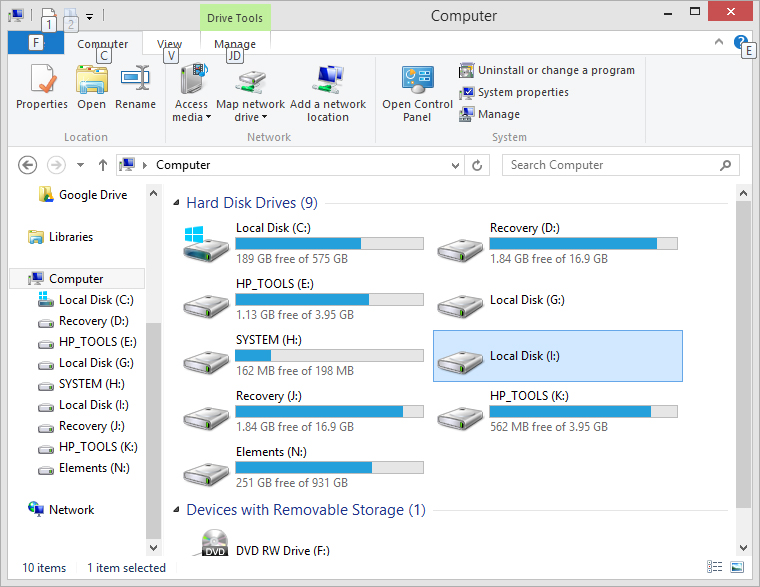

Was it half encrypted or half decrypted volume?
If it was half decrypted volume then you probably need to use backup copy of TrueCrypt header to unlock your volume because the first copy would have been decrypted
Please see this document for technical details - http://www.truecrypt.org/docs/?s=volume ... cification
About backup header (search for "Use backup header embedded in volume if available") - http://www.truecrypt.org/docs/?s=mounti ... pt-volumes
Always have original copy of the volume before applying any changes (i.e. make copy of a copy before trying anything)
If you able to mount your volume with TrueCrypt using back up header/restoring original header you would also need to deal with another complication
Because you have half way decrypted or encrypted volume you would need to know exact point where your decrypted data ends and encrypted starts. You would need to make decrypted copy of encrypted part of your volume using TrueCryt and after that concatenate that decrypted part with already decrypted data that you have now and after that you would get fully decrypted volume
If both TrueCrypt headers are gone - your data is virtually unrecoverable. If you are not sure about where to find those headers and how to mount the volume - look for professional DR help
