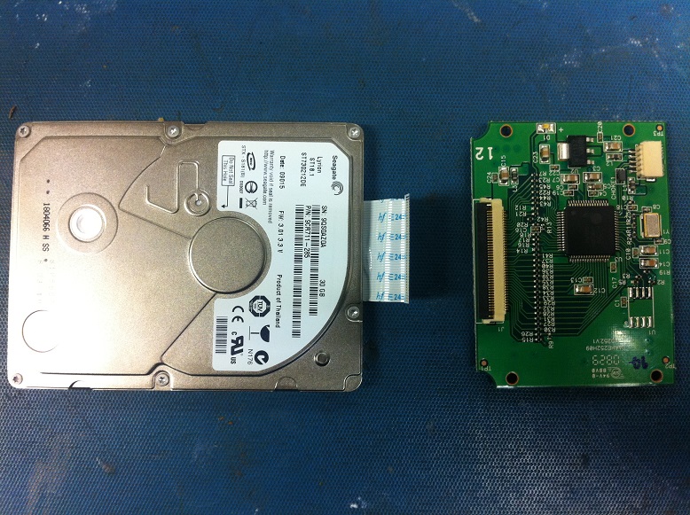

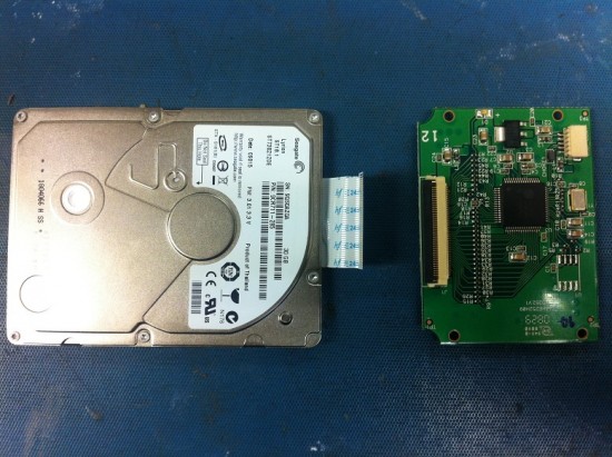

I am looking for the pinouts for the above drive.
I have been given the drive with no USB connector at all :D
Any help would be greatly appreciated!
Cheers in advance guys.
Ritch50

Thats a ZIF socket, Contact PcImage here in the forum he can help you...he's located in Peterborough.

its the other socket im looking for - at the right side 5 pins. :)

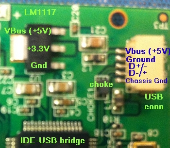

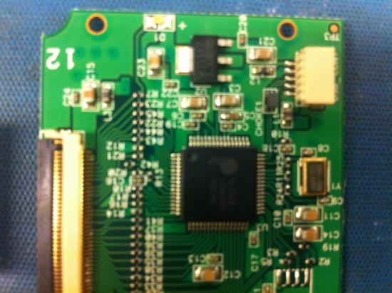

Standard USB uses 4 pins
1) VCC
2) D-
3) D+
4) Gnd
In your pic, D- and D+ goes to the Choke1,(find vcc and follow the order)
Use a multimeter to find out Gnd and VCC in L1 and L2
(L1 seems to be vcc, check if L2 is Gnd)
The fifth pin may be ID.
Recheck again before you plug it to USB port.
Better still, connect only the pcb( without the HDD) and check,
and connect the HDD later.
If you are not sure,on this case, take help from pcimage as suggested by mr_spokk

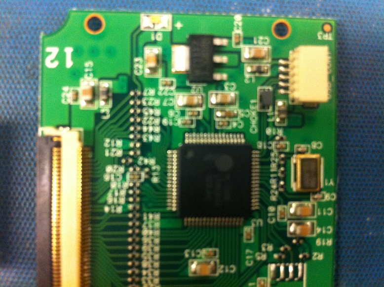

Good approach, sathyan :good: although my opinion on the pinout is slightly different to yours. If we had a clear photo, it would be easier, wouldn't it :)
So this could be wrong, due to the detail obscured by the fuzziness of the photo, but my opinion (based on that regulator, U2, likely being the typical LM1117 or equivalent) is that listing from the top of the connector in the photo, the pins are:
Vbus
Gnd
D+ or -
D+ or -
Cable shield

In that case L2 is Vbus and L1 should show Gnd(Check with multimeter and confirm).
And D- and D+ to be found by trial and error (two combinations)
@ ritch50
Always , verify again , Vbus and Gnd, as Vulcan suggested,
it shouldn't be difficult,
Be sure Before plugging it in USB port.
@ Vulcan
Thanks :)

My take on Vulcan's and sathyan's discussion is ...
If you can identify the markings on the bridge IC, then we may be able to identify the order of Data+ and Data-.
