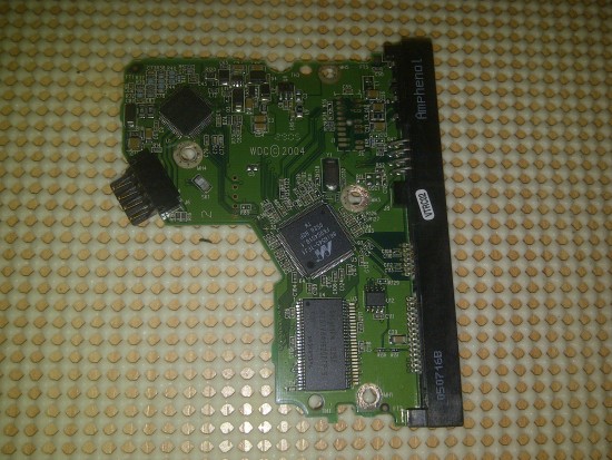

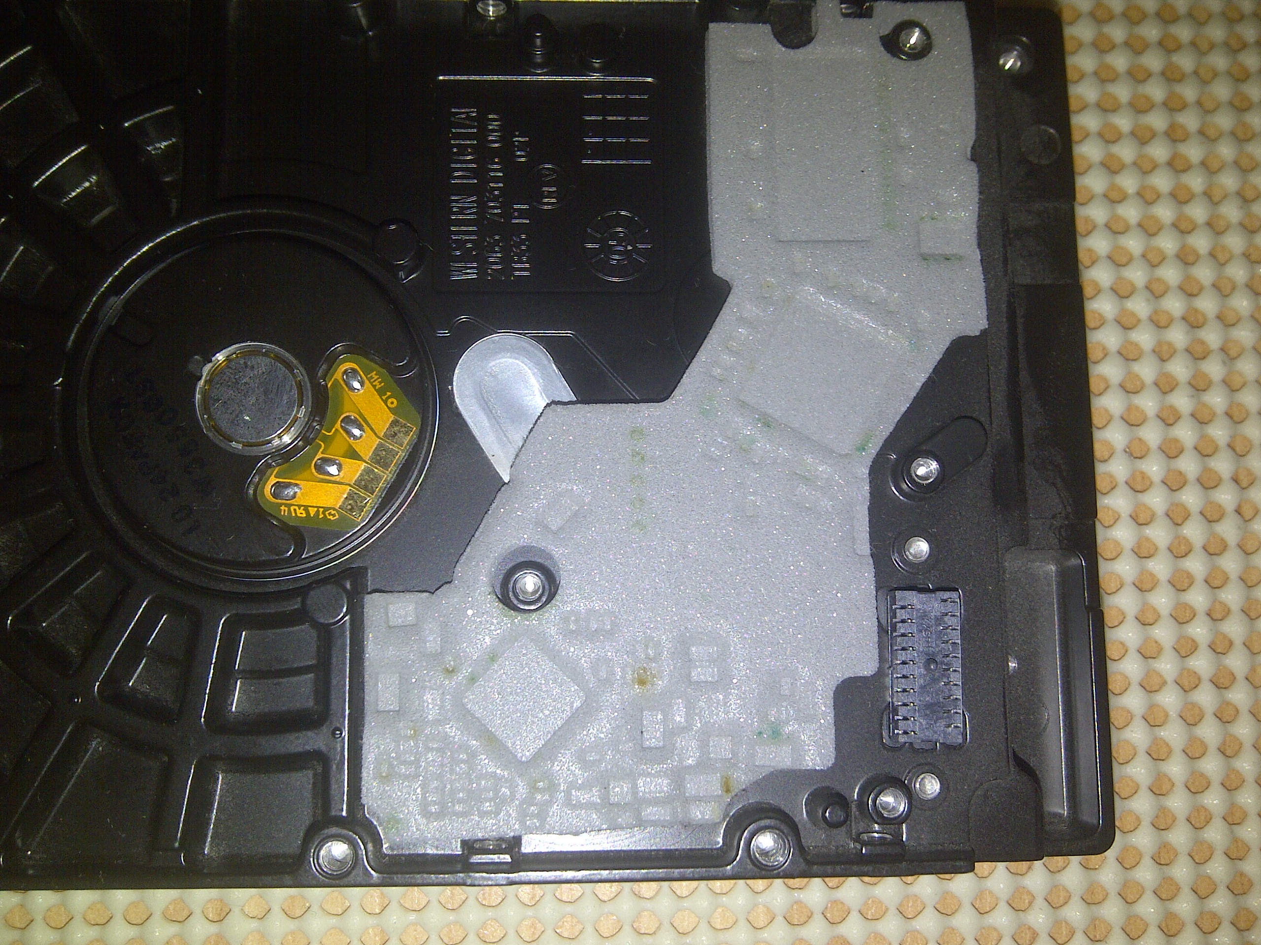

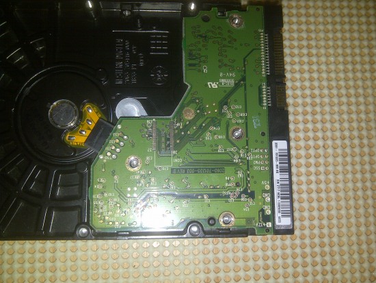

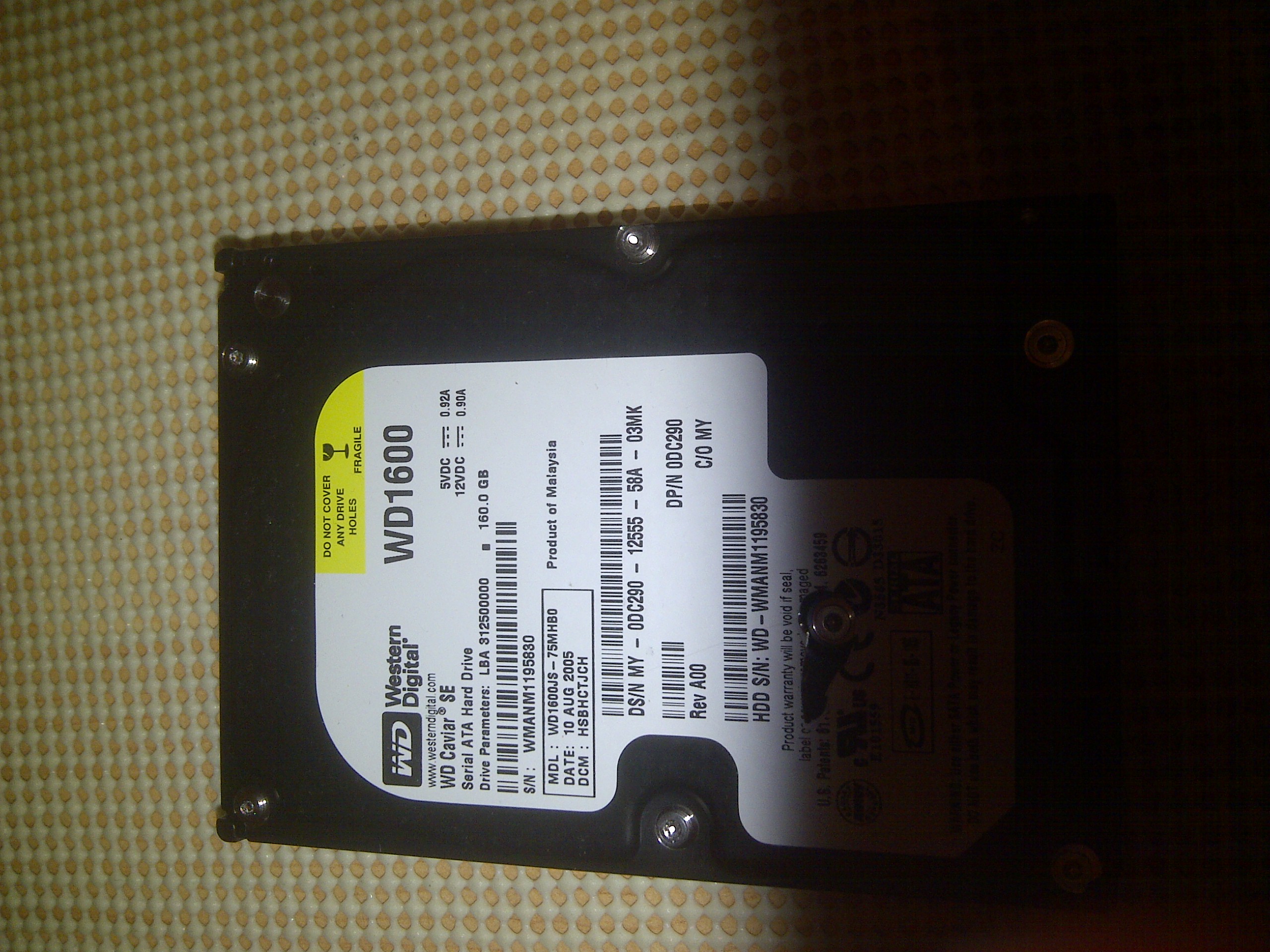

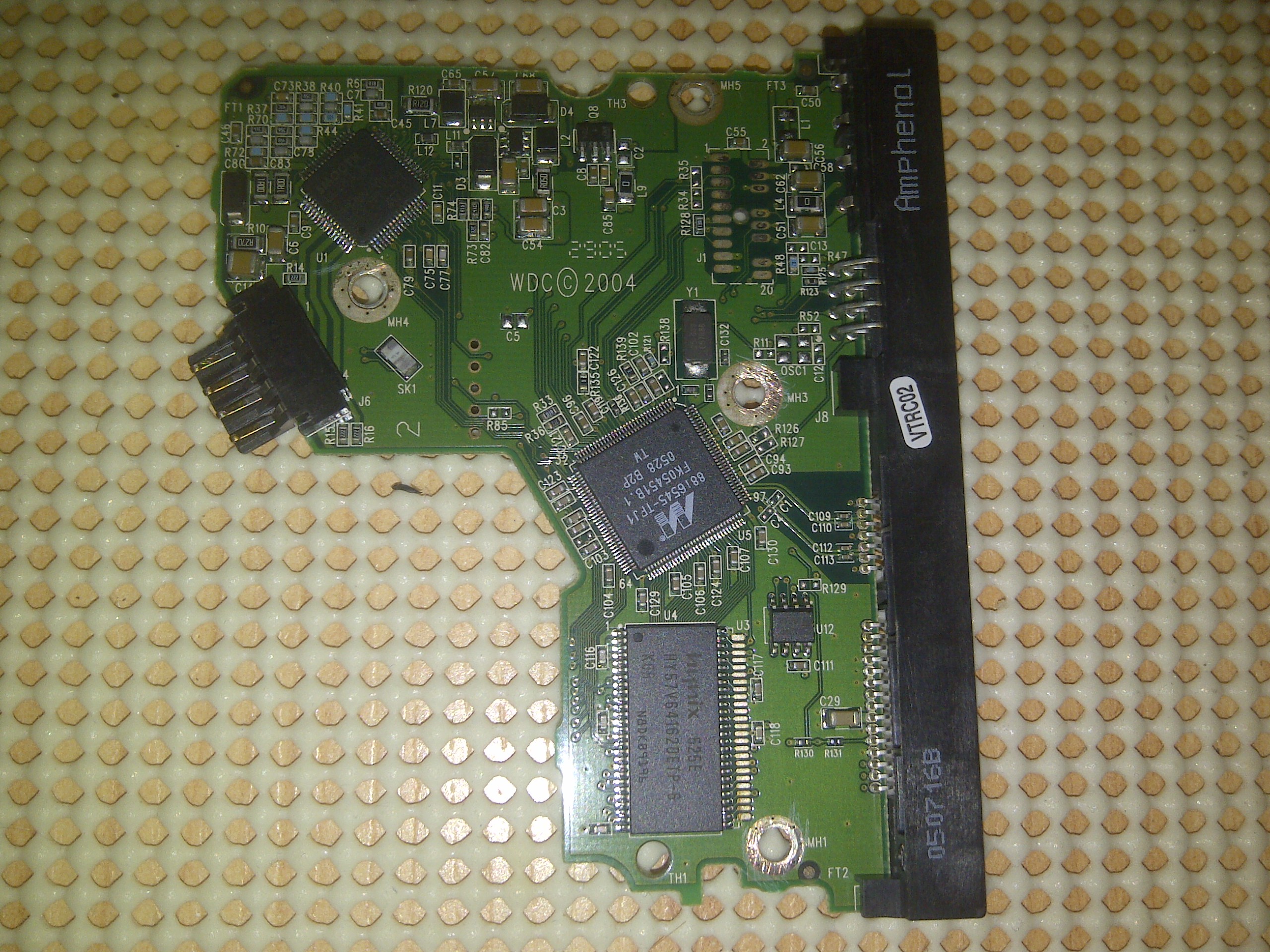

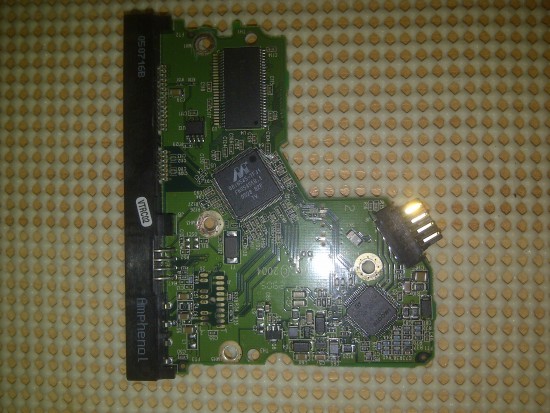

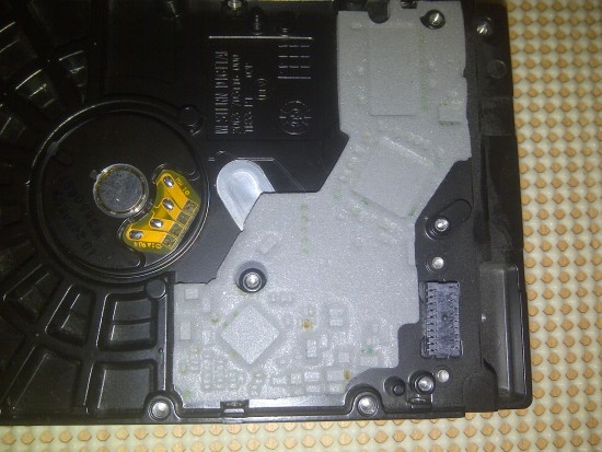

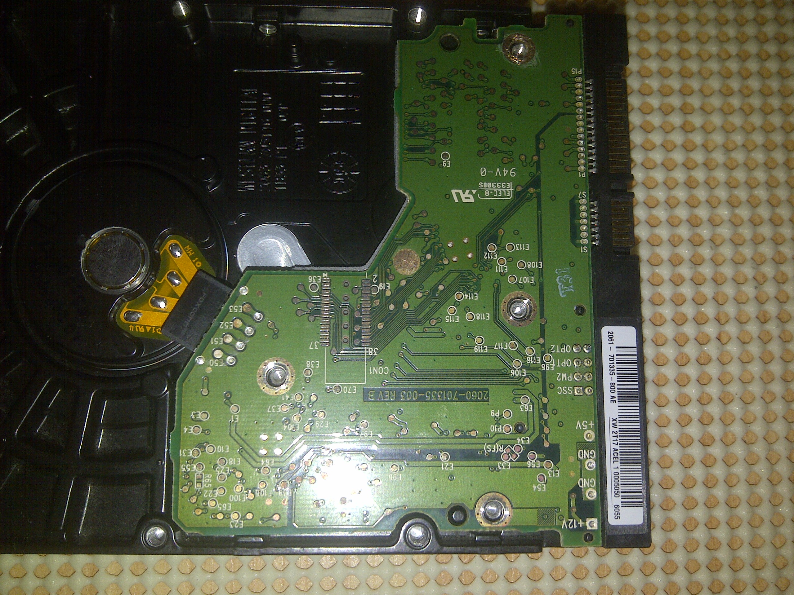

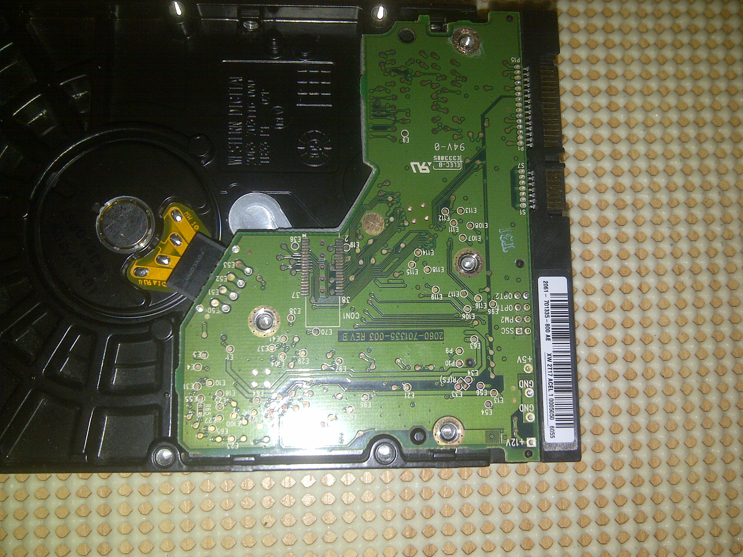

Hello everyone,

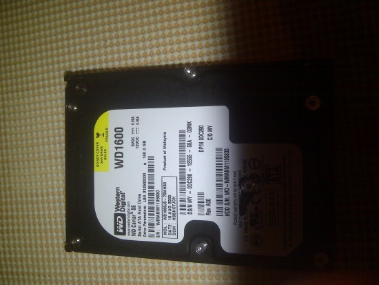

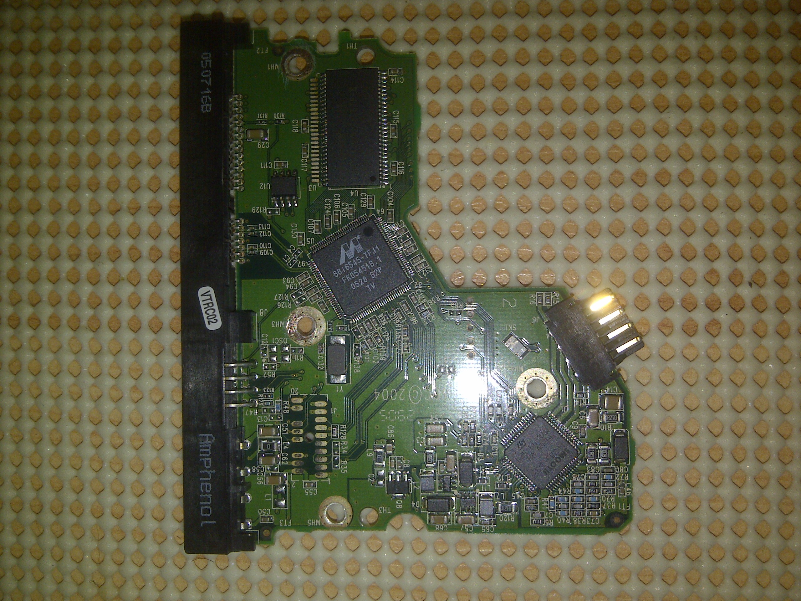

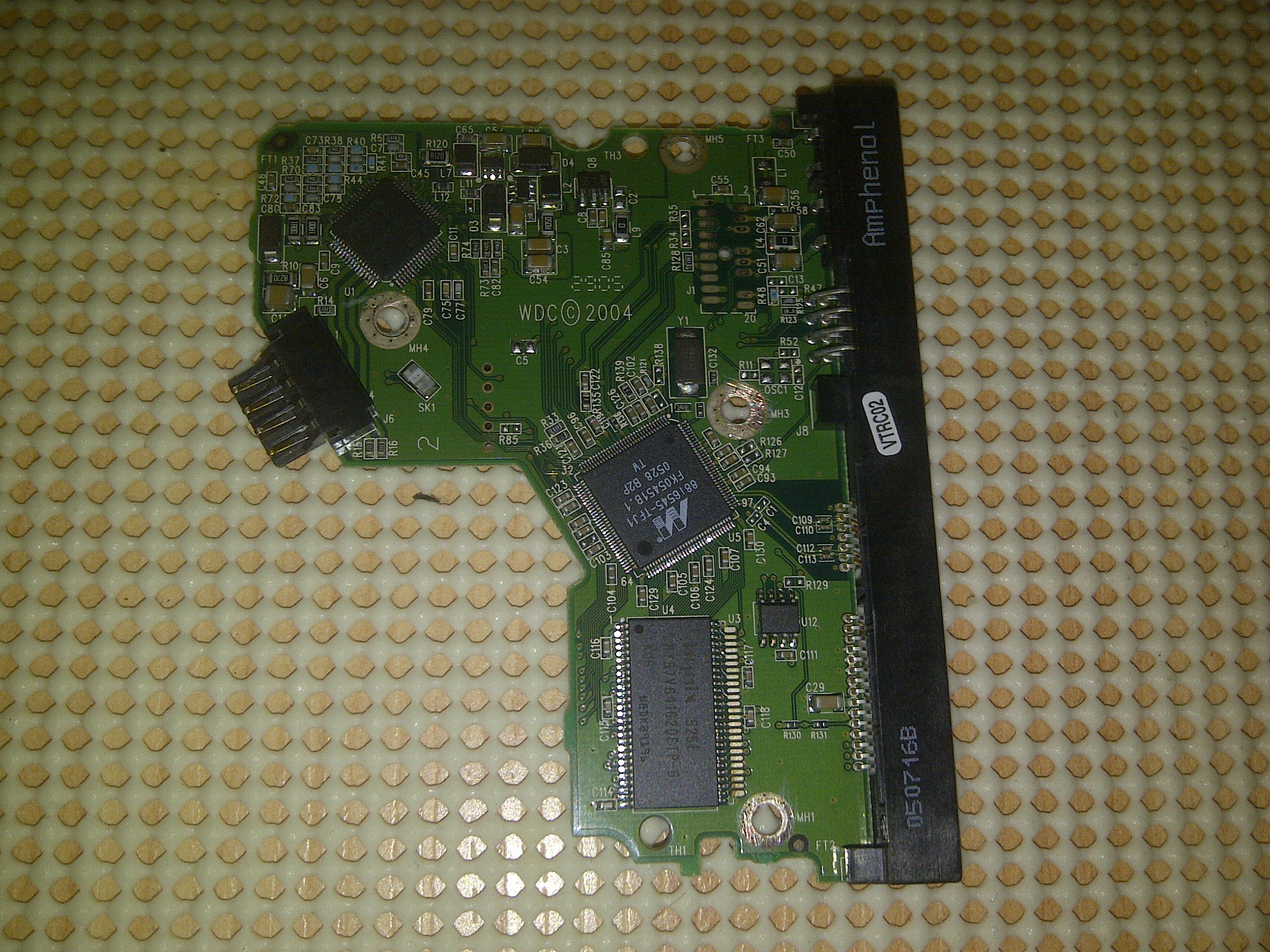

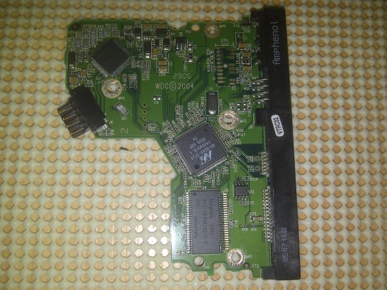

My computer was working fine then all of a sudden my computer started working slow and slower then it ever has then I couldn't get it to do a disk defragment. so I decided I would reboot it, to my avail it would not reboot, it also makes a loud clicking noise, amy ideas what this could be the pcb was very dusty. Heres the hard drive info and i'll attach pictures
It's a Western Digital 160 GB Hard Drive
WD Caviar SE
Drive Parameters: LBA 312500000
S/N: WMANM1195830
MDL: WD1600JS-75MHB0
DATE: 10 AUG 2005
DCM: HSBHCTJCH
Then under the bar codes:
DS/N MY-0DC290-12555-58A-03MK
DP/N 0DC290
Rev A00 C/0 MY
HDD S/N: WD-WMANM1195830
and the PCB board has:
on sticker: 2061-701335-800AE
on board: 2060-701335-003 REV B
Thanks in advance I wpould like to recover these files if possible.

 Post subject: Re: Hard drive stopped working,
PostPosted: December 3rd, 2012, 20:05
Likely mechanical issue. Not an easy model drive to recover. Not DIY.
Highly recommend to no longer power on.
PostPosted: December 3rd, 2012, 23:03
Posts: 17368
Try cleaning the preamp contacts at J1 by gently rubbing them with a soft white pencil eraser. You might be lucky ...
PostPosted: December 3rd, 2012, 23:07
Internal mechanism responsible for reading and writing of data.
PCB is unlikely in my opinion. Nothing in your description indicates that PCB could have gotten damaged.
Data can be recovered, however it depends on the extent of damage. If the drive has not been tampered much with, chances for a professional to recover the data are high. Someone without experience, realistically, close to 0% chance.

These boards do mimics.
PostPosted: December 4th, 2012, 3:59
Yes, you're right.
Occasionally these PCBs mimic a head fault, worth a shot to change the PCB.
First off, get a PCB of the same model (as close as possible) and try it.
If it spins up,and stays spinning with no clicking (you wont get ID or detect properly in bios at this stage because the ROM version does not match the firmware on the platters) then great, go ahead and swap over the U12 ROM chip and you should be good to go.

The following PCB suppliers offer a firmware transfer service, either for free, or for US$10:
http://www.donordrives.com
http://www.onepcbsolution.com
http://www.hdd-parts.com
Alternatively, if you are not adept at soldering, your local TV/AV repair shop should be able to transfer the chip (U12) for you.
Onepcbsolution.com also offer a firmware transfer service for US$20 if you have purchased your board from a different supplier:
http://onepcbsolution.com/firmware-xfer ... t-pcb.html

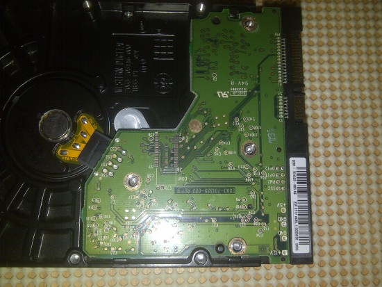

PostPosted: December 4th, 2012, 15:54
Joined: December 3rd, 2012, 17:58
Posts: 7
Location: Canada

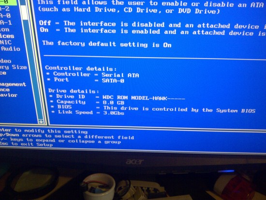

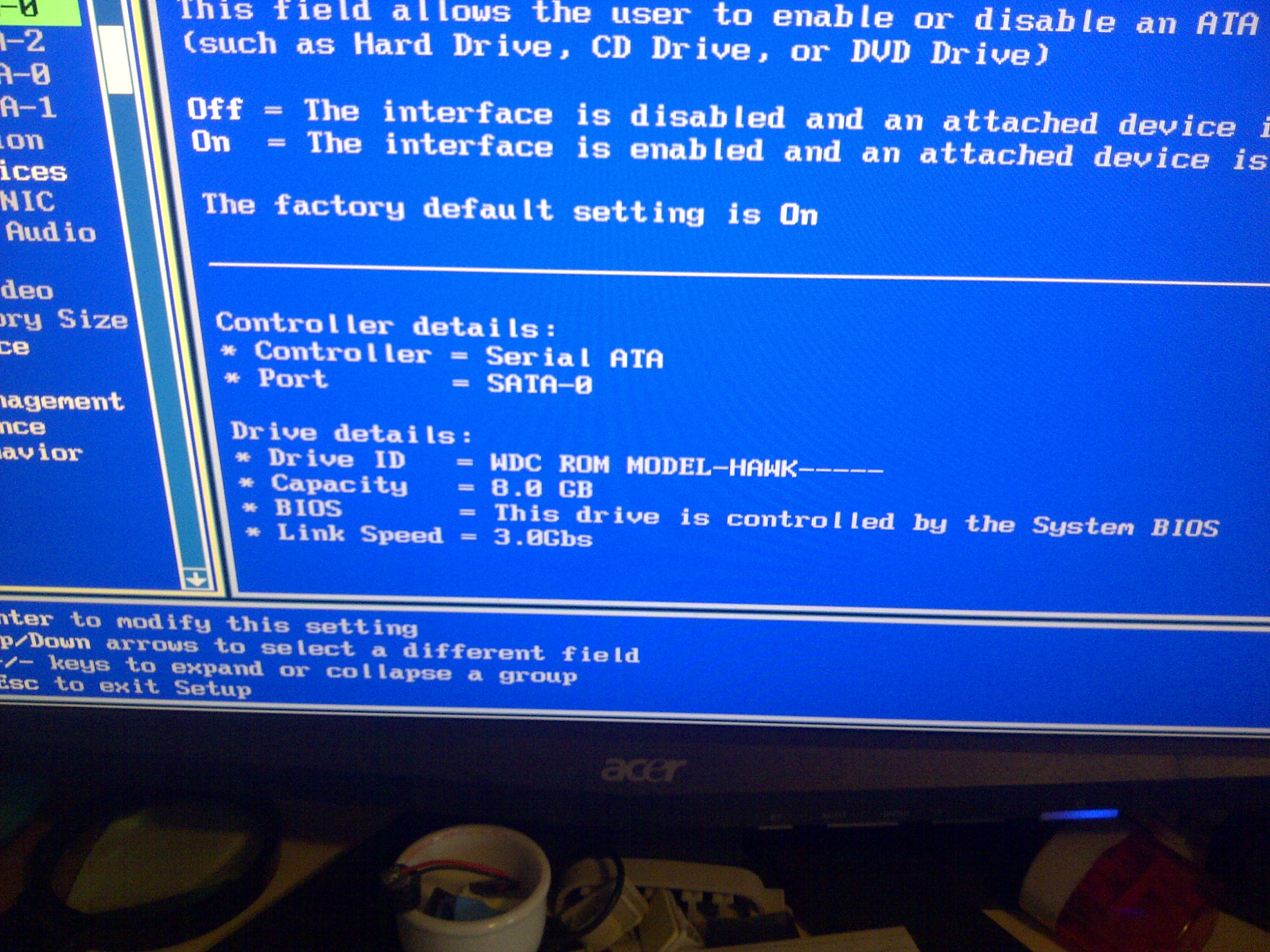

Hello thanks for all the help, I cleaned the contacts, tried it still no luck and makes the clicking sound, however in the bios it come sup the following. Anymore ideas? just in case I believe I found a identical hard drive only it was made on 07 JUL 2005 as opposed to 10 AUG 2005
thanks
PostPosted: December 4th, 2012, 16:31
Posts: 17368
If you wish to pursue the PCB swap, transfer the 8-pin chip at U12 from patient to donor.
Otherwise I know of a data recovery company that will do a relatively inexpensive head swap, assuming that's the only problem.

WDC ROM MODEL-HAWK
You can try to swap the ROM !

In my opinion a 0 MB recognized drive is not pcb related but at least fw or more (demages on platters) also i noticed a factory alias or similar text on the screeenshoot.

The recognition as factory alias "hawk" and capacity 7.85gb (his bios says 8gb) again tells us nothing, except that the drive cannot read the SA.
