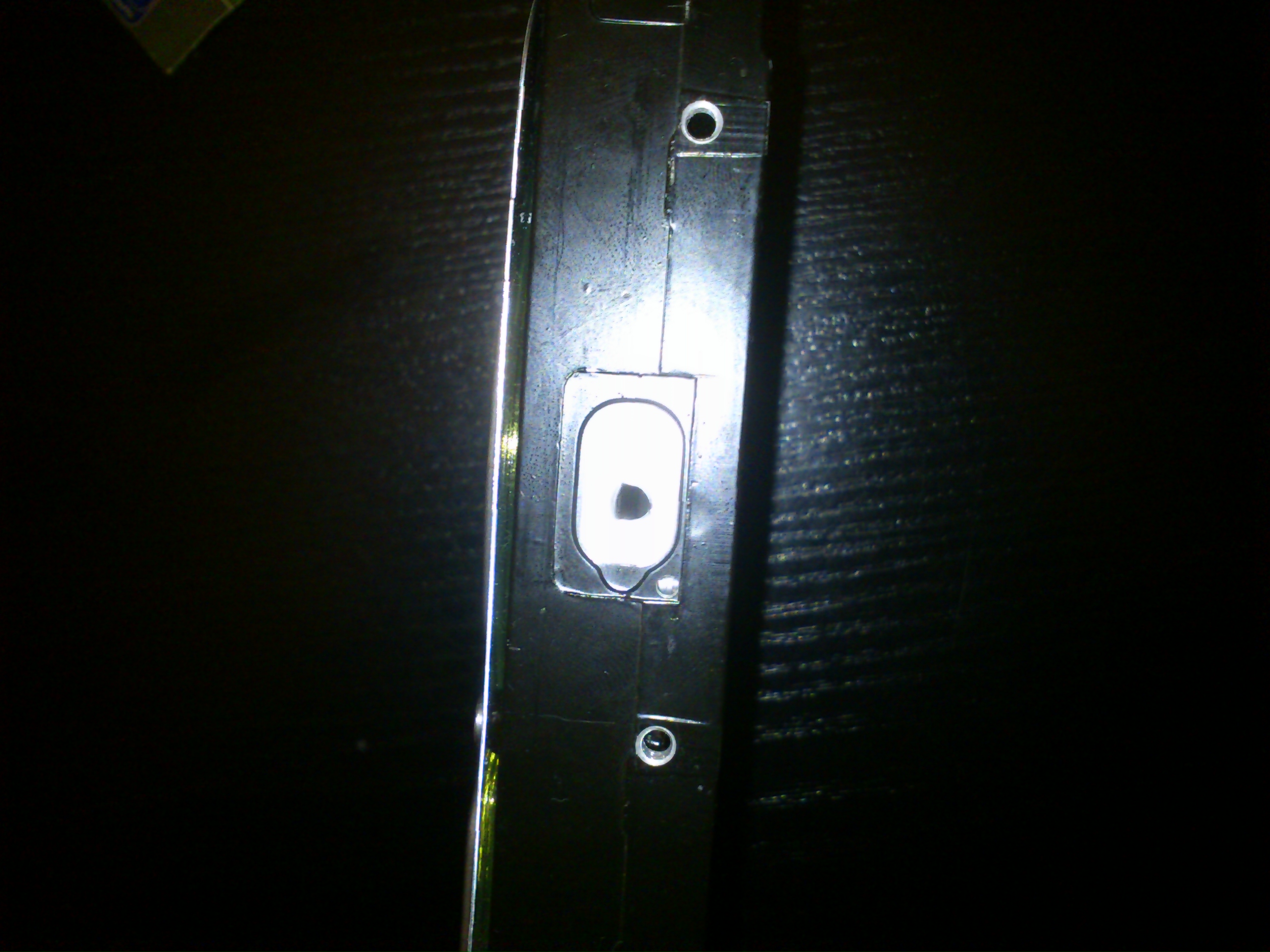

while i was trying to insert my drive in the drive bay the small aluminium foil(silver coating) on side of hardisk came of a bit...now i can see a small hole.
Does this mean my HDD will not be working anymore?

Dust is entering the HDA if not already sucked up if it was powered on. The risk is a unpredictable but possible head crash and data loss.
Not free solution but still cheap at the moment : contact someone who has cleanroom gear, they have to open the HDA, decontaminate, check media and heads and then clone with an HW imager on another disk. Safer and effective.

so i will need to buy a new hard disk?

I'm afraid YES.

You will have to buy another drive for use ,as this drive will be unreliable and will fail soon(if it has not failed yet).
If you have no valuable data in it, just trash it.
If you have important data , then you will have to take pro help.

@kimon, hard drives have a pillow shaped recirculation filter to capture airborne contaminants.
Here are two examples:
http://www.petervis.com/gallery/hard/Ha ... Filter.jpg
http://www.southbit.co.za/wp-content/up ... ilter1.jpg
If by some remote chance any particles have entered the hole in the casting, the drive's air turbulence will most likely sweep these contaminants into the filter. That's how it's supposed to work, anyway. I've heard stories from people who have opened their drives outside a cleanroom, powered them up, put the cover back on, and then continued to use them for years afterwards. I'm not saying to trust your drive completely, but if you perform a full format or zero-fill and then scan your drive without error, I would rest easier.
If by some POSSIBLE chance the whole thing doesn't work, drive / data is screwed.

well i tried connecting the HDD to my pc but the pc doesnt even detect my hard drive,even though i can hear it spinning
so i guess its not working at all anymore
should i try and open it on my own?

Why not? You can get a couple of great magnets for your troubles- but dont expect anything else out of it.

well i tried connecting the HDD to my pc but the pc doesnt even detect my hard drive,even though i can hear it spinning so i guess its not working at all anymore
Rewind ....
So, maybe the pillow shaped thing was on strike and the turbulence was not enough, maybe, so now the drive can rest in peace....
Bad idea to turn it on !
