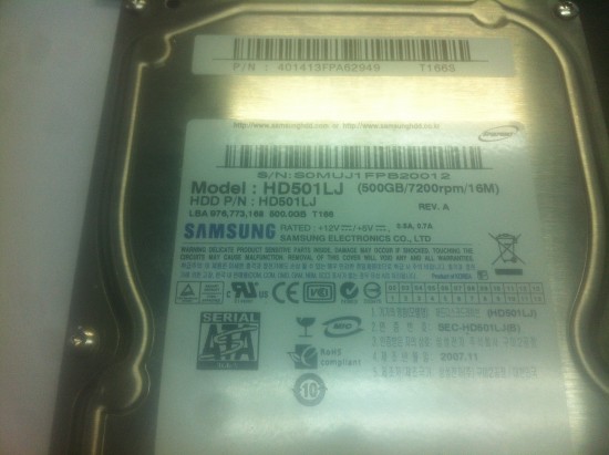

Also can say that there is no Firmware version line on hdd case. Here is the photo:

 Post subject: Re: Samsung hd501lj Spin UP and Spin down
PostPosted: December 1st, 2012, 19:32
90% of the time these drives do not have the fw version on the label, but sometimes they do (e.g, CR100-12) but that would do you no good anyway.
It's not a question of just "flashing" firmware like a mobile phone, it's a question of figuring out which module is damaged and fixing it WITH THE RIGHT TOOLS AND KNOWEDGE.
