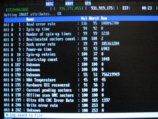

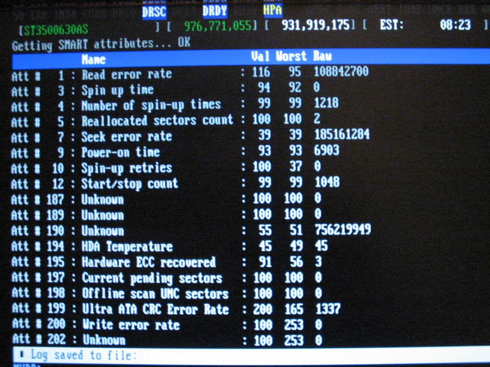

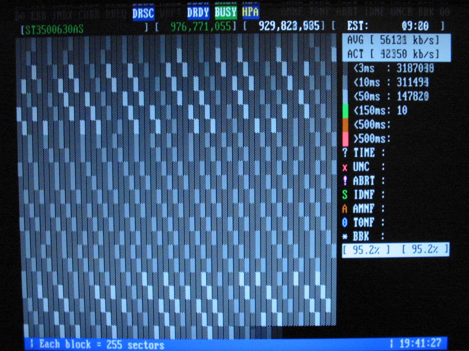

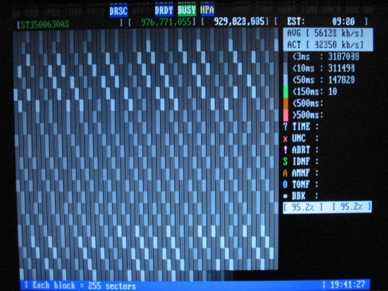

I need to know from you expert if my drive has some problem or not, look at this mhdd screenshots.
I want also to know what does it mean the HPA blu light on the top of mhdd screen.
Thanks.

Cutting the drive...
http://hddguru.com/software/2005.10.02- ... al.en.html

Thank you labtech, i did NHPA command in mhdd and now i have full capacity.
Now i will do the zero fill format. :wink:

@Friedrich, keep an eye on your Seek Error Rate. The normalised value is unusually low.
