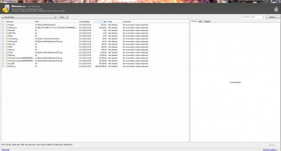

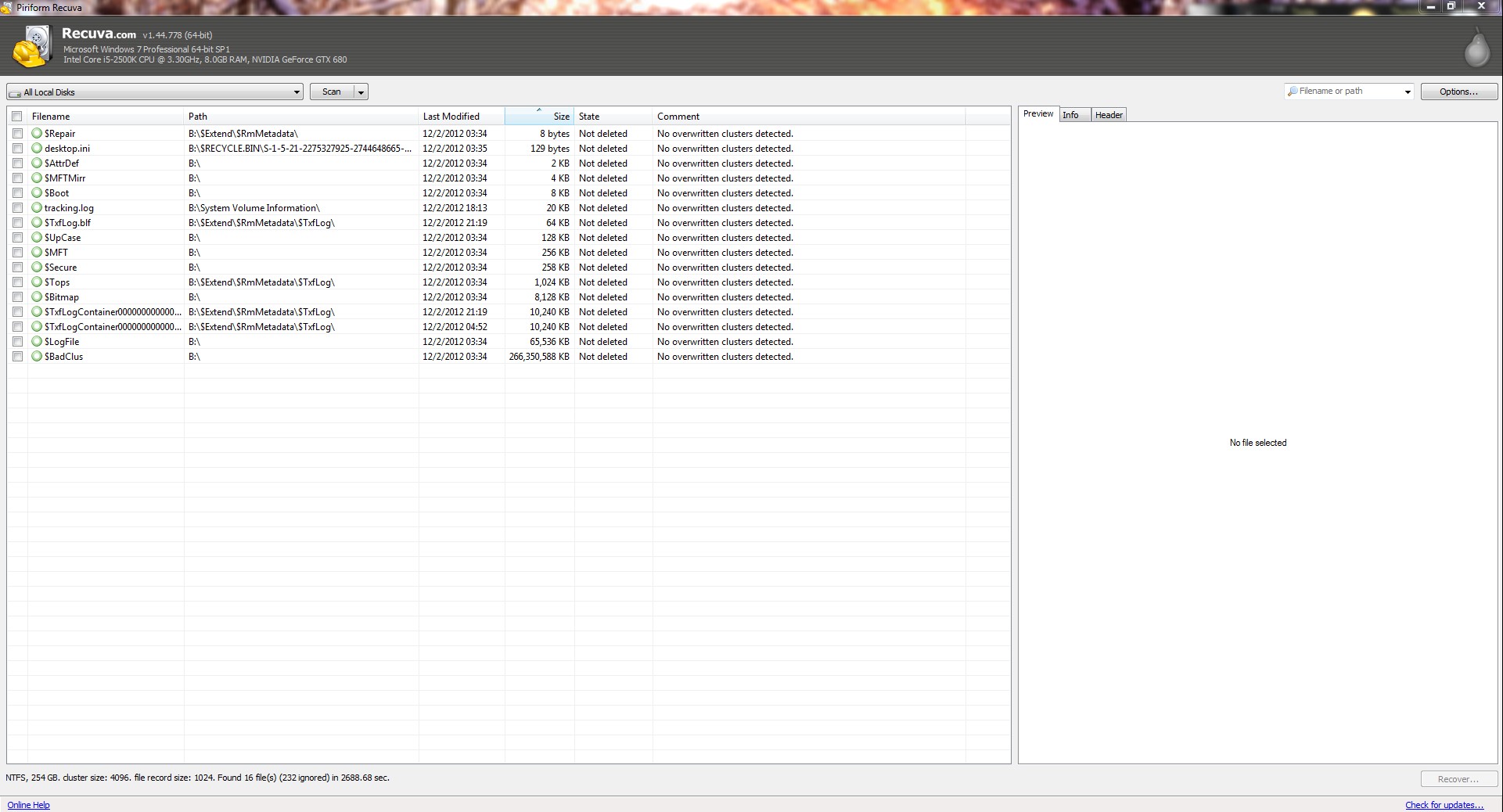

I just made my first attempt using the recuva, on the cloned disk. And the result is captured and attached below. I don't know what it means, but it looks like 254GB is bad cluster? What should I do now? Please help. If recuva fails, I am going to use one of your suggested software. I am just afraid that this is not the issue of recuva.
Many thanks!

p.s., i also just posted the result of Recuva deep scan just now.

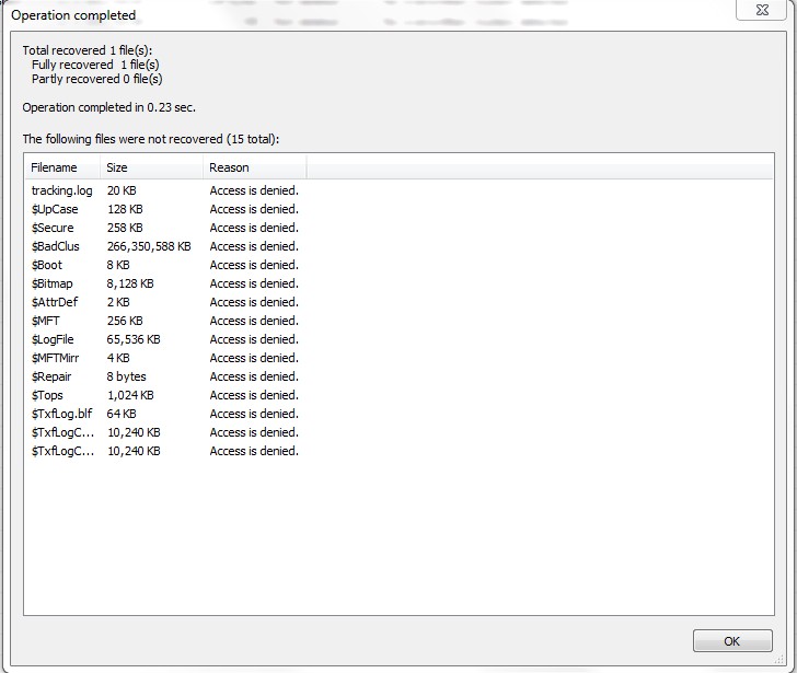

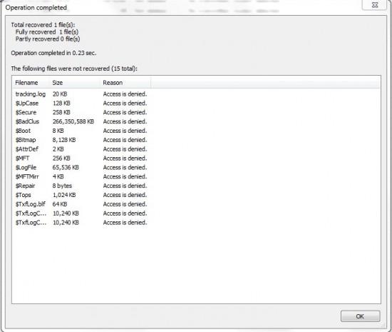

I then hit "recover" option, and chose a different external hard drive as the destination, and the results return as it shows in the attachment, saying all the access was denied :(
I am lost...
 Post subject: Re: Wicked Quick Format on WD 320GB Scorpion Black... Pls he
PostPosted: December 3rd, 2012, 12:55
Posts: 285
Try R-studio.
I Think the cloning has not happened properly.
(you can try ddrescue/ HDD raw copy)
Making a clone copy of the original drive and working with it is the best and safest way
for any recovery process. But as you dont have a proper clone copy and your original drive has only logical faults....
You can run good recovery tools (that don't write back to the same drive) on drives that are in good working condition and the problem is only logical(as is your case).
