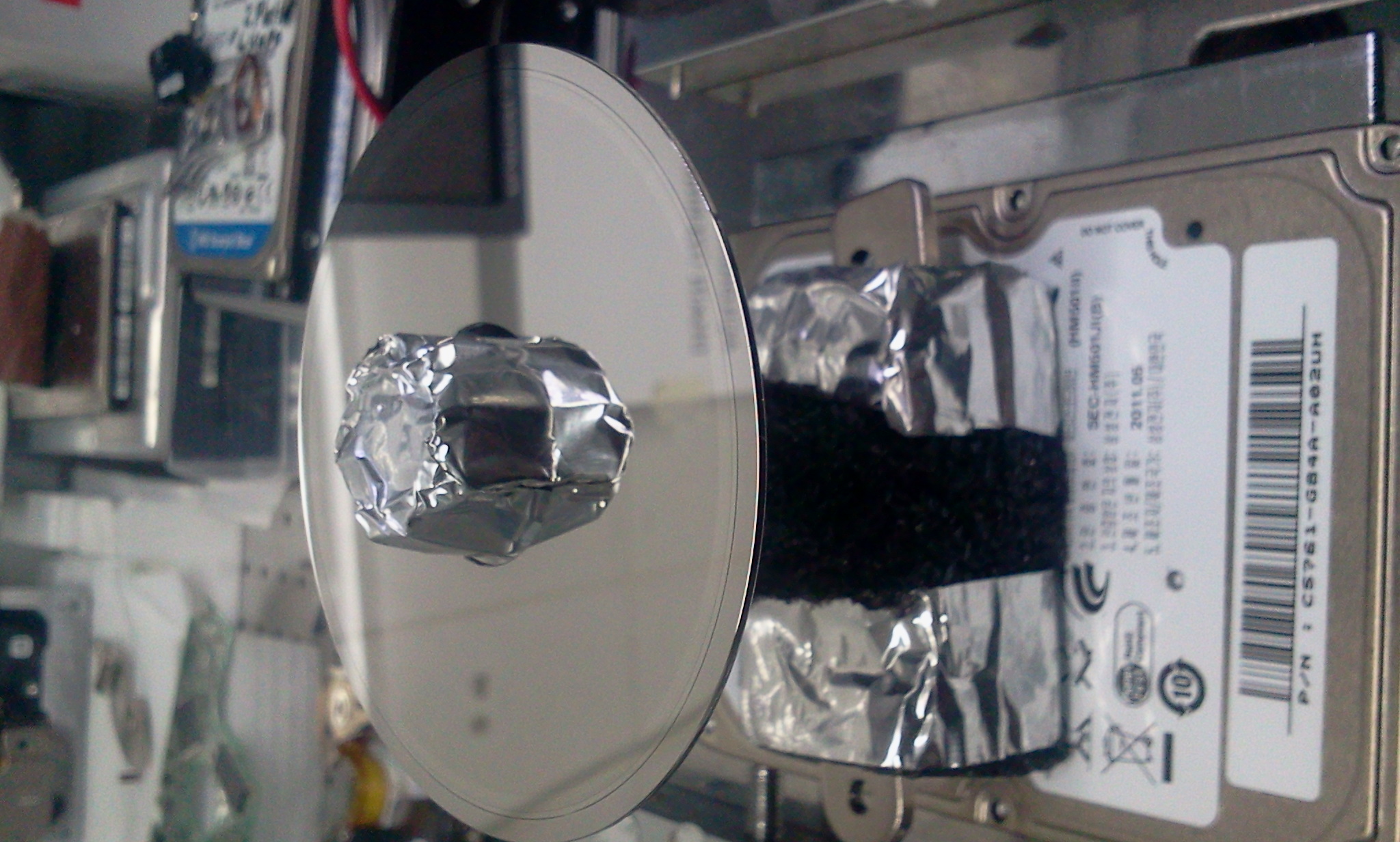

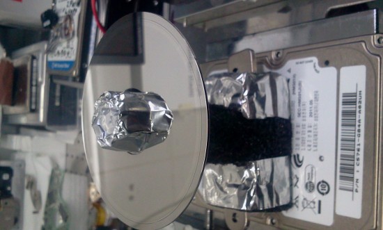

hi friends scratched disc how do I recover ?
Do you have that can help on this topic

What on earth is that?

Hard drve art?

Hard drive drum set!
