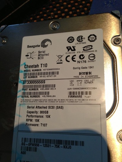

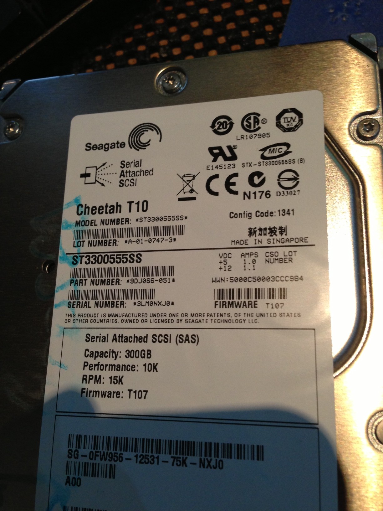

 Post subject: 300GB Seagate SAS ST3300555SS showing as 160MB at post
PostPosted: December 13th, 2012, 16:34
Posts: 248
any ideas?
thanks in advance
andy

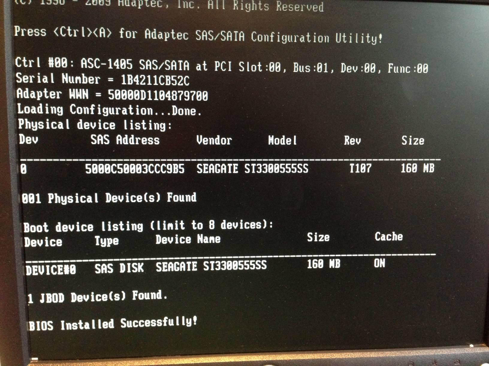

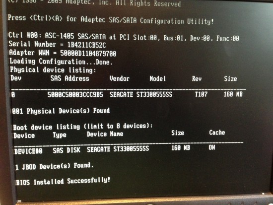

 Post subject: Re: 300GB Seagate SAS ST3300555SS showing as 160MB at post
PostPosted: December 14th, 2012, 7:49
Posts: 248
Could 160 be the connection speed? And maybe you mistakingly think it's the shown capacity?
These drives usually show either full capacity or capacity 0
Not an easy model to deal with
had a couple 0MB ones too, weird isnt it
will get a screenshot
thanks
andy
PostPosted: December 14th, 2012, 7:55
Posts: 248
screenshot
PostPosted: December 14th, 2012, 10:01
Posts: 3598
Location: Chicago
Very interesting
Thank you
PostPosted: December 14th, 2012, 11:04
Weird, indeed.
Usually it was a go/no go (0 MB).
