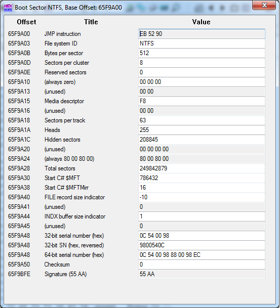

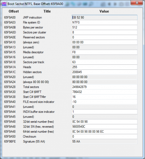

 Post subject: Re: Replacement HDD in Raid0 override current drive
PostPosted: December 20th, 2012, 6:58
Joined: July 7th, 2010, 4:45
Posts: 924
Using winhex & the formula: start of MFT x sectors per cluster + sectors before partiton you can work out the sector of the MFT
ie in my case as an example:
$MFT (786432 x 8 + 208845 = 6500301)
$MFTMirr (16 x 8 + 208845 = 208973)
As you can see the $MFTMirr is located before the $MFT so in your case the $MFTMirr has most like already been over written. Also the $MFTMirr is not a complete backup of the $MFT it is only the first 4 records.
As previously mentioned your by Luke & myself you will need to do a RAW recovery but you will lose the file names & folder structure.
