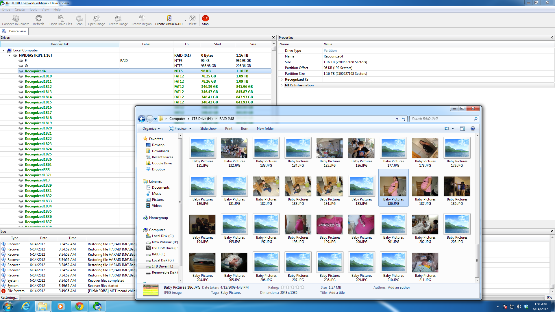

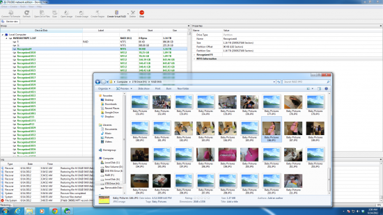

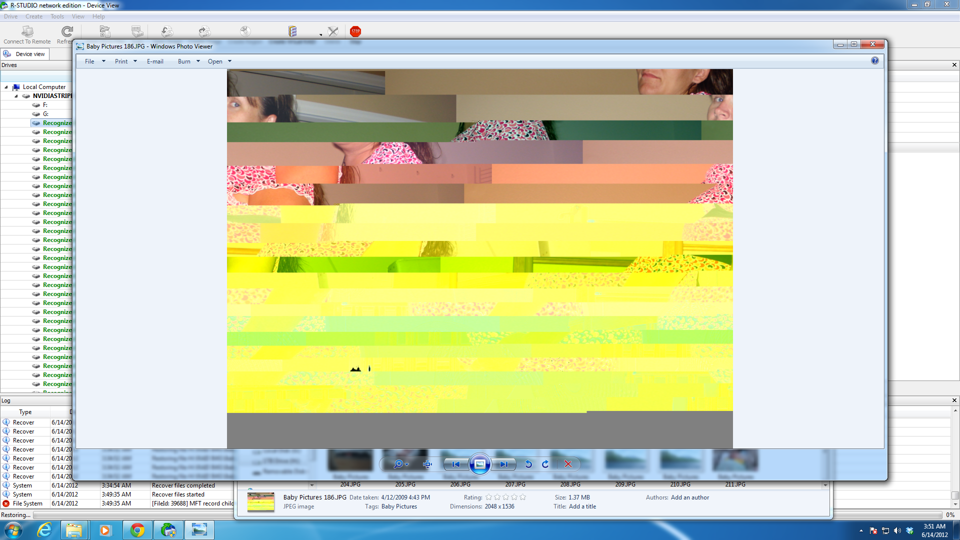

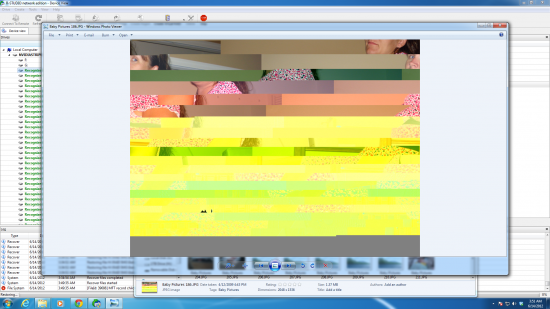

Hi. I am new to this board and have been reading for hours before registering and more hours after registering trying to find someone with a similar problem as to mine, this so far seems the closest. I do not have a HFS+ drive, I have 2 640 GB WD Caviar Black drives that were in a RAID0 array with 2 partitions. 1 986ish GB part and 1 205ish GB part. 205 Part had windows 7 on it, the rest was just storage. On a 3rd hard drive not part of the array I was running Windows XP Pro.
I was using BCEdit for multibooting, took the winxp out of the menu, rebooted and all was good, no menu, just booted into Win7 fine. I figured I was safe to format the 3rd IDE drive with xp on it. Boy was I wrong. NTLDR missing problems and the like endured. In my bios i deleted mbr on array and deleted array. Put Win7 on IDE drive and re did array in bios, used Hiren's Boot CD in windows and used DiskGenius to recover the partitions I had in the array, I have the 986GB partition back, but none of the files work and the 205 gig part would just show up as unallocated, so I formatted the unallocated back to NTFS just to get a drive letter to try and do some recovery with. I have been using R-studio to try and recover the data. out of the 7-800 gigs of data I can live without there is about 7 gigs of photos of my son from when he was born and when my wife was pregnant. I have attatched 2 files of what I am getting back as photo data.
I have some understanding of why the picture is the way it is, but I do not completely understand what to do with R-Studio to get it to recover the files correctly, what I am really looking for in the hex info and such. Please help me guys, I see Dr. Kiev is a RAID genius and recovery expert, any and all insight will be so helpful. Oh, also after I recovered the 986 gb part, chkdsk ran for AWHILE and did some MFT security id replacing and some other stuff. Am I just totally f**ked?

For the benefit of other readers, note that the post above from thederk has now got a thread of its own here:
raid0-ntfs-problem-please-help-reconstruct-t23238.html
Therefore I suggest not replying on this thread, especially since this thread involved HFS+ which is not part of thederk's configuration.
