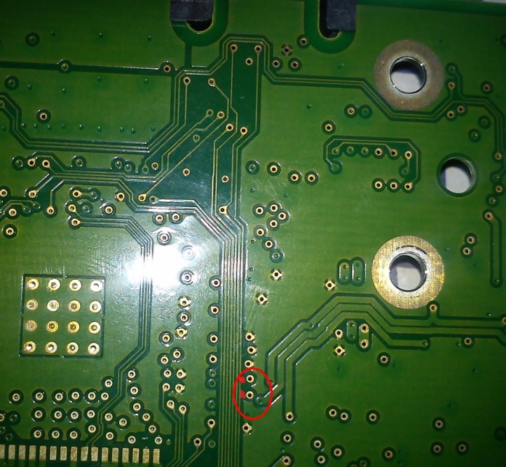

Hello, do you know which are the points to short in this pcb to unlock the terminal comunication?
^Z doesn't work, i don't get the F3 T level.
It shows this when i power on:
Boot 0x20M
Spin Up[0x000246DF][0x000246E4][0x00021889][0x000218A9][0x000218AA][0x000218AD]
[0x000218CA][0x000218E6][0x000218E9][0x000218E9]ZZZZMMMMMMMMMMMMMMMZZZZZZZZZZZZZ
ZZZZZZZZZZZZZZZZZZZZZZZMMMMMMMMMMMMMMMMMMMMMMMMMMMMMMMMMMMMddddddWYWYWMMMMMMSxxx
xZWZWZWZWZWZWZWZWBBWYWYdd

The drive is detected in bios after 10/15 seconds, but not in windows.
Neither in MHDD is detected (the screen remains black with a flashing white dash in the upper left corner of the screen).
I posted the terminal log above, hope some of you gurus can understand what's wrong.
Thanks :wink:
Drive specification:
ST1000DL002 Barracuda Green
F/W: CC3C
Date: 12353
Site: WU
No clicking sounds, i hear head calibration.
It doesn't spin down.
PCB contacts have been cleaned
 Post subject: Re: Barracuda Green PCB 100617465 shorting points
PostPosted: December 23rd, 2012, 22:37
Joined: August 25th, 2010, 23:50
Posts: 6
Location: china,wuhan
PostPosted: December 24th, 2012, 11:32
Banned User
Joined: December 6th, 2012, 14:49
Posts: 70
Location: Svenska
Thank you
