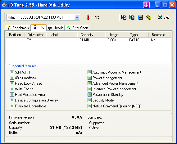

Hello, I have this Hitachi hard drive JC0930HX0TMZ2H with firmware A3MA that windows detects only have a capacity of 31 MB, instead of 1TB.
HD Tune shows me as a 31 MB capacity, and if I click on "Health" it doesn't show the smart status, it shows only a white screen.
Which is the problem?
Maybe the smart module in the firmware is corrupt?

Update BIOS on your motherboard and remove HPA from you drive

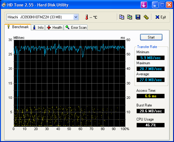

Is it just my impression that the reading speed of the drive is way too low?

Thank you very much, you were right the problem was the HPA.
I gave the nhpa command in mhdd, rebooted and the drive is seen again with full capacity. :D
I did the sector scan in mhdd, no bad sectors were found and the smart is ok.
The drive was into a multimedia box but the usb connector broke, so i pulled out and connected directly to the motherboard via sata.
The motherboard is a Gigabyte brand, i don't know why the motherboard did the HPA stuff, surely i didn't.
Am afraid to connect external drives into this motherboard, what can i do to turn off the HPA of this Gigabyte M.B.?

I guess you had the drive attached via USB, to cause the slow throughput seen on the HDTune benchmark picture you supplied. If it was attached via SATA then, as northwind said, the throughput was unusually slow.
