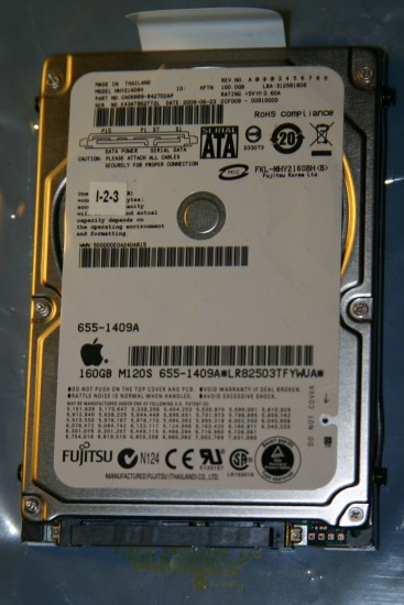

Was hoping to find some help on the HDDGURU Forum.
A friend of mine asked me to try and recover data/pictures (not extremely critical) from a damaged hard drive (photo of drive label attached to thread, click photo to enlarge/read).
I connected the drive to my Window 7 Pro 64 PC using a sata/power cable from the mother board to see if it would recognize the drive (it did not).
I downloaded the Fujitsu/Toshiba Windows Diagnostic Tool Ver. 1.12 (For IDE/ATA/SATA Hard Drives) from here:
http://storage.toshiba.com/storage-serv ... -utilities
Upon running the utility the drive was recognized. I proceeded to run and Extended Test and received the following Error:
Model Name : FUJITSU MHY2160BH
Serial No. : K43AT862TT2L
Firmware : 0081000D
Total LBA : 12A19EB0 h
Test Name : Extended Test
Result : FAIL
Code : B129Y6
Test Time : 11:45:57, January 07, 2013
The drive did not pass the Extended Test.
An error was detected on the target drive.
Any assistance in recovering the files would be appreciated.
Thanks,
Mike
File comment: Fujistu MHY2160BH
 Post subject: Re: Fujitsu (Apple) 160GB SATA Drive MHY2160BH
PostPosted: January 17th, 2013, 4:36
Posts: 3551
Two options:
a) Do not power up the drive anymore and consult a pro to recover the data. At THIS point, and without further tinkering, it shouldn't cost an arm and a leg. This is the safest option, assuming data is important.
b) Do it yourself, accepting the risk that in case something goes wrong, data could be lost forever or recovery would cost x times more (if it is still possible to recover). Since this is not your data, but someone elses, I suggest you ask them to call the shots. If your friend accepts the risk of DIY, then search this forum for ddrescue and follow instructions. You need to image the drive using some non-windows utility (ie. ddrescue or similar, you will find a lot of similar threads) that has the ability to handle imaging of a sick drive, and then recover the data from the image.
There is always a big chance that plan b) will fail. Then you go to plan a), but then things may have gotten worse.
Good luck.
PostPosted: January 18th, 2013, 4:30
Posts: 3551
A) Contact datasaversllc.com there is an online price evaluation so that answers your other question as well.
B) Well if your friend agrees and understands that he/she may lose their data for ever, then you're good to go.
Good luck :-)
