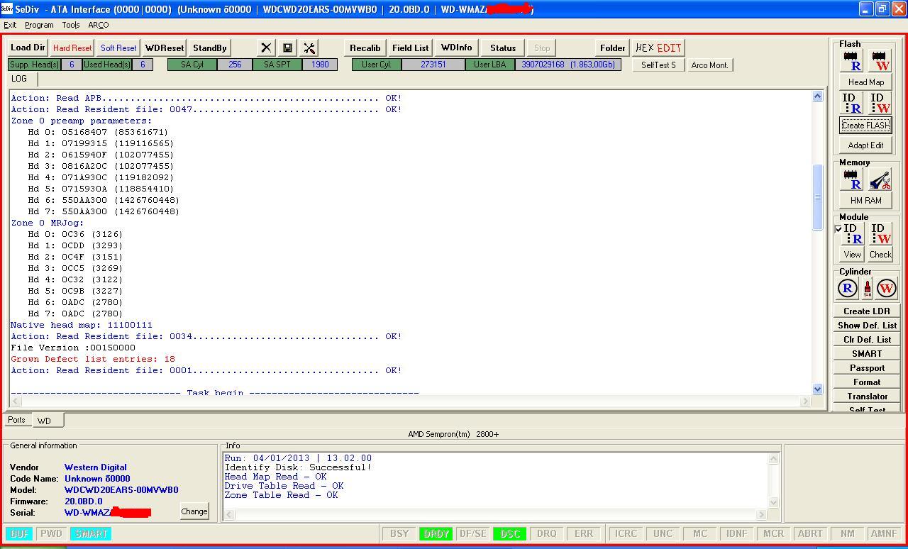

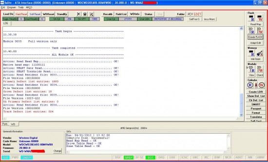

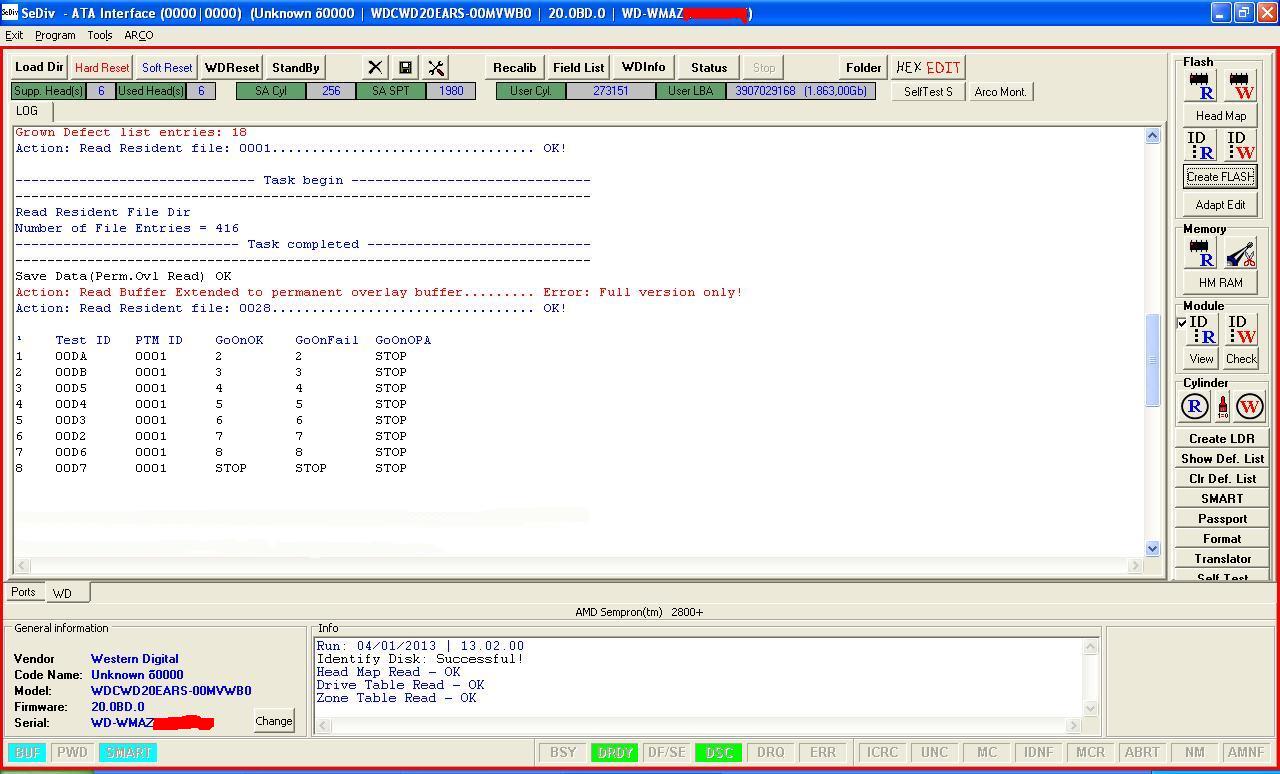

Hello, i've this WDC WD20EARS-00MVWB0 which gets detected in bios but doesn't boot in windows nor in MHDD.
The drive does not do any clicking sounds and motor keeps spinning.
When i try to load it in MHDD it hangs in the first black screen so i can't test it, the only way i was able to do some test was in Sediv (connecting the sata cable after windows loads on the primary drive).
I don't know what's wrong, maybe you can help me, here i post more informations:
Model: WDC WD20EARS-00MVWB0
FW: 20.0BD.0
WWN: 50014EE600C111F7
Date: 14 dec 2010
DCM: HBRNNTJMB
DCX: 4M09V34W6
Product of Malaysia

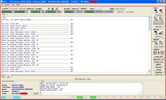

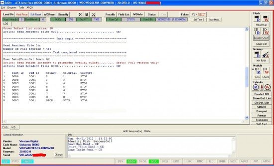

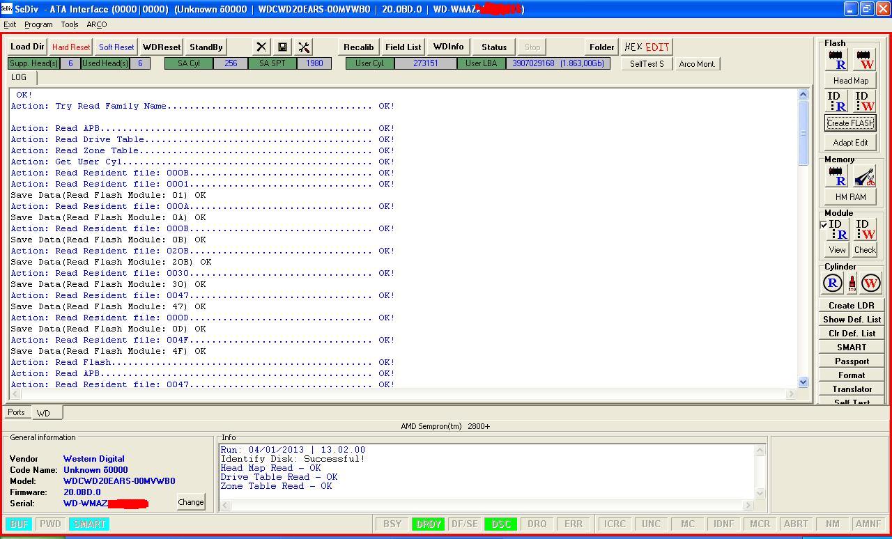

Here are Sediv logs:
File comment: Sediv log1
File comment: Sediv log2
File comment: SeDiv log3
File comment: SeDiv log4

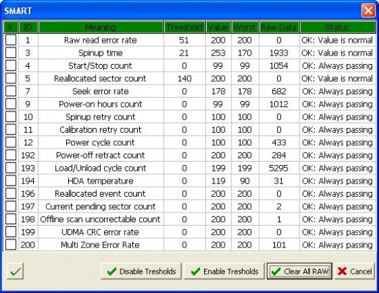

File comment: SMART

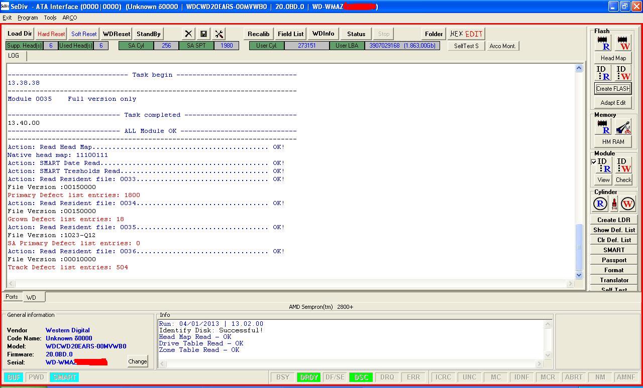

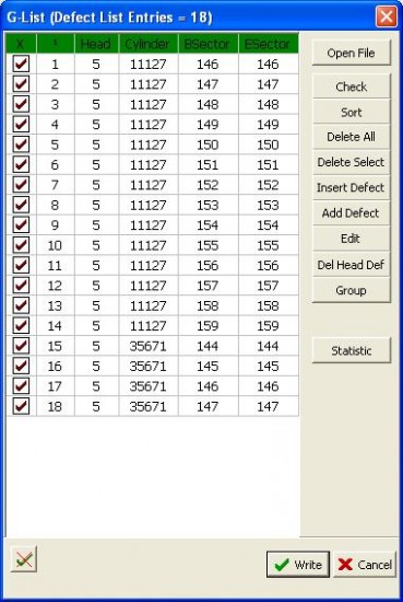

File comment: G-List

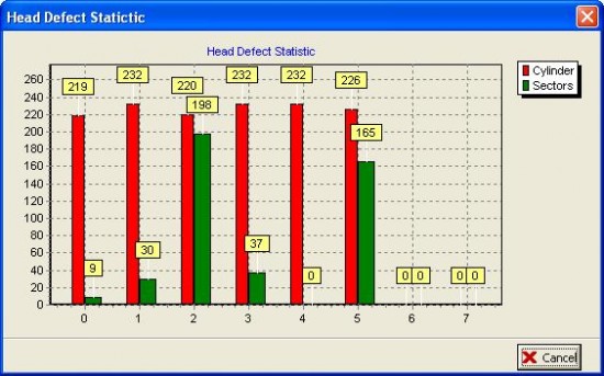

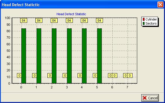

File comment: P-List Defect Statistic

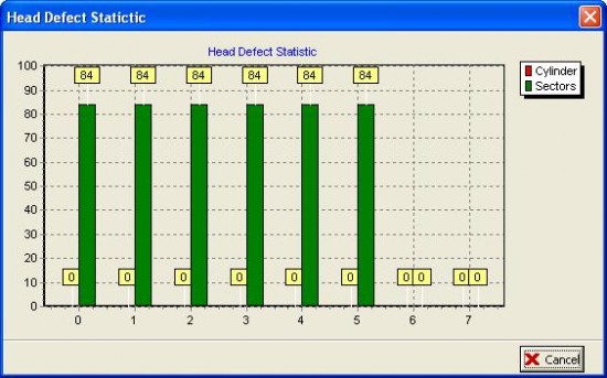

File comment: T-List Defect Statistic

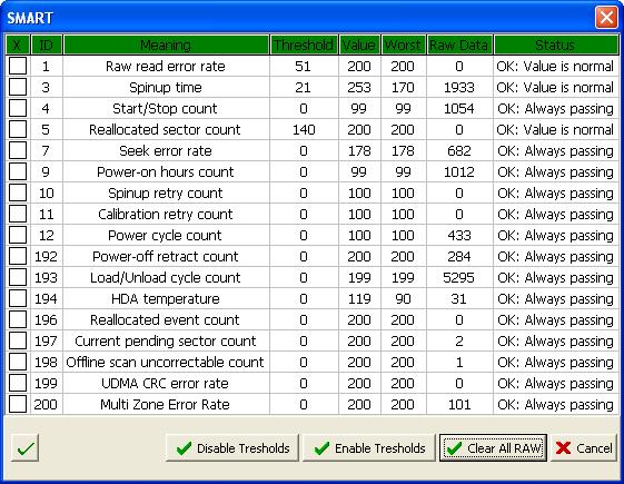

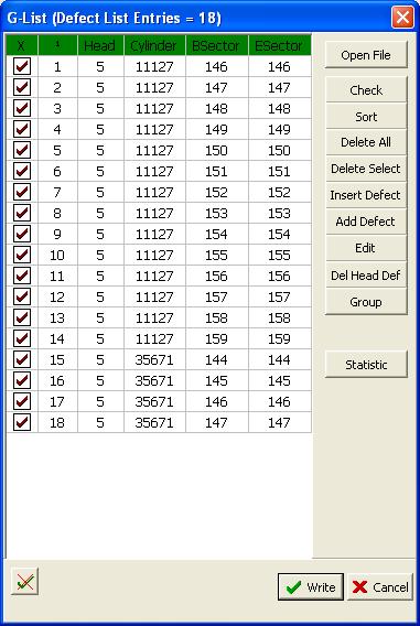

Thank u all but as i said, the drive doesn't load with any software, neither with DOS software as MHDD, DMDE, Mediatools, this means that i can't do a clone.
The only sw which loads the drive is sediv because it loads the drive in safe mode, which doesn't access to user data but only into the firmware area.
The smart log tells that there are not any reallocated sectors (only 2 pending), but G-list has 18 entrys, i don't know why but maybe it's this the issue.
Waiting some more opinions by gurus about this...

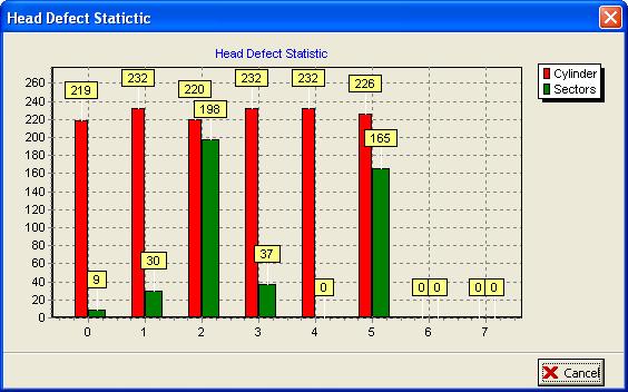

 Post subject: Re: WDCWD20EARS-00MVWB0 BIOS detect but no boot
PostPosted: January 5th, 2013, 7:13

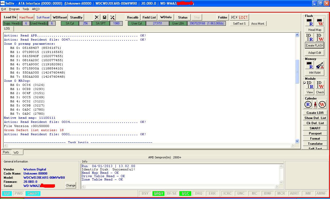

Quite possibly a bad head in there, preventing translator initialising properly.
Not DIY

Yess, surely heads because now they are getting noisy.
I turned off and i will not turn on again!!!!

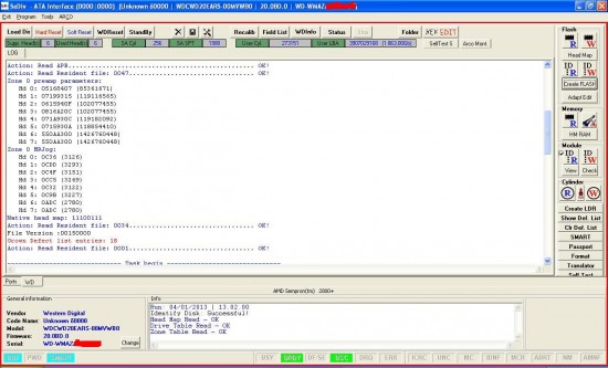

I want to ask you gurus if you understood that the problem was heads by reading the Zone 0 preamp parameters?
In the 4th log i posted, it says:
Action: Read Head map..................OK!
