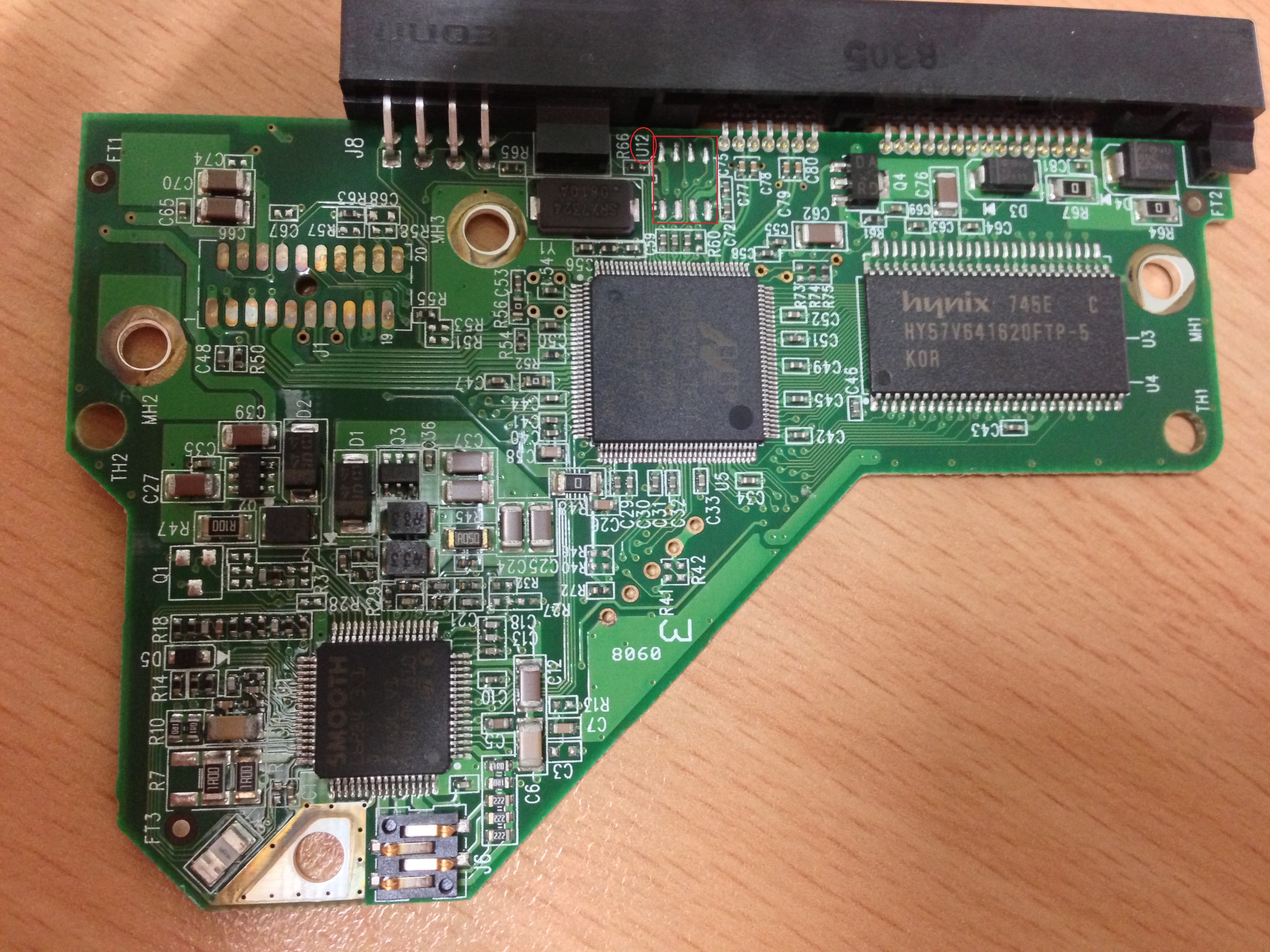

I have a WD HDD of which suddenly died, no power! I have a similar WD HDD but has a different sticker ID of AB instead of AC as it was made in JAN.. and with this PCB the HDD spins just fine so I've eleminated it down to the PCB at fault, but windows will not initialise it as it's the wrong versions? :?
Now I have found a PCB suitable for mine below which has the same MDL, PCB Sticker and PCB serial/versions. Do I need to do anything special to get this drive to detect my data or do I need to swap ROMS? If so which is it on the PCB? :D

ROM is usually located at U12 on the PCB unless it's embedded in the MCU, then you will need professional help on this...
Post a picture, and I'm sure someone will point you in the right direction...

Ok located U12 on the attached photo and there is a blank spot with 4 pins on each side missing... guess it's embedded in the MCU? Where is the MCU on the attached photo?

 Post subject: Re: Question/Issue with WD GreePower!
PostPosted: January 7th, 2013, 12:55
Posts: 285
Rom is embedded in the large Marvell chip
Hey mate, D3 & D4 is reading 0.6 ohm...
May be you are not checking correctly.
0.6 Ohm is as good as 0 ohm== Short TVS.
Check in the resistance range of the multimeter,( not the diode range)
But , usually , Both the TVS dont fail together.
Also if the TVS diodes have failed , it wont allow your CPU to power on.
As suggested by Touchclarity, this is not a DIY case.
If data is really important, take pro help.
VCM controller may be faulty, but proper diagnosis is necessary ,rather than guess work

After testing the Diode again D3/D4, I found that D4 was shot! I desoldered the offending diode and reinstalled the PCB back into the main HDD unit and sure enough the HDD powered back up and was able to copy all my data back onto a spare HDD.
I do thank everyone's input, but if you do feel confident in doing it yourself by all means give it a go, after all experts have to start somewhere ;). If you don't feel like going further in your diagnosis then by all means consult a specialist. Again this TVS would not necessarily have fixed this fault but like a few posts have said, "It's a simple thing to try", do one diagnosis at a time (IF YOU FEEL CONFIDENT).
