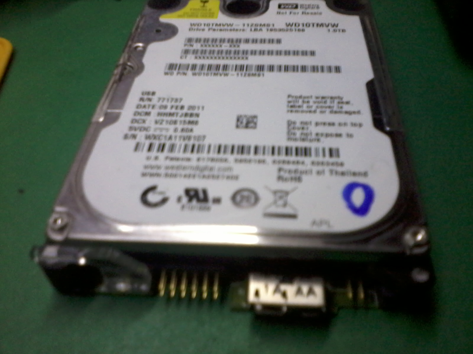

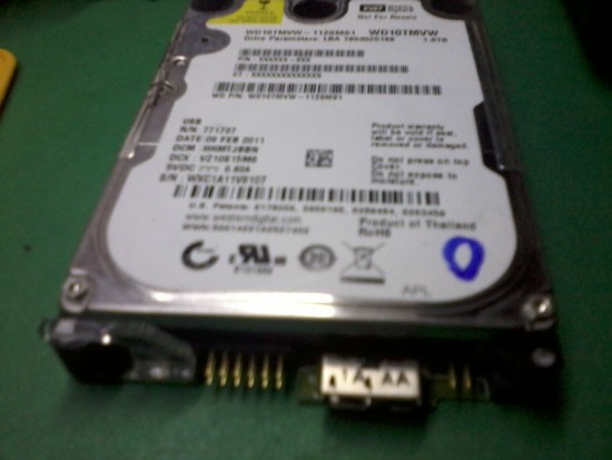

its the drive port.

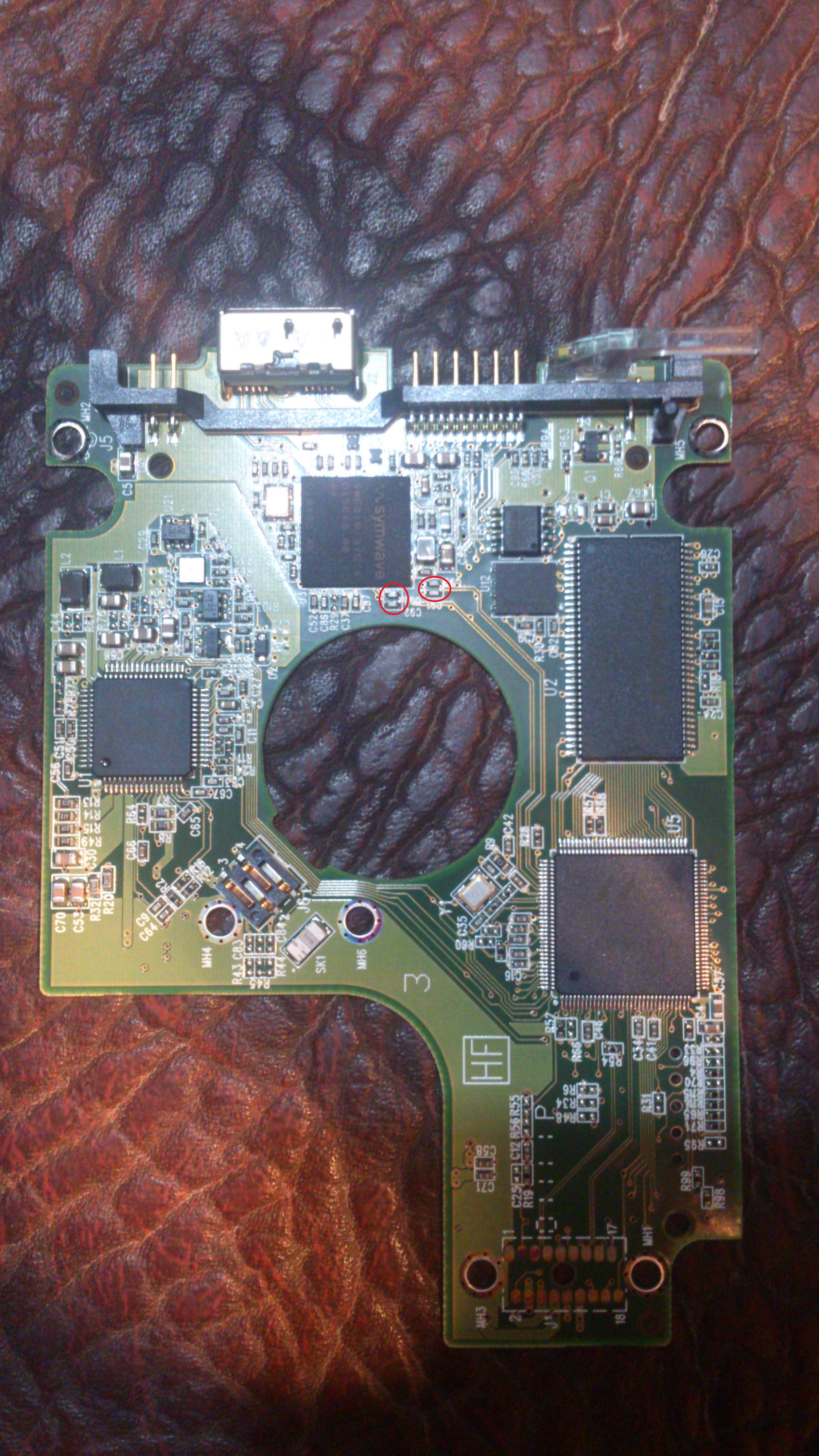

Firstly you would need to unscrew the PCB from the drive & then take hi quality photos of both sides of the PCB.
Then upload the pictures here so we can see.
Will probably need to remove the C90, C91, C92, C93 components then solder wires to the test points (these will be the tx rx etc) on the other side of the pcb. Then you will need to solder a sata connector to the correct tx+, tx-, rx+, rx- + you will need an earth & 5v power. A bit of research, time & a multimeter you can work out the connections.

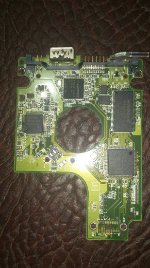

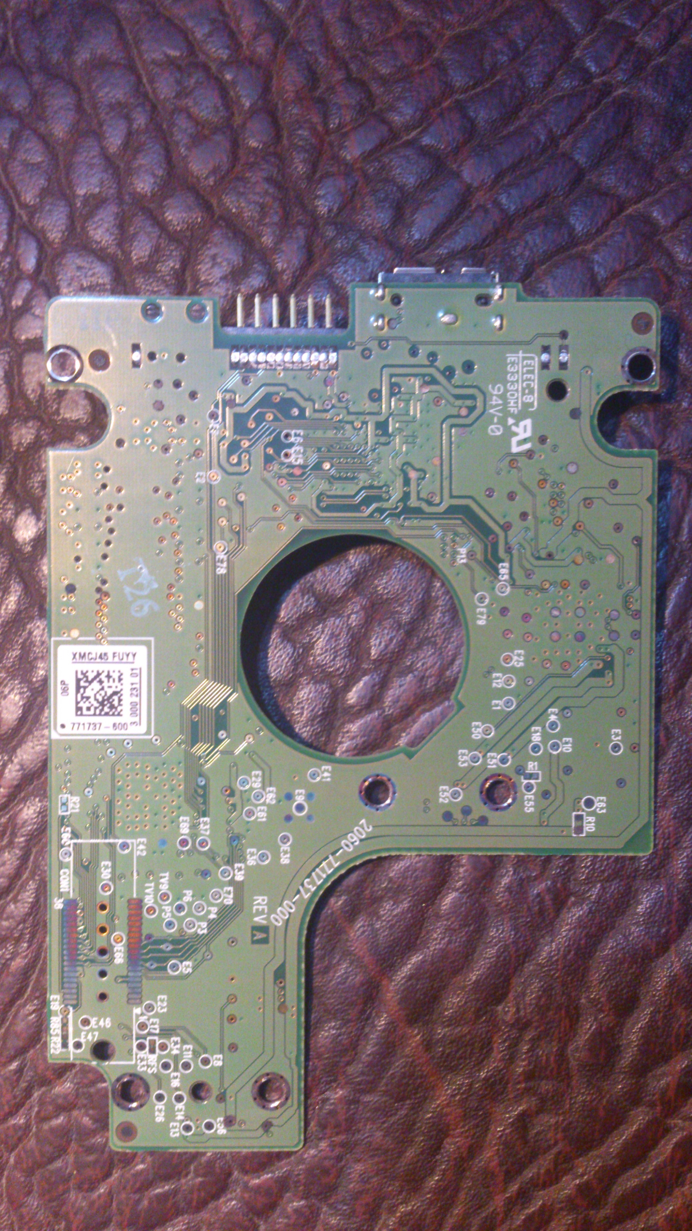

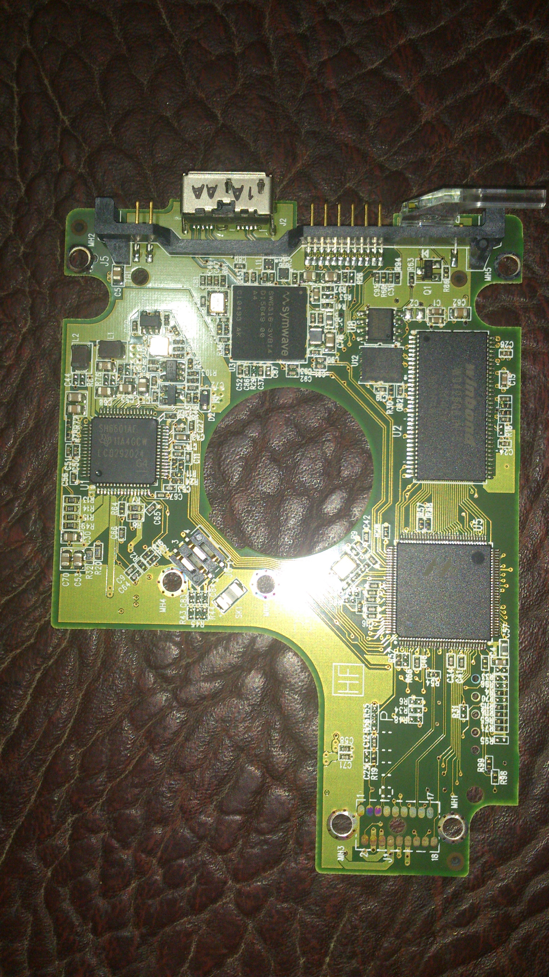

 Post subject: Re: WD Passport spins 1TB, 3.0 - Spins but NO detection.
PostPosted: January 7th, 2013, 6:13
Joined: May 19th, 2010, 13:31
Posts: 78

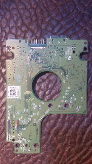

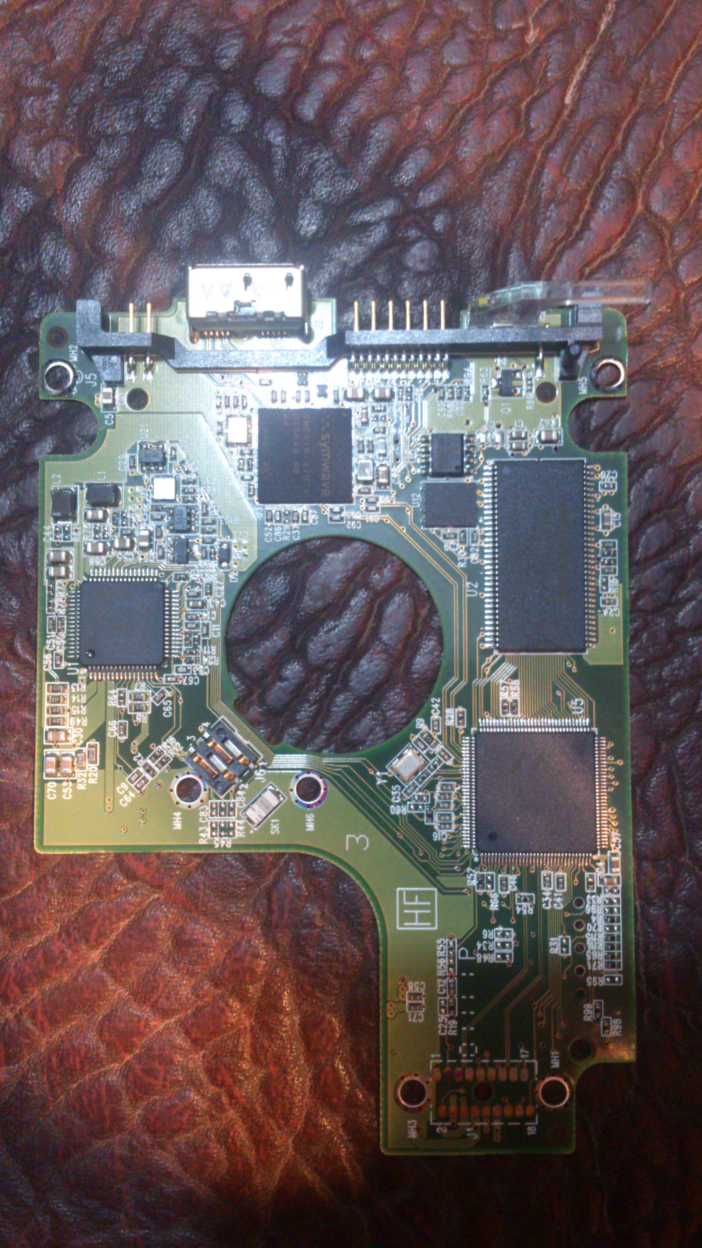

Got it. here are the PCB pics.
PostPosted: January 7th, 2013, 6:15
Posts: 78
one more pic..
PostPosted: January 7th, 2013, 16:38
Joined: May 3rd, 2011, 9:52
Posts: 177
Location: France

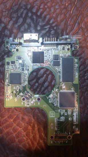

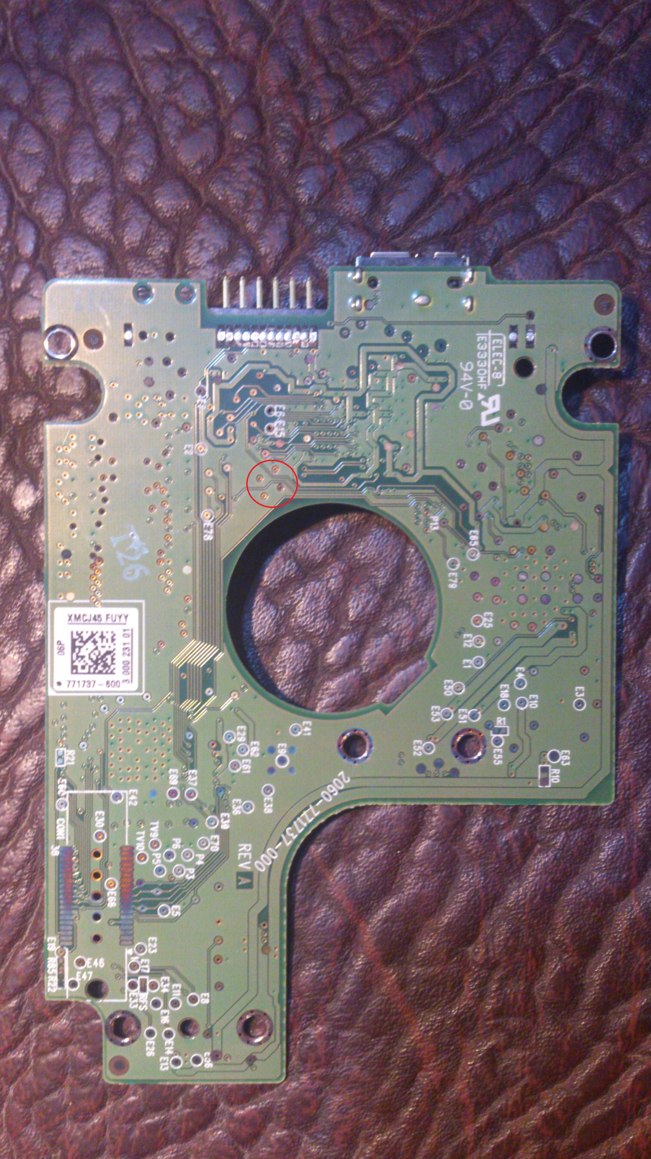

As said by loki remove the capicitors et connect to sata...
(At your own risk)
File comment: connect
File comment: remove
PostPosted: January 9th, 2013, 6:30
Joined: July 7th, 2010, 4:45
Posts: 924
To find out which are the tx+, tx-, rx+, rx- you need to know the pinout for the usb3 micro-b (hence the R&D) http://pinoutsguide.com/PortableDevices ... nout.shtml
Basically you would need to cut a usb3 micro-b cable in half to get access to the wires.
Plug the cable in to the usb pcb & then use a multi meter & do a continuity test to work out which it tx+ etc.
