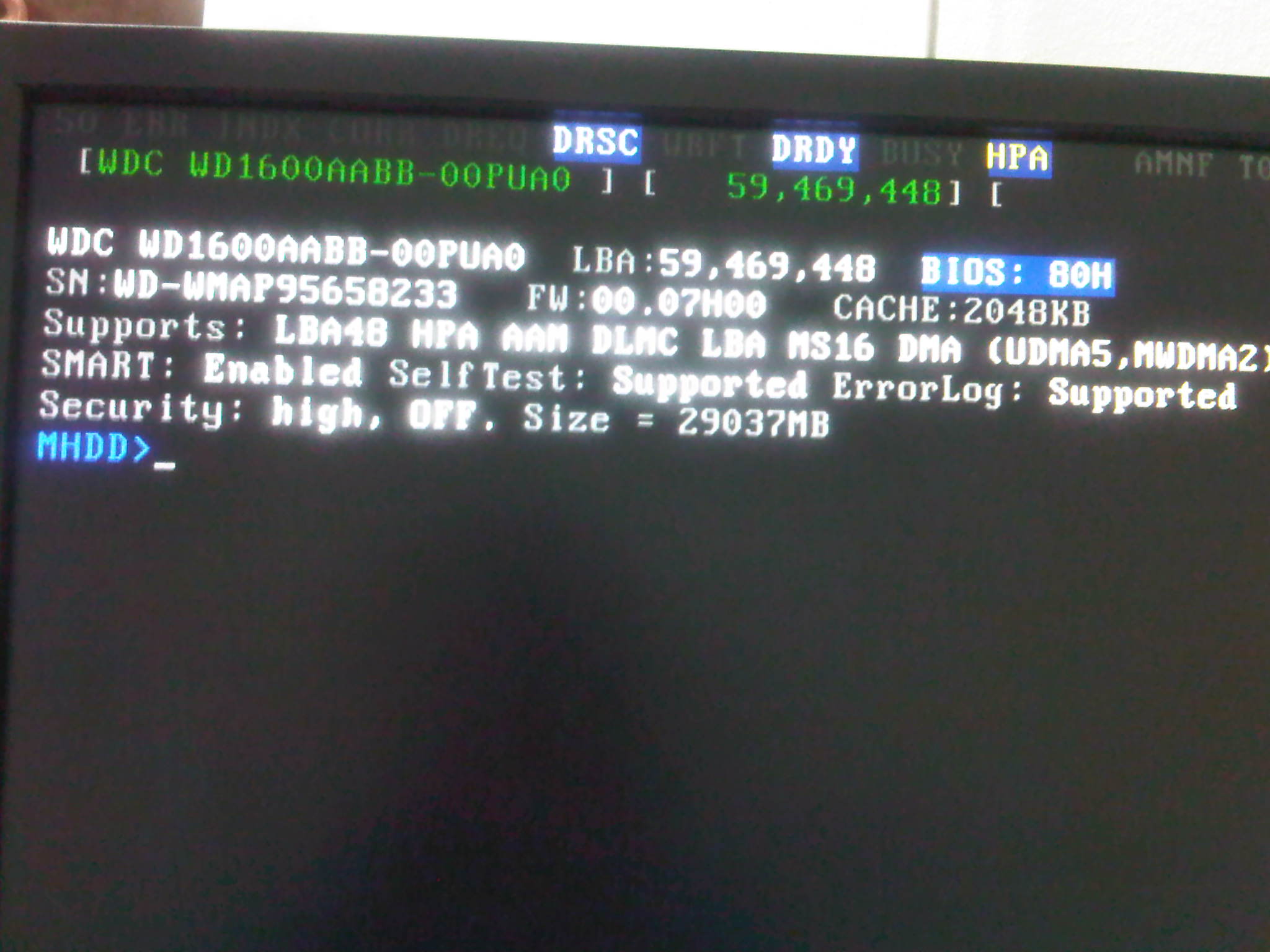

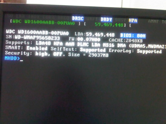

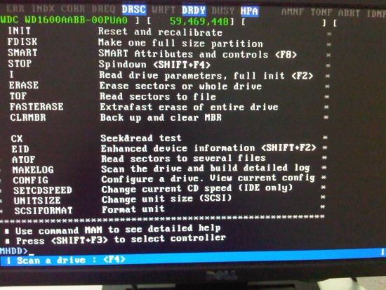

ok sorry for the delay this is what i got from the MHDD and the HD, it seems MHDD sees 60gb but still im short, hmmm

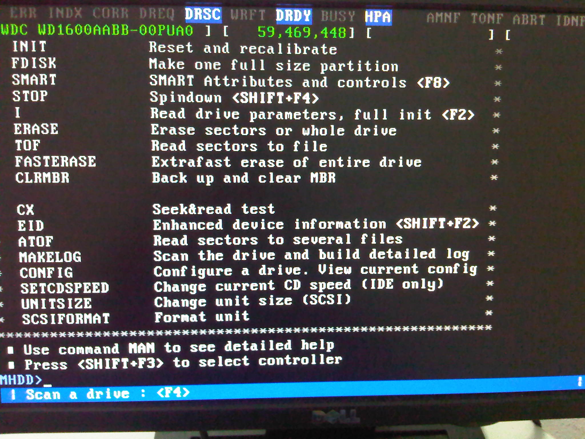

Have you tried NHPA from within MHDD?

ohhh nice now i have LBA 312,581,808, let me check in the bios now how much does the pc can see.
Ok now the BIOS can see 137GB, i will clone the HD now, thanks i will keep posted.
Good, so that has removed the HPA and as far as the drive is concerned, all 160GB is now addressable - but...
... so the BIOS has the old 28-bit addressing limit.
Be careful - some cloning software will be affected by the BIOS limitations in that PC. Ensure that whatever cloning software you choose can recognise and clone all 160GB.

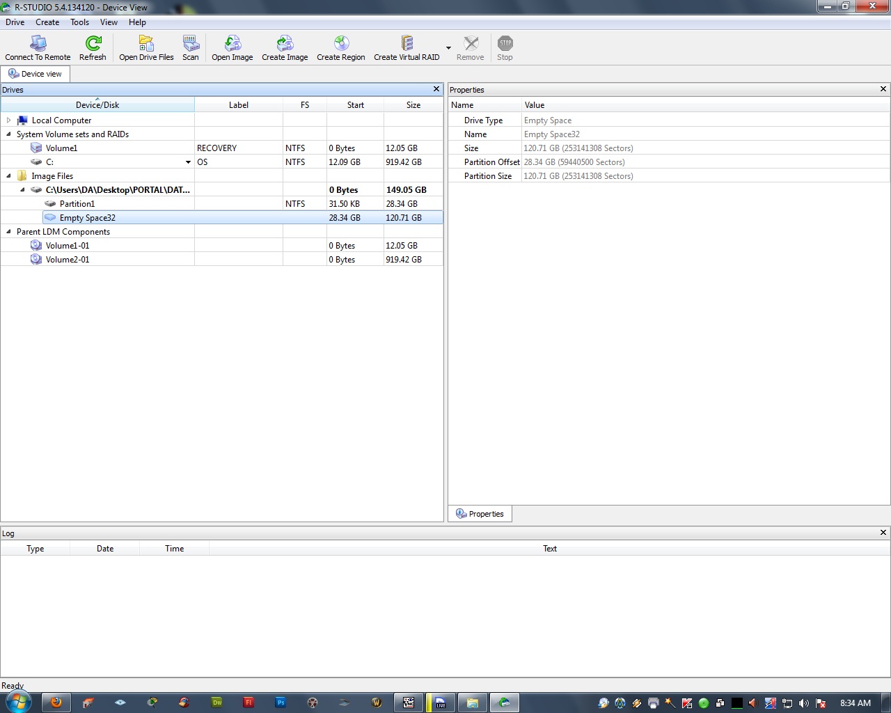

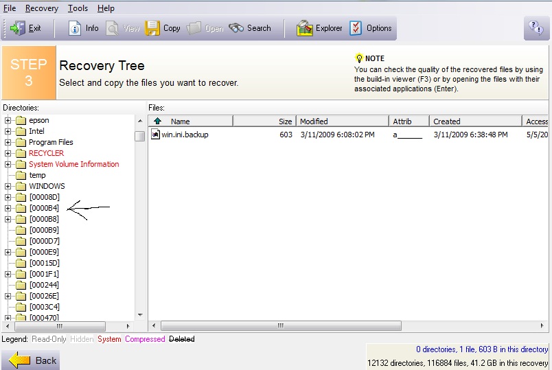

Ok guys keeping you posted, i was able to make the image not a clone 160,041,885,696 bytes this is how much i see in the file on windows, now im using R-Studio to find the docs any pics any excel sheets, weird thing is in the user folder they are blank, is so weird.
I see a lot of folders but no folders with docs, or pics, and i know he had docs in this drive :shock:
Maybe im missing something of the drive is not full on size yet.

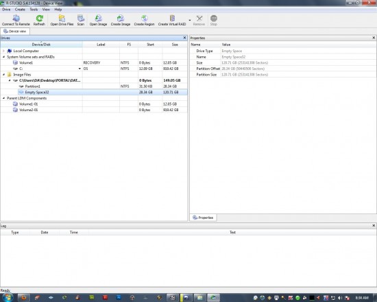

Oh OK hmm i have an empty space, all the data must be there, funny thing is when i use find and mount i get like 70g more on another partition but still i don't have the complete data. this is getting cooler and weird every time.

Oh i think i found something, still searching...

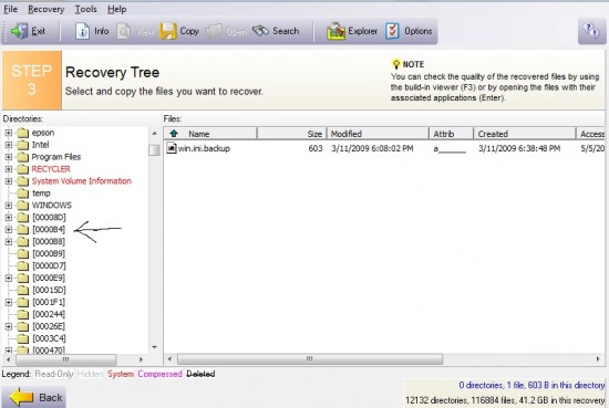

Ok one thing why the weird name on those folders?

From what I see, whoever installed the drive into the client's system cut it down to 32GB, likely because the system was old and wouldn't access anything larger. The drive was partitioned and formatted that size and anything beyond the 32GB mark is likely data from a previous owner.
I don't see any reason to believe that the drive suddenly did this on its own, coincidentally re-sizing the partition to size to match.
Are you sure that you don't have everything from in the 32GB NTFS partition?
